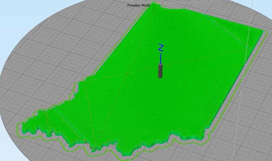

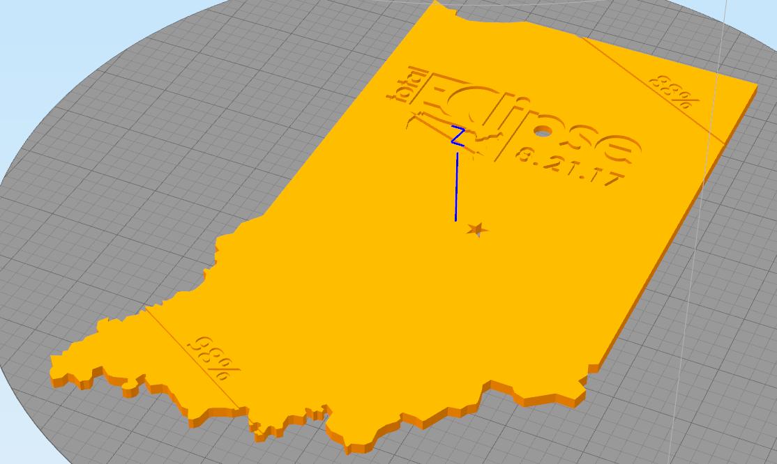

I noticed after upgrading my simplify3d to 4.0 that now I'm missing details in my prints. Looks like simplify3d is simplifying or thinks my print width is to small for the details when it used to print them before. What setting would affect this. Std .40 nozzle on this printer.

You need to disable "merge all outlines into a single solid model" on the Advanced tab
