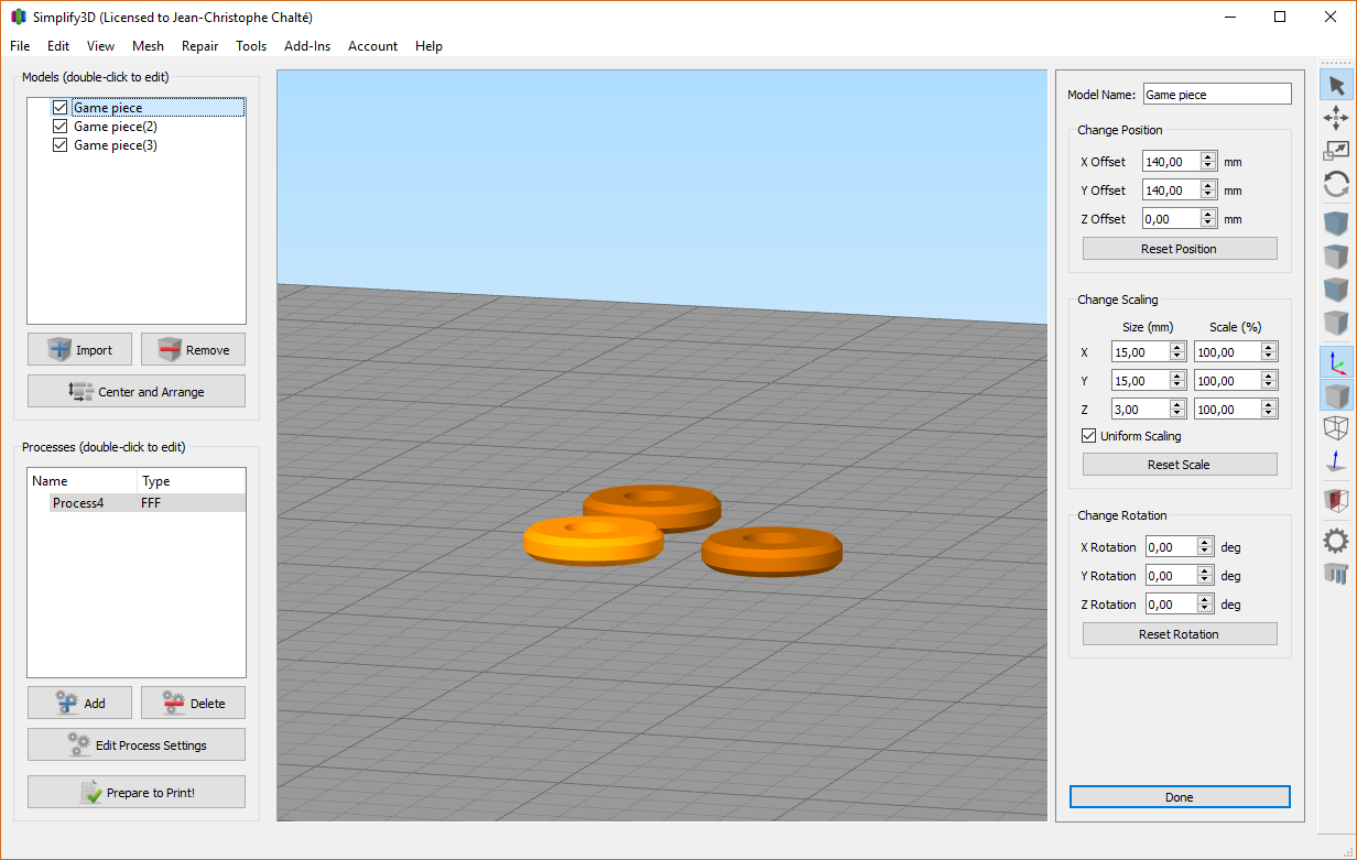

Have you found the source of your issue ? I am having the same issue with my Tevo Tornado with multiples models. It is not a first layer issue. The first 4 layers are not printed at all, as if the print was started on the 5th one, and only one bottom layer is printed instead of the 3 setup in S3D. Models are well placed in the software, with a simple flat surface "center and arranged". See the attached picture. I suspect that there is a software configuration on the printer, but I don't know what to look for :(
