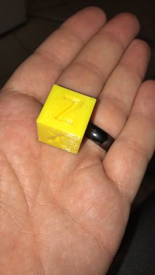

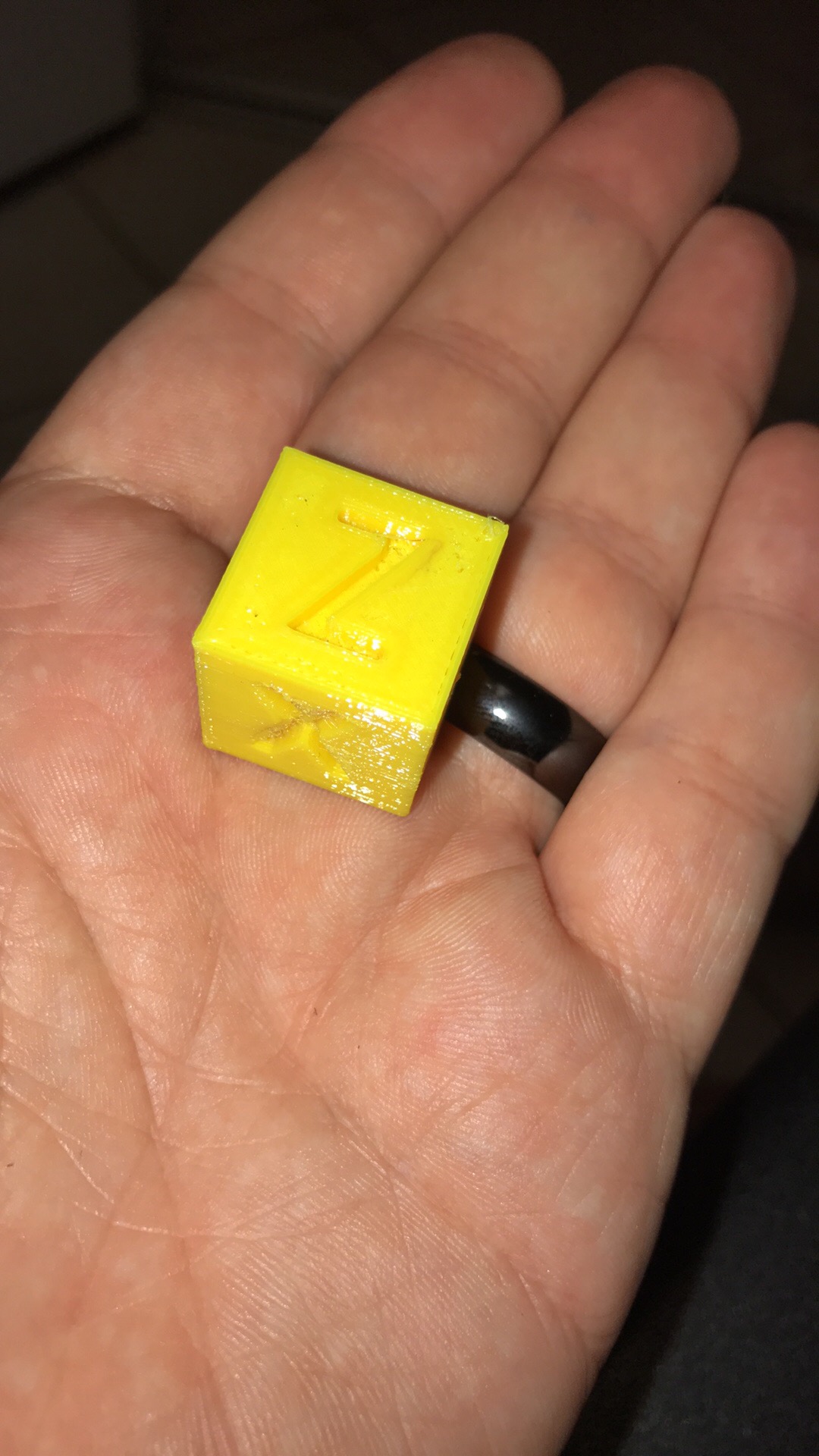

Then, I learned a bit about the retraction settings and print speed, and thought I was making progress. I got a decent looking calibration cube.

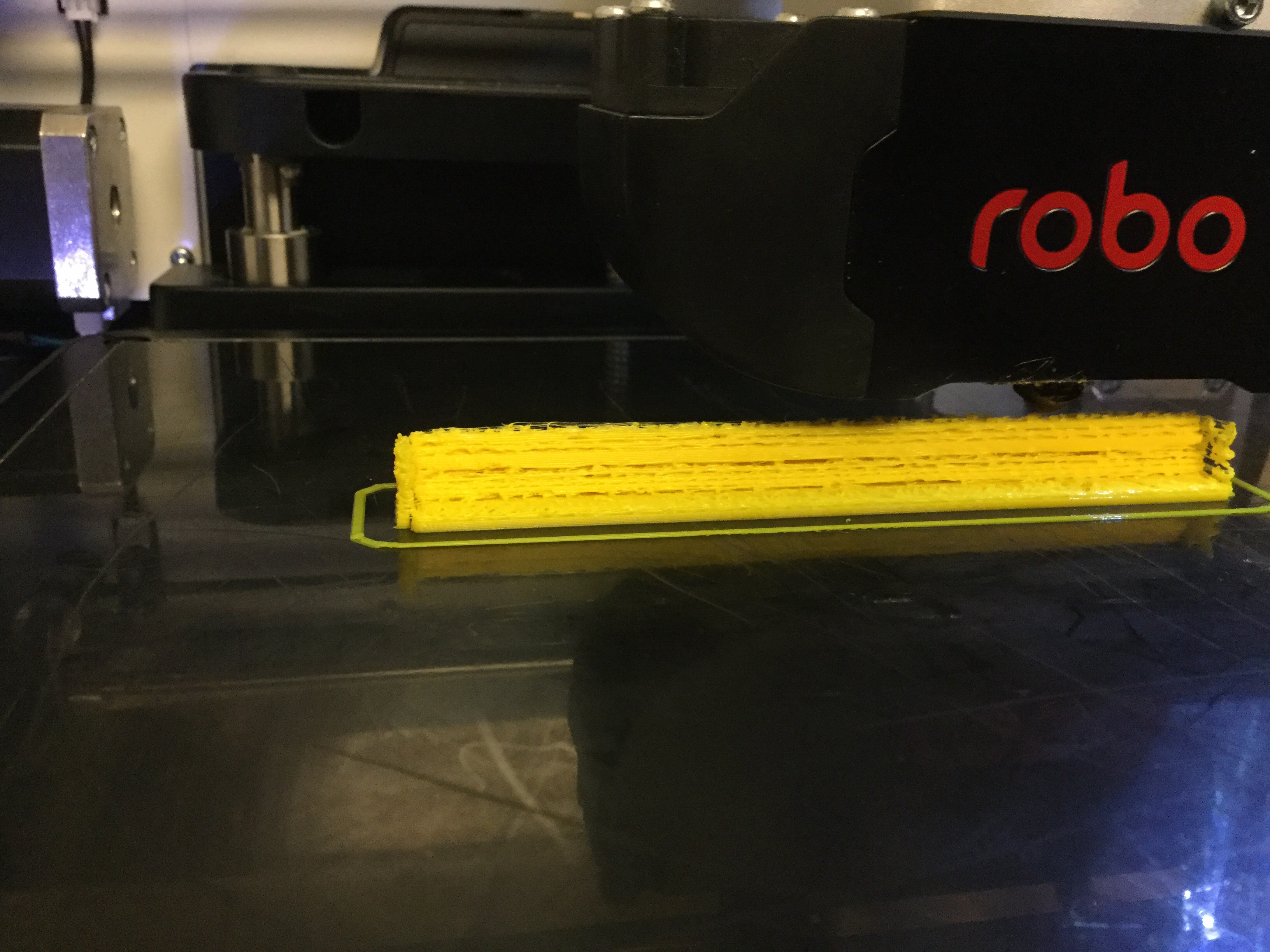

What is odd is that you can see, part of the print is ok, and then it seems that the extruder just starts to go on the blink.

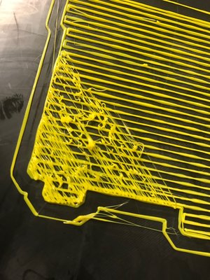

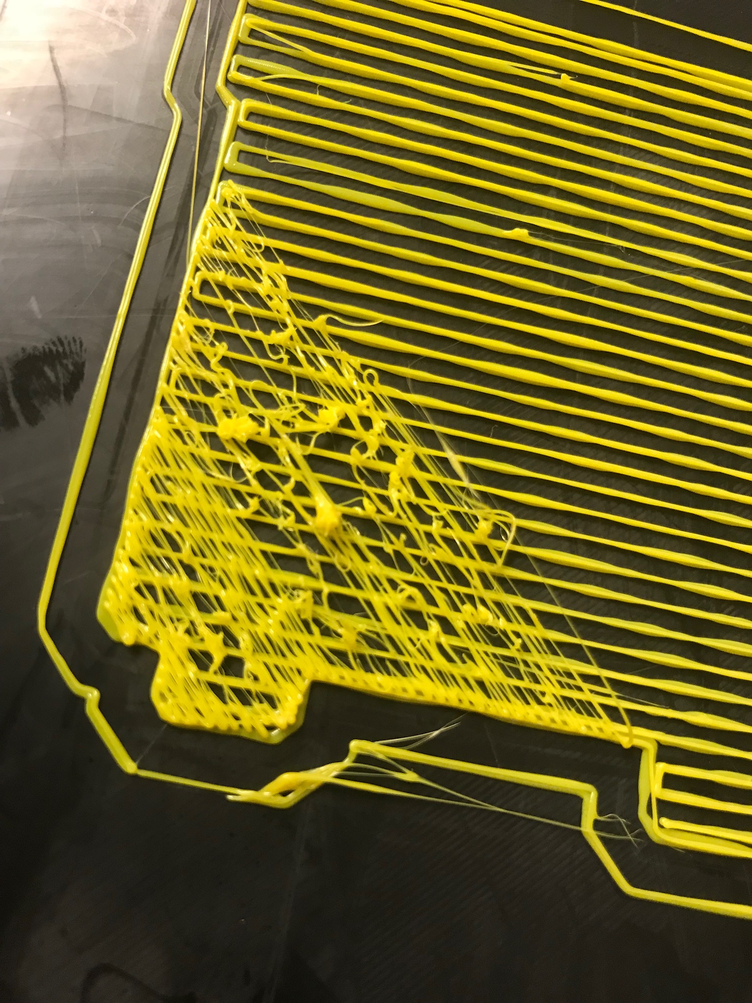

Third photo (better illustrates the issue):
Again, this issue doesn’t occur on the base of the unit, but only when it starts to print a very narrow, sloped, long shape.

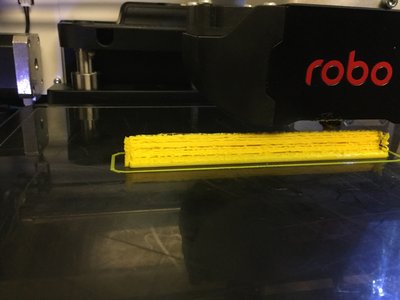

Here is another photo - looks like underextrusion , but why would the lower 4 to 5 layers print okay? I believe all of the speeds are the same, as are the support speed multipliers
