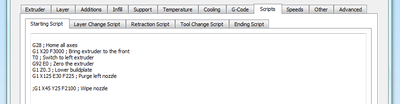

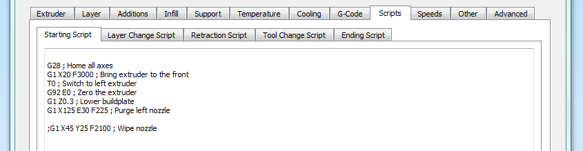

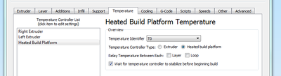

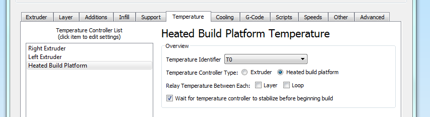

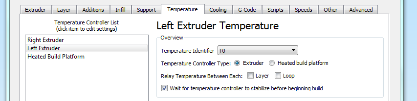

T0 or T1 has no influence to the heatbed, why ever S3D shows it like an extruder. You must only check on the alternative box in the line Controller Type. The line temperature Identifier (T0 - T5) is only available to extruders.
Be sure, that the temperature for at the moment not used extruders is set to zero AND the box Wait ... is unchecked!
The GCode examble is generated with this settings as shown.

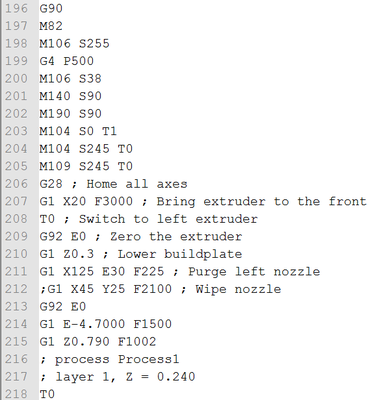

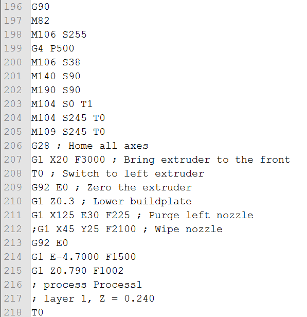

... only 3 pics possible, here the gcode
I know, it is not optimal but running :mrgreen:
