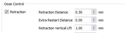

exxosuk
Posts: 16
Joined: Thu Sep 23, 2021 9:16 am
Re: Z-lift for moves passing over objects
OK so this seems to work.
Retract and vertical lift only happens when moving more than 3mm from point to point.
The 3mm move may want increasing , depending on the size of your object,
