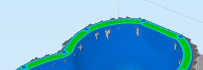

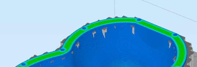

I have supports on the outside of this part but they are bleeding through to the inside. I have 1.8mm of inflation so the supports will actually be under the complete areas I need (another issue). If I reduce the inflation the ionside cleans up but then the supports do not cover half the area they are needed at on the outside. I am not able to attache the factory since it is a customers property. I'll do my best to answer any questions. Thanks.
Flashforge Creator Pro PLA
Support settings -
infill 20
inflation 1.8
dense layers 4
dense infill 70
