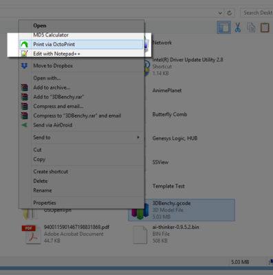

Is there any ability or feature request that currently exists, that will address the issue of being able to send directly to octo print or some other default file system (network or other wise) location?
Edit: Nvmd, I wrote code and solved my problem. Now I can Right click "Print via OctoPrint"
Print with OctoPrint
