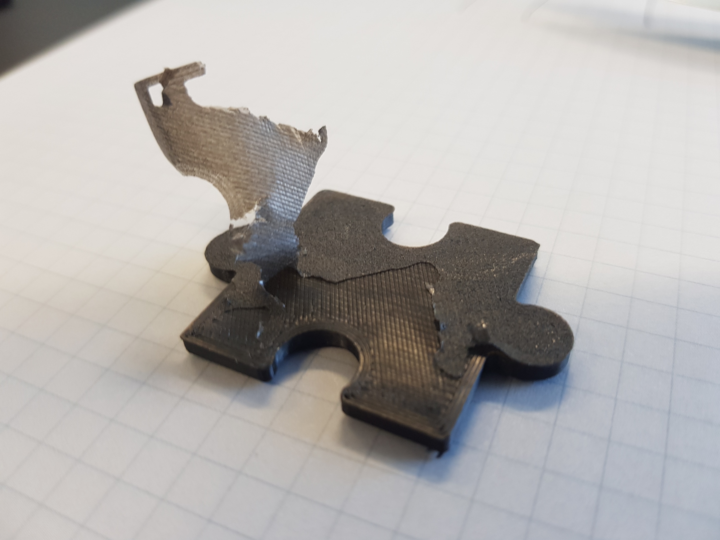

I have a pretty similar Problem with my black PET Filament (ICE Filaments). Other coloured PET Filaments are not so bad but I have the same Problems there too.
Sometimes after the print you can peel of the 1st layer because the 2nd one isn't bonding to it correctly.
My Settings are:
  • Extruder temperature: 220°C (Filament range 195-220°C)
  • Bed temperature: 60°C
  • Printing Speed: 30 mm/s
  • 1st layer Speed: 33%
  • Outline Speed: 50%
  • Infill Speed: 75%
  • Layer height: 0,15 mm
  • 1st layer height: 100%
  • 1st layer width: 120%
  • printing on platform sticker (no Problems with adhesion of the 1st layer to the sticker!)
Do you have any suggestions what Parameter to Change to get rid of this Problem?
