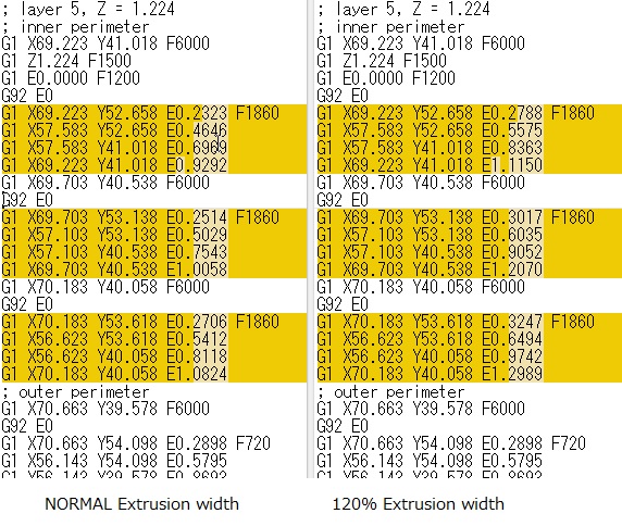

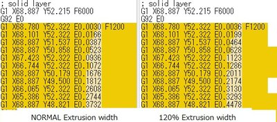

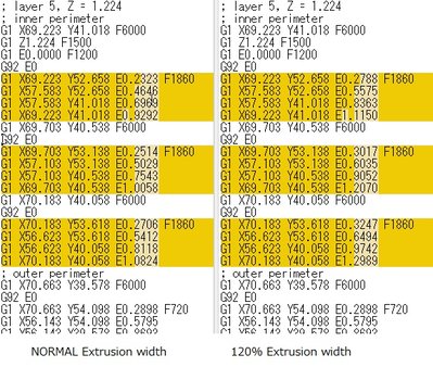

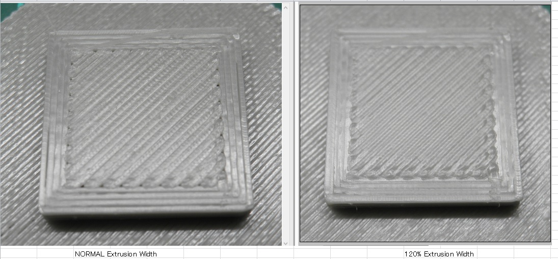

I made a program to convert the GCODE file and printed it.
The conversion target is InnerPerimeter and SolidLayer.
Left: Normal extrusion width
Right: 120% extrusion width

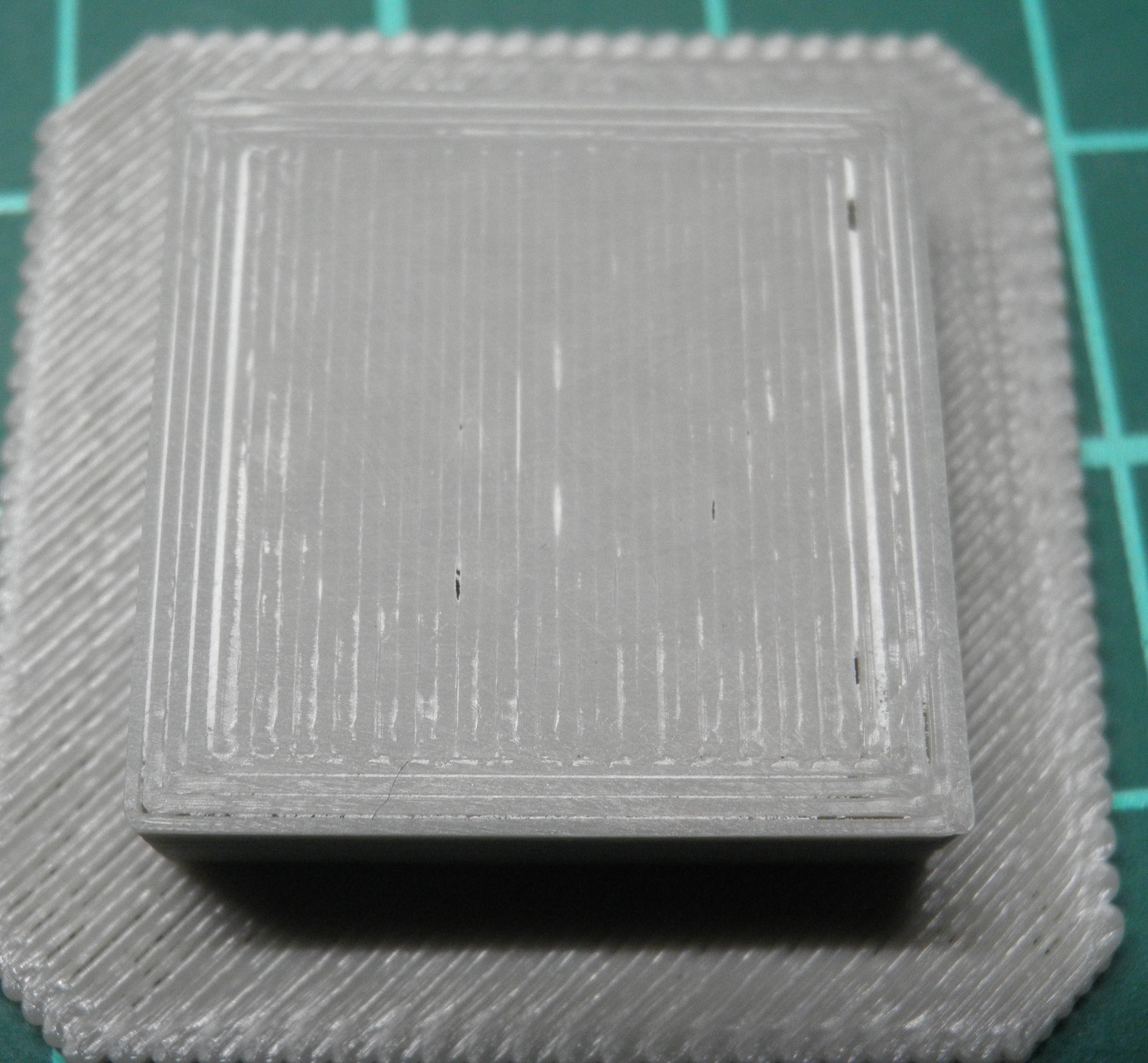

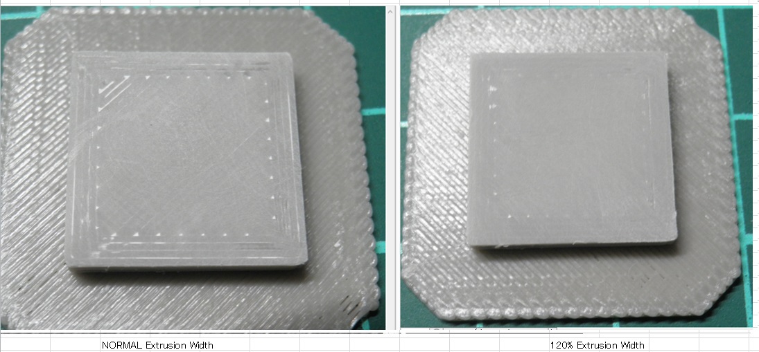

After polishing with sandpaper
The white part is a state in which garbage is clogged in a small groove.
Because the extrusion width was made large on the right side, the groove almost disappeared.
As shown in the picture below, many grooves may occur.
Filling these grooves with putty is very troublesome.
If we can increase the extrusion width of InnerPerimeter and SolidLayer, small grooves do not occur.
Processing of surface treatment is very easy, so we can reduce work inability.
※It does not convert InnerPerimeter and SolidLayer of the lowest aspect.This is to make rafts easy to peel off.
