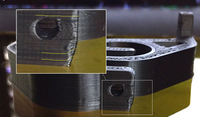

Vertical curling on first 20 layers or so
Hi. My printer overall is working great but I am getting some bad quality on the outline for the first 20-30 layers then it seems to be perfect. Printing ABS with heated bed (110degC) and fully enclosed printer. It happens on all parts. I've been printing parts 30 layers off the bed using supports and the supports takes the brunt and the parts are great but I would like to be able to print without supports.
See pic. I traced a few sample layers as yellow lines. It seems like the edges curl up vertically and that likely means less plastic gets deposited and this it ends up shrinking. I tried 35% and 50% underspeed on perimeter layers. (pic shows 35%)
One thing to note, my extrusion head is water cooled so I have no fans on the head. My nozzle temps and heat break perform awesome with the water cooling but maybe I need fan cooling on the workpiece?
Any suggestions?
More details:
* Using IC3D filament.
* 221degC extruder temp. Also tried 230 and quality overall is worse. Arrived at 221 by printing temp calibration tower.

guru_florida
Joined: Fri Dec 02, 2016 10:21 am
Re: Vertical curling on first 20 layers or so
It worked! There is basically two things I did. I reduced the speed down to 25-30% for the first 2mm, and as you guys suggested reduced the build plate temperature. Build plate is 110 for first layer, 100 for next 1mm, then 95 for the rest. I had reduced speed to 25% first and still kept build plate temp high and it worked too, but was able to up the speed with the lower plate temp. So I think both have a play in the solution.
There is noticable shrinkage as the layers increase, so the bottom few layers are larger but that is expected with ABS. Is there a way to adjust for this, like make first few layers smaller? Either way not a big deal and I am very happy with how my printer is working and with Simplify3D!
Thanks! :)

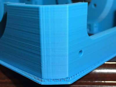

guru_florida wrote:There is noticable shrinkage as the layers increase, so the bottom few layers are larger but that is expected with ABS.
not "that much" :( .. I'd try lowering bed temp further and even tried using a little bit of fan on layers 2-20
for e.g. this is gold abs and yellow abs (cheap esun and colido), as you can see I do have a little bit of elephant foot there (and that too can be solved) but is not nearly as bad as what you are getting... I marked RED the "bottom" of the part
so try lowering the temp on the second layer+ and try adding tiny bit of fan on the second layer for few mm (you measure how much you need from those prints where you have the problem).
also, if you have issues with adhesion to bed you can increase the temp of the extruder for first 1-2-3 layers
