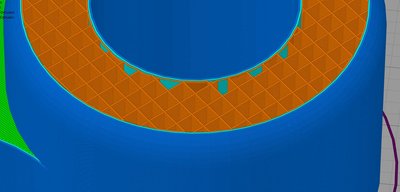

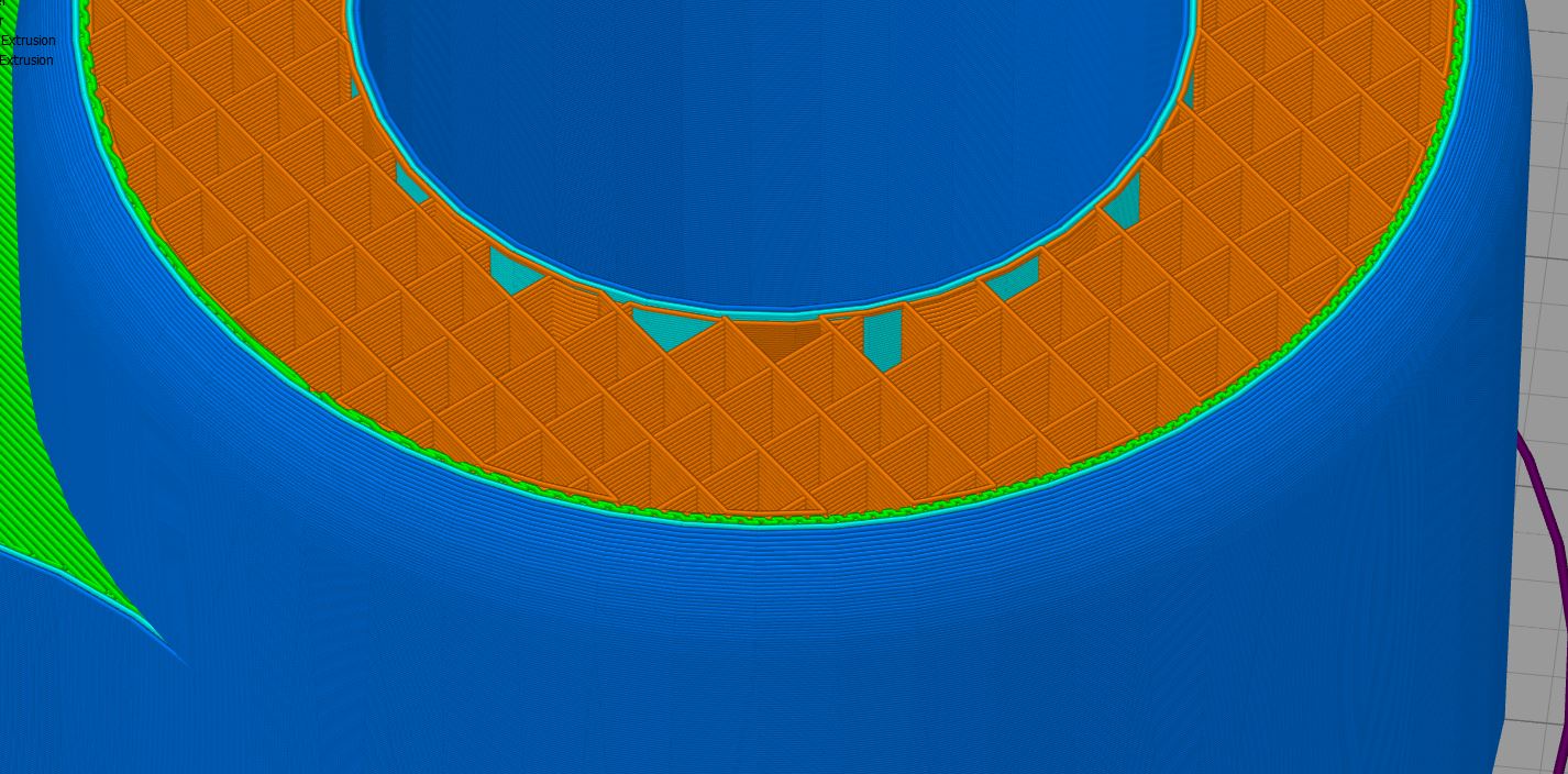

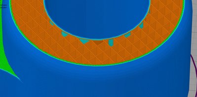

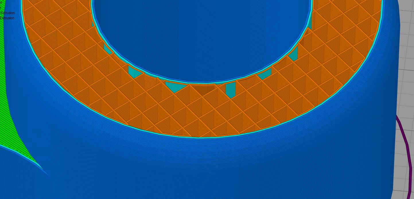

Hey guys, trying to get rid of the green zig-zag infill (Thin Wall.jpg). I have tried altering thin wall behavior and nothing seems to change. The only way I can change this is to change my layer height from 0.300 to 0.210 or lower. When I change to 0.210 layer height than I get a smooth 2 outer shells as expected (Thin Wall 2.jpg).
Thanks for any help!

Changing thin wall parameters have no effect because that's no way anywhere near being a thin wall!
Can you attach a factory file for this part so someone can see exactly what is happening. Two screenshots are totally inadequate.

dkightley wrote:Changing thin wall parameters have no effect because that's no way anywhere near being a thin wall!

You are getting the wiggly lines as part of a solid infill area the slicer has identified behind the steeply sloping surface of the part. This infill cannot be got rid of....but you can make it better by changing the External Infill Pattern on the Infill tab to Concentric. This will change the appearance of any top surface....but it will probably make it look less abrupt.
