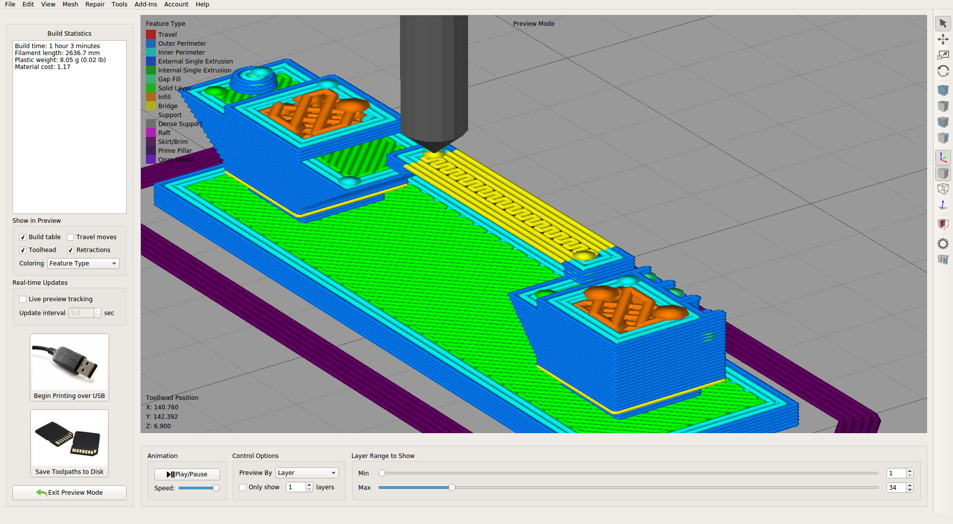

Not to me... I am using version 4.0.1 and the bridge algorithm is just plain dumb. It mostly NEVER find the correct direction for the bridge infill.... In some parts I can handle this dumbness fixing the bridge infill angle - but if the part have multiple bridges at different directions it causes issues.
Look at this infill bridge! It just failed!!! Of course it failed! Who would make a 90 degree infill at a bridge?????
I am really angry because I am using the free Slic3r Prusa Edition more that my fancy US$ 150 software...... Slic3r have a NICE bridging algorithm that always choose the best angle for bridges - and the algorithm is open for S3D guys to check on it.....
