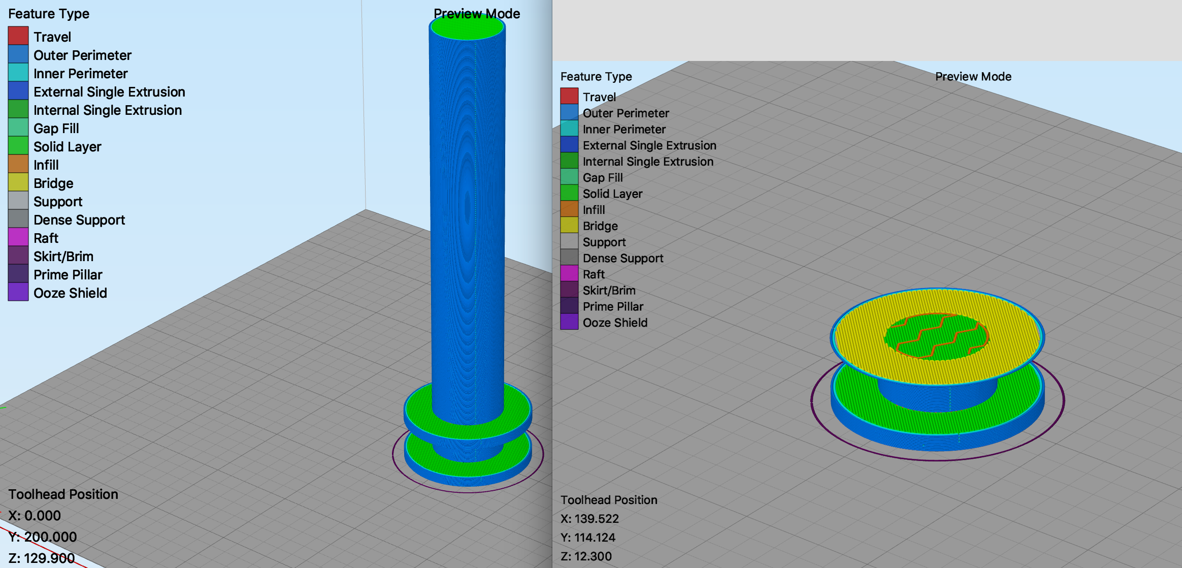

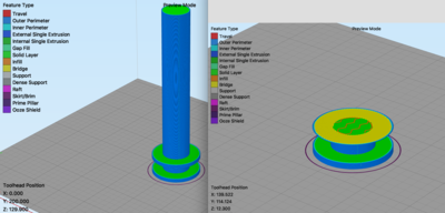

I just want to print a pole like this:

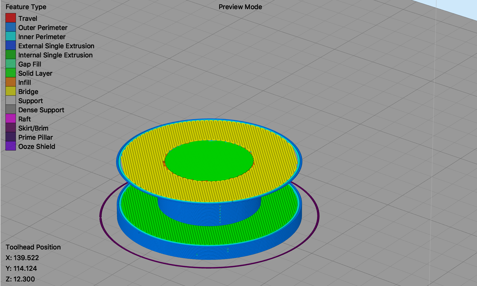

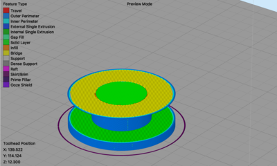

It is important, that the first and last three layers of every "spacer" is not interrupted. This increases the strength and avoids some trouble with printing in the air. As you can see in the next picture this is exactly what is happening, although "Include solid diaphragm every... layers" is checked. Support was turned off to get a better look...
To avoid this you have to create a new process. So I have to create four processes to print this part, right?! So because you have to start and stop the process at a certain hight instead of a certain layer (which would make more sense but this is characteristic for SF3D, I guess) it is a lot of clicking to find out the correct hight, even if you cut the part with the cross section tool.

Ok, so you want to print part of the model with a completely solid layer that goes across the entire part, but for other parts of the model you don't want that? In that case, you'll need to use multiple processes to tell the software you want it to behave differently (thankfully S3D has this option, other programs do not).
To set it up, go to Tools > Variable Settings Wizard, then drag the slider so the red plane is located wherever you need to make the changes (in your case, on either side of the spacers) and click "Add Location". When you're done, hit OK and it will create all of the separate processes that are needed. Then just open the spacer processes and set those print a solid diaphragm every 1 layer. That will make sure every layer in that process is completely solid.
PS - the reason you were also seeing a yellow region in your earlier screenshot is because you have bridging enabled (yellow represents bridging). By default it should use bridging settings when it prints the first layer of the spacer. If you don't want that, then just set the bridging area threshold to 999 to disable it.
