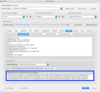

DarthRevan
Re: S3D with UM3, fails to print
Temperatures are set in the Simplify3D profile, not in this header portion.
The script is to be placed in the "Terminal Commands for post processing" area. It should replace the existing script offered up by Simplify3D.
For CPE replace the lines ";EXTRUDER_TRAIN.0.MATERIAL.GUID:506c9f0d-e3aa-4bd4-b2d2-23e2425b1aa9" and ";EXTRUDER_TRAIN.1.MATERIAL.GUID:506c9f0d-e3aa-4bd4-b2d2-23e2425b1aa9"
with ";EXTRUDER_TRAIN.0.MATERIAL.GUID:12f41353-1a33-415e-8b4f-a775a6c70cc6" and ";EXTRUDER_TRAIN.1.MATERIAL.GUID:12f41353-1a33-415e-8b4f-a775a6c70cc6"
cutl2014
Posts: 15
Joined: Thu Sep 07, 2017 7:19 pm
DarthRevan wrote:Temperatures are set in the Simplify3D profile, not in this header portion.
Amazing thanks, so will the Ultimaker use the temperatures that I set in S3D (because CPE is hotter at 240 than PETG at around 220) or its saved default temperature for CPE? Obviously I'd like it to use my custom temps.
