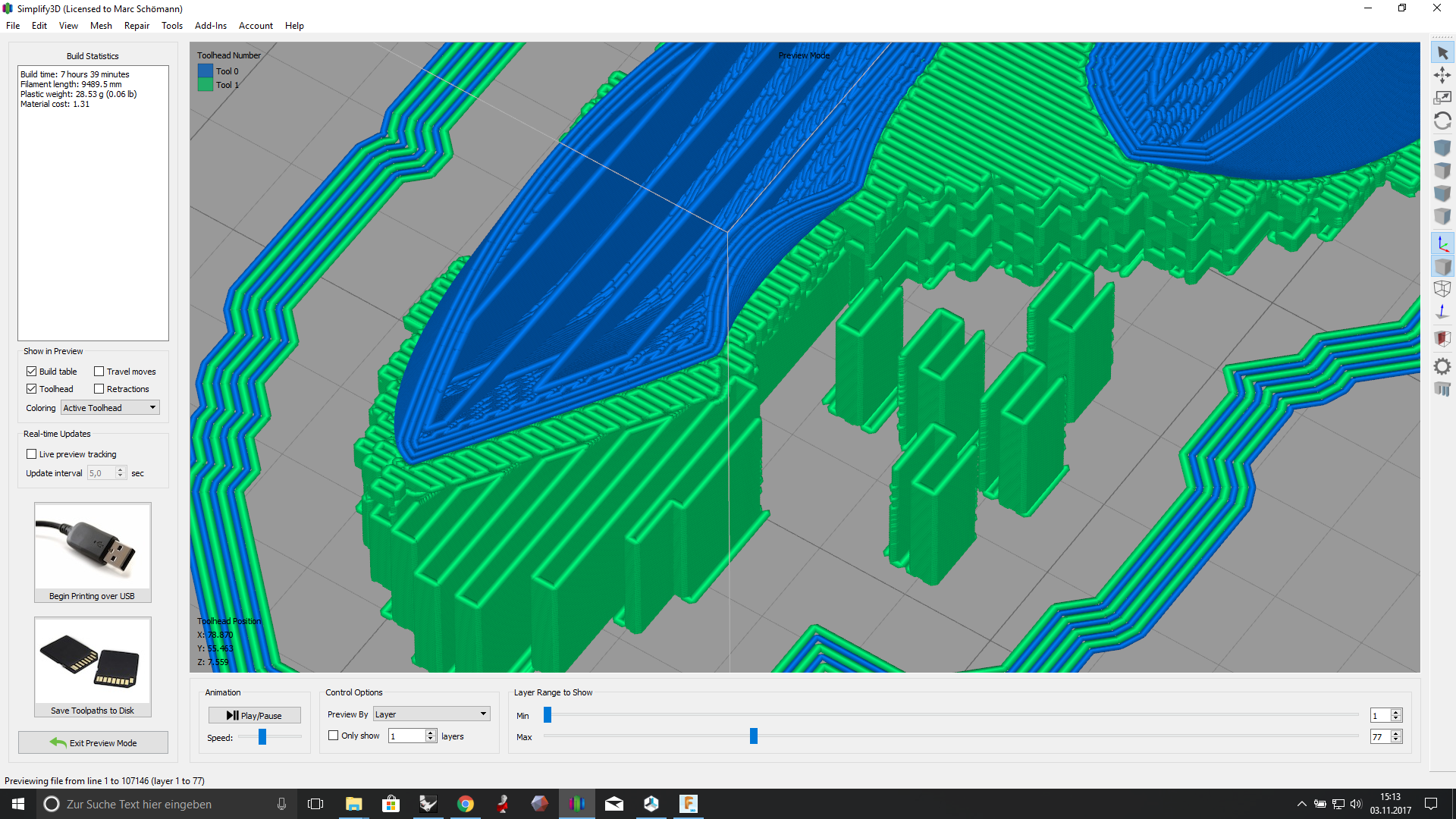

i came across a Problem which i didn´t saw before i used soluble support.
As you can see the Support structure is placed like a Gap fill in a Jagged line.

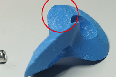

Of course this Structure is visible if you use a small offset (like you should with soluble support):
This pretty much ruins the beauty of a soluble Support because it doesn´t look that much better normal support.
I think one or two Perimeter between the Support Structure and the Model would fix this issue.
