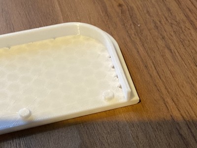

This really needs to be supported as an option. Here is what my print looks like. Simplify3D excludes printing the area where the edge protrusions are which causes a collapse because the filler isn't dense enough to support. I can somewhat fix this by using a higher level of infill but the slicer should really take care of this.
