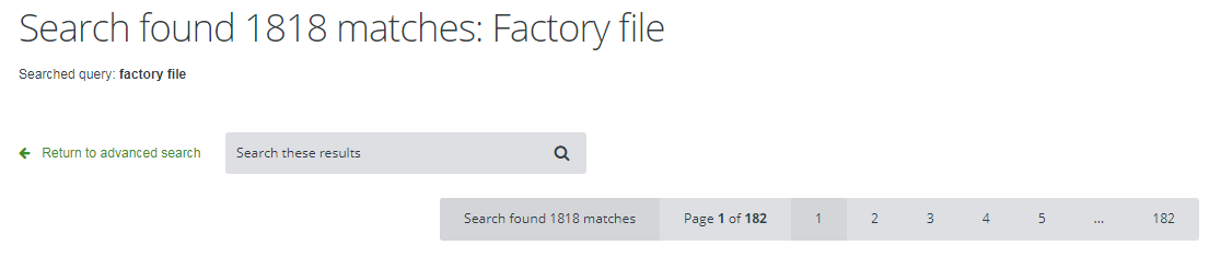

If you try the same by using RETRACTs it may have a better result.
And if you want, you can attache your FACTORY-file. Without any informations of your settings nobody can help.
