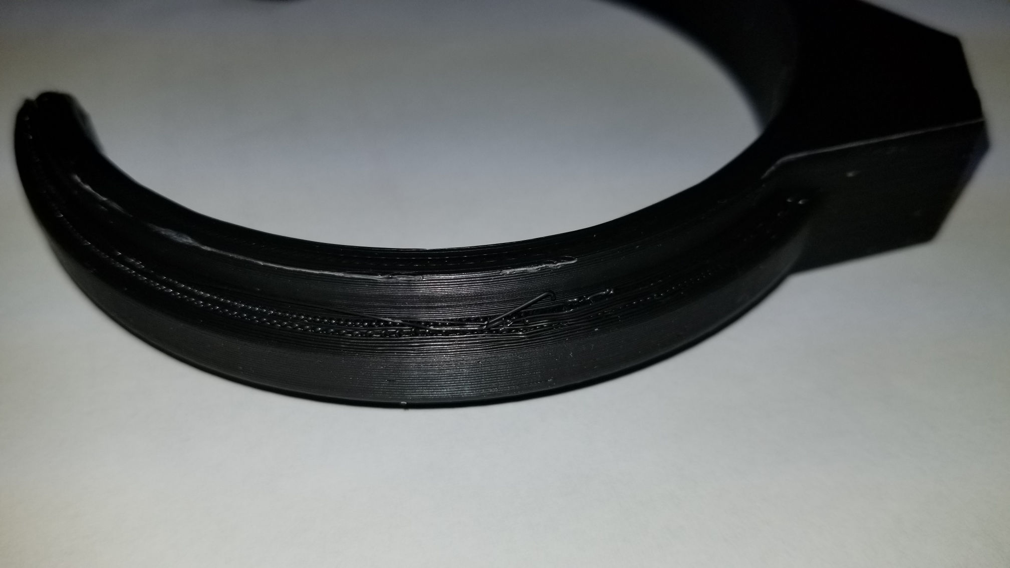

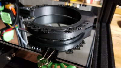

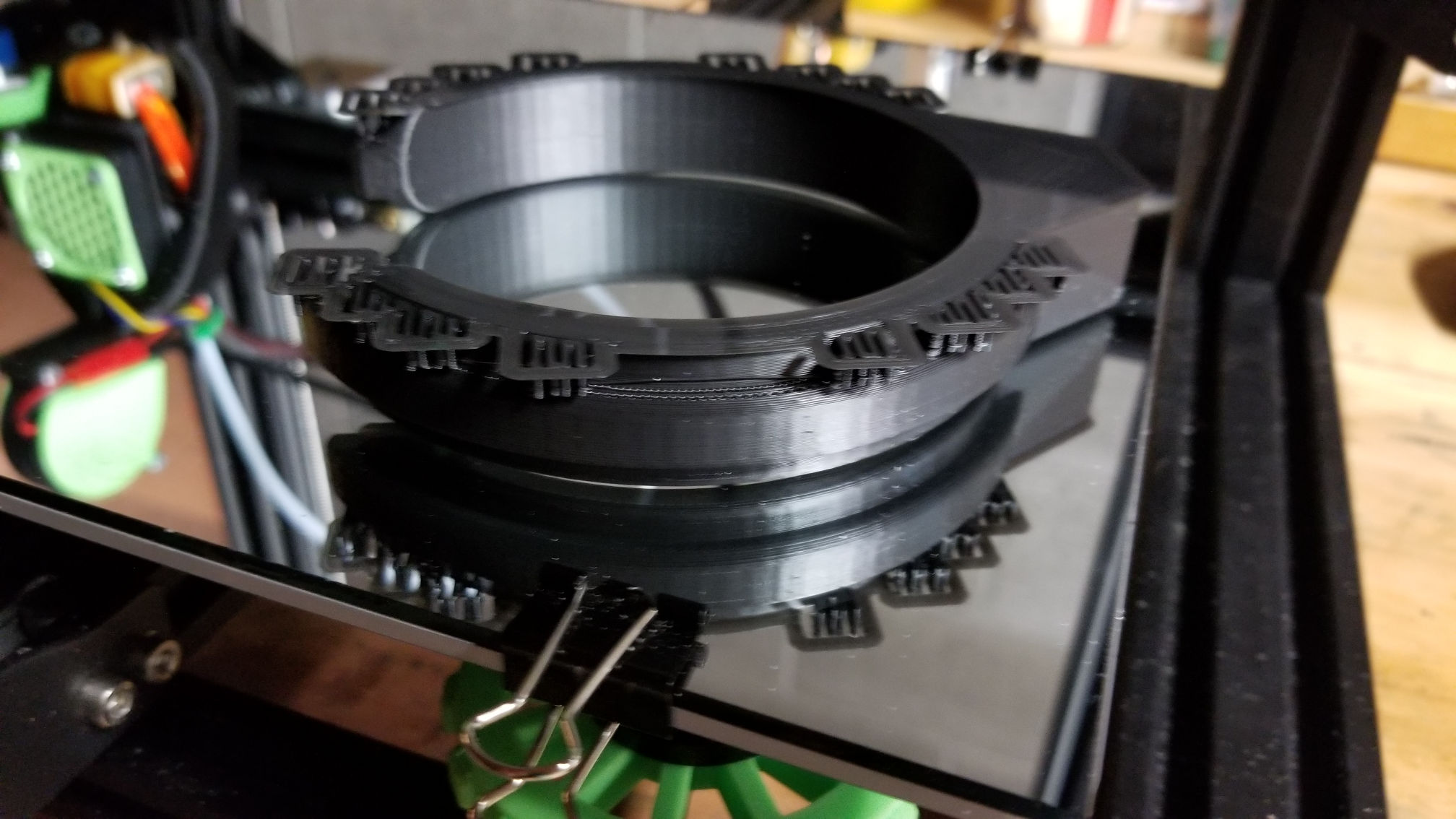

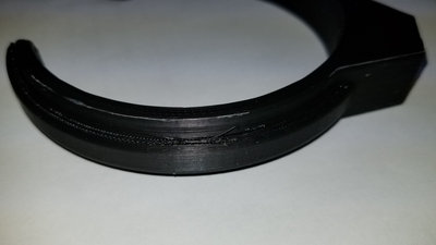

I'm posting pics of the problem I'm having hoping some of you S3D experts might give me a hand. I'm also including the factory file. Everything looks pretty good except on the middle bottom radius. I've tried to print this 3 times and get the same results. The pictures explain it better than I could ever in words. I'm printing with Raptor PLA at 240 C on the hotend and 60 C on the bed. Thx for any help you might have.

240°C for PLA is most probably to hot.
No wonder that with an insane infill of 100% for your middle part it is just melting away.
Some 30% or 35% should be more than enough for that design.
Temperature for PLA around 210°-220°.
Posts: 1374
Re: Need Some Help
I print Raptor at 245 so the temp is most likely ok but it can print much cooler also.
I think you may have to much angle ("overhang") there. So, the print is moving laterally faster than it is going up and the layers don't have much to bond to,
You might try going to a lower layer height for that area so it builds horizontally a little slower. Also make sure the part cooling fan is on full and slow down the print also.
My guess anyway by looking at the picture

Sorry guys for giving the wrong advice here.
I mistook those pictures for some melting away when watching with my mobile this morning.
This certainly is a overhang/less supports issue.
And still I feel 245° for PLA a fairly high temperture, at lest for my PLAs and my setup (silicone sock).
Could well be that this Raptor stuff needs higher temps.

I'd suggest three things....all on process 2
Increase perimeters by 1
Make sure you have support all the way round..and use a dense top layer
Change the External fill pattern to Concentric

The Temp 245º is fine. I print PLA at 240º to 245º - it's my default temp for PLA.
The problem is the overhang - less than ~45º will droop - the radius is nearly flat as it starts it curvature (image).
TIP's: Change it from a Radius to a Chamfer of 45º of greater.
Put a fan by the printer - direct air to the plastic just printed but not directly at the nozzle (this will cool plastic before it droops too much)
Use supports.
