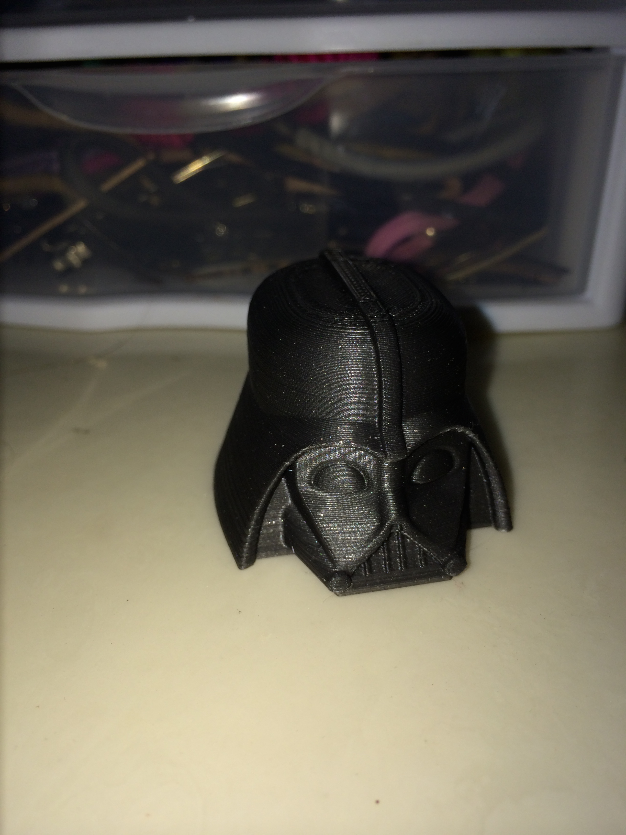

rsilvers wrote:There is a seam on one side.
Zits look bad because they are random defects. Every injection-molded part has a seam and that is much less objectionable.
True, Kisslicer handles the seam much better though. I guess I would like to see that handled a bit better on simplify3d. How visible is you seam?
vinny1575
Posts: 42
Joined: Tue Mar 04, 2014 12:01 pm
Re: Zits.
So this is odd. For the heck of it I printed at 100 microns layer height and it turned out flawless. No seam, no zits. I didn't grab a picture, I ended up having to pry it off my print bed because it was stuck. Ill get one next time though.
rsilvers
Posts: 62
Joined: Mon Feb 24, 2014 10:45 am
Re: Zits.
My seam is very hard to see on this part.
However, on some parts I have had a significant seam. Though it doesn't really bother me since it looks deliberate rather than random.
vinny1575
Posts: 42
Re: Zits.
When I do see the seam it still looks very random. I can't get it to stay straight on anything but a square block.

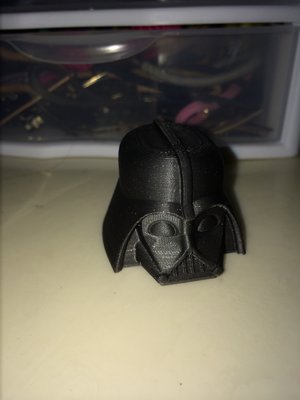

Everything looks great since the new update. The seam is great (just as good as kisslicer). I am now officially making simplify3d my main and only slicer.
vinny1575
Posts: 42
Re: Zits.
Should've added something for scale. Its about 2 inches tall.
