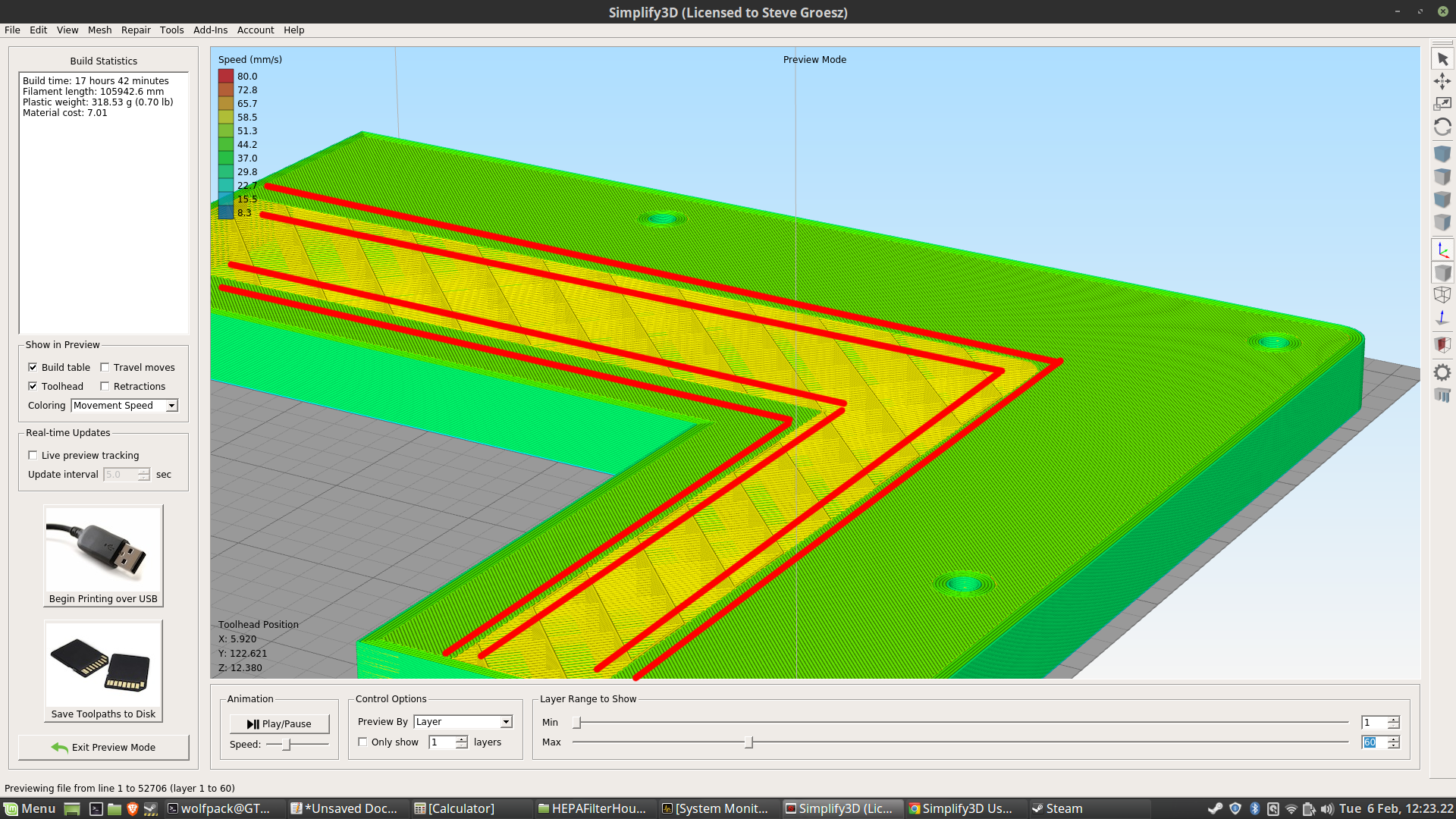

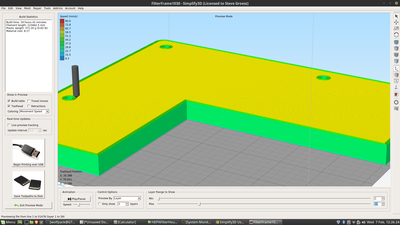

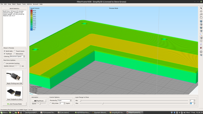

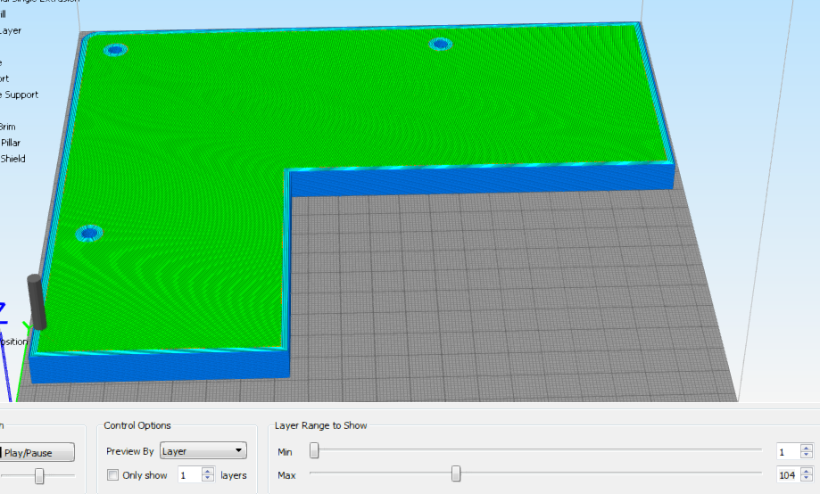

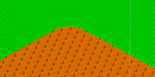

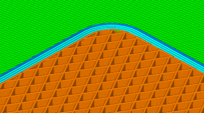

Top surfaces of a print which contain layers above print very poorly. This is because it appears that Simplify3D does not include outlines for the surface layers to adhere to below the top layer. I don't really know how to explain, but hopefully some images will help.
I've gotten around this by setting up multiple print processes, and printing a few layers with solid infill before the surface layers begin to print. However, this is very time consuming for prints with many surfaces at different heights of the model.
Cura seems to avoid this issue by printing an outline of walls with the solid layer. Another solution, though somewhat less elegant and more wasteful, would be to print surface layers as a complete solid layer.

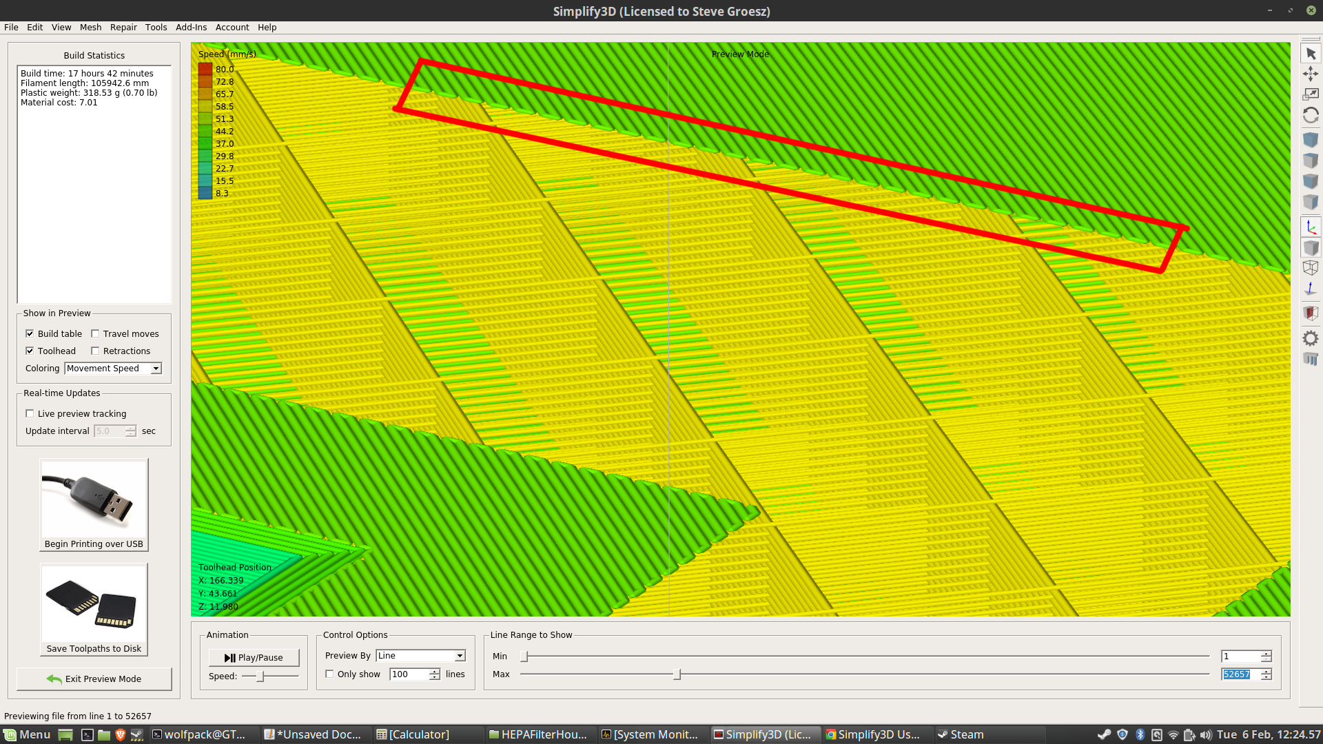

I've indicated the problem areas in the attachments.
*Edit: changed the title to better clarify the issue
Problem area close up

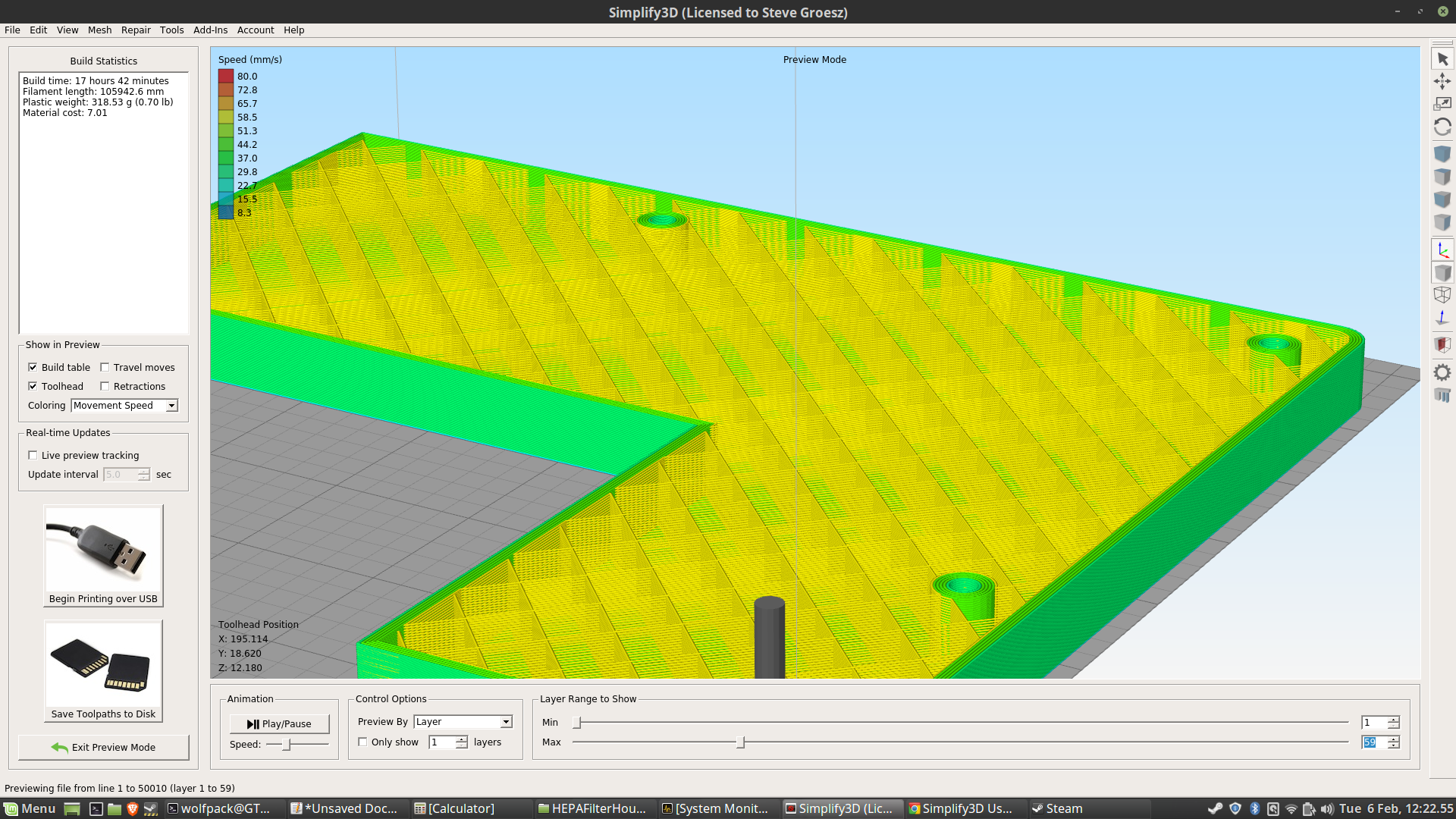

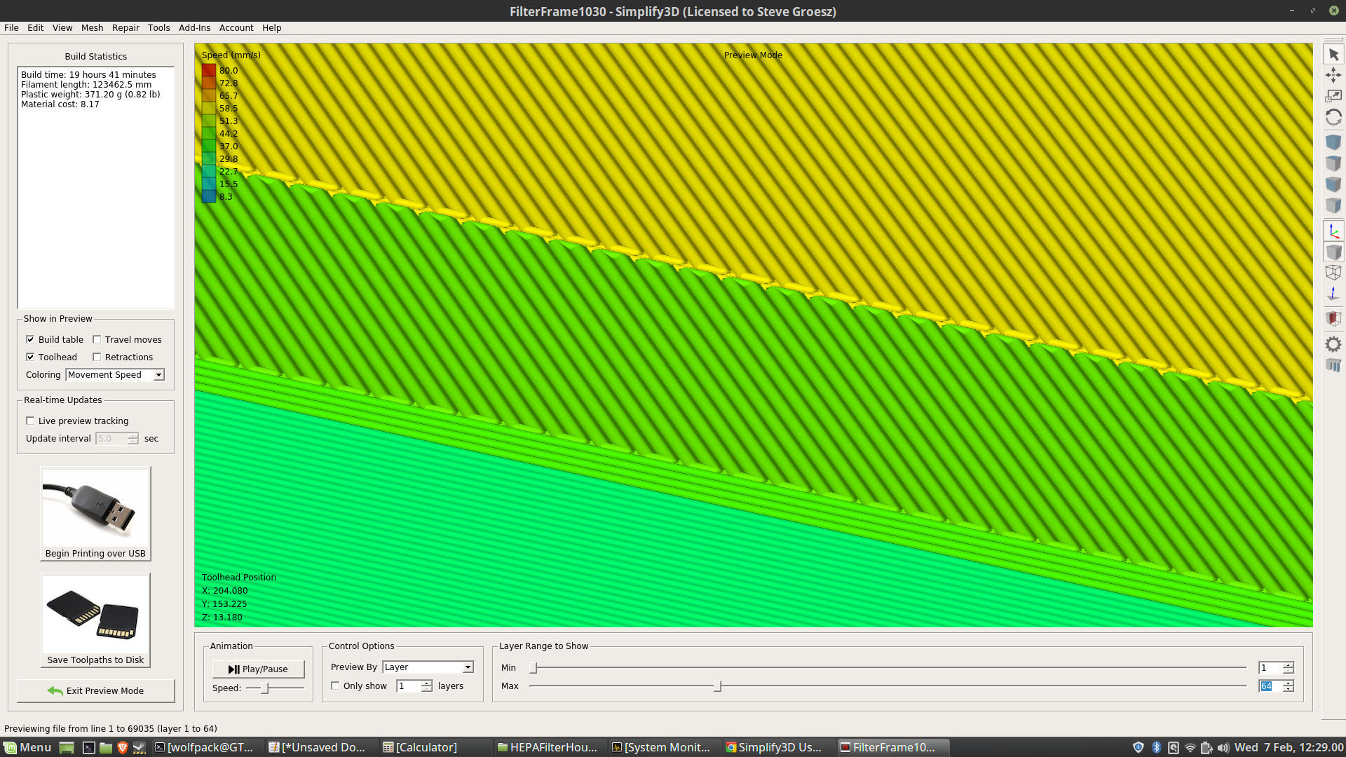

First surface layer - problem area indicated

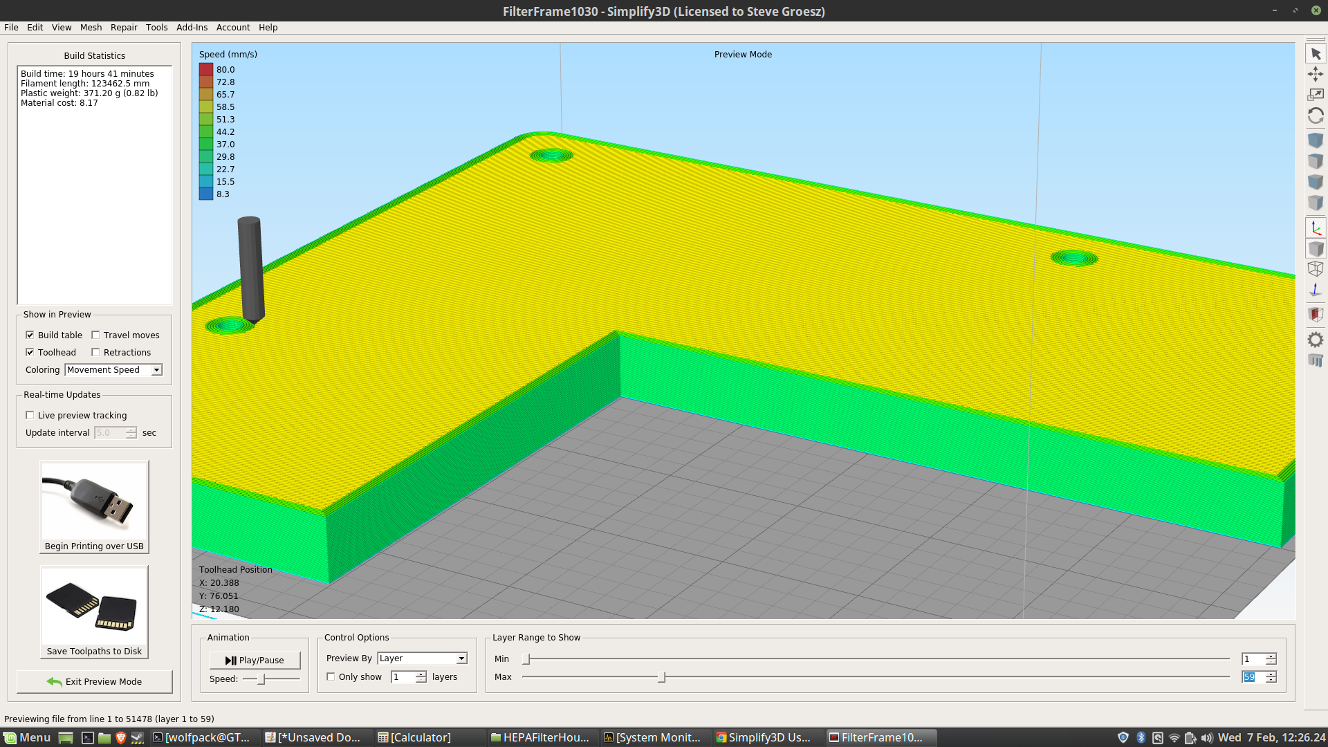

Infill layer before surface

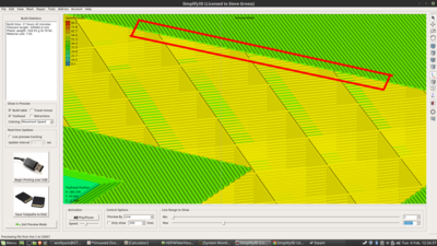

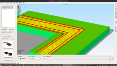

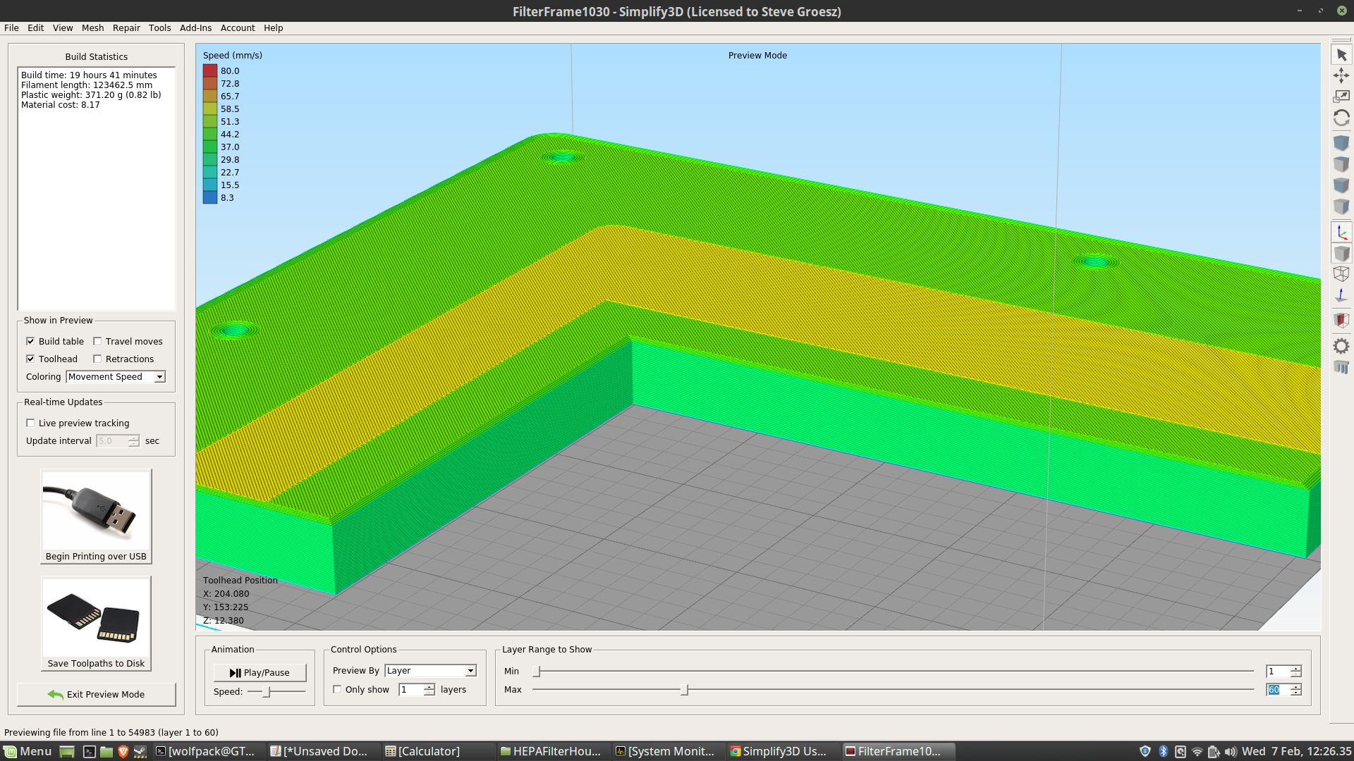

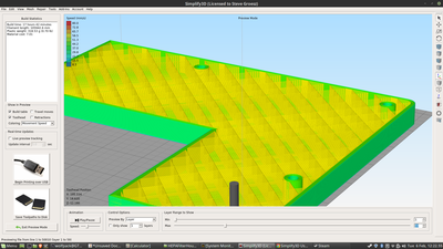

To expand on my initial post, it seems the problem is exacerbated by the fact that the floors are projected beneath the surface. I've included a few more screenshots to demonstrate. The yellow "floor" is infill.

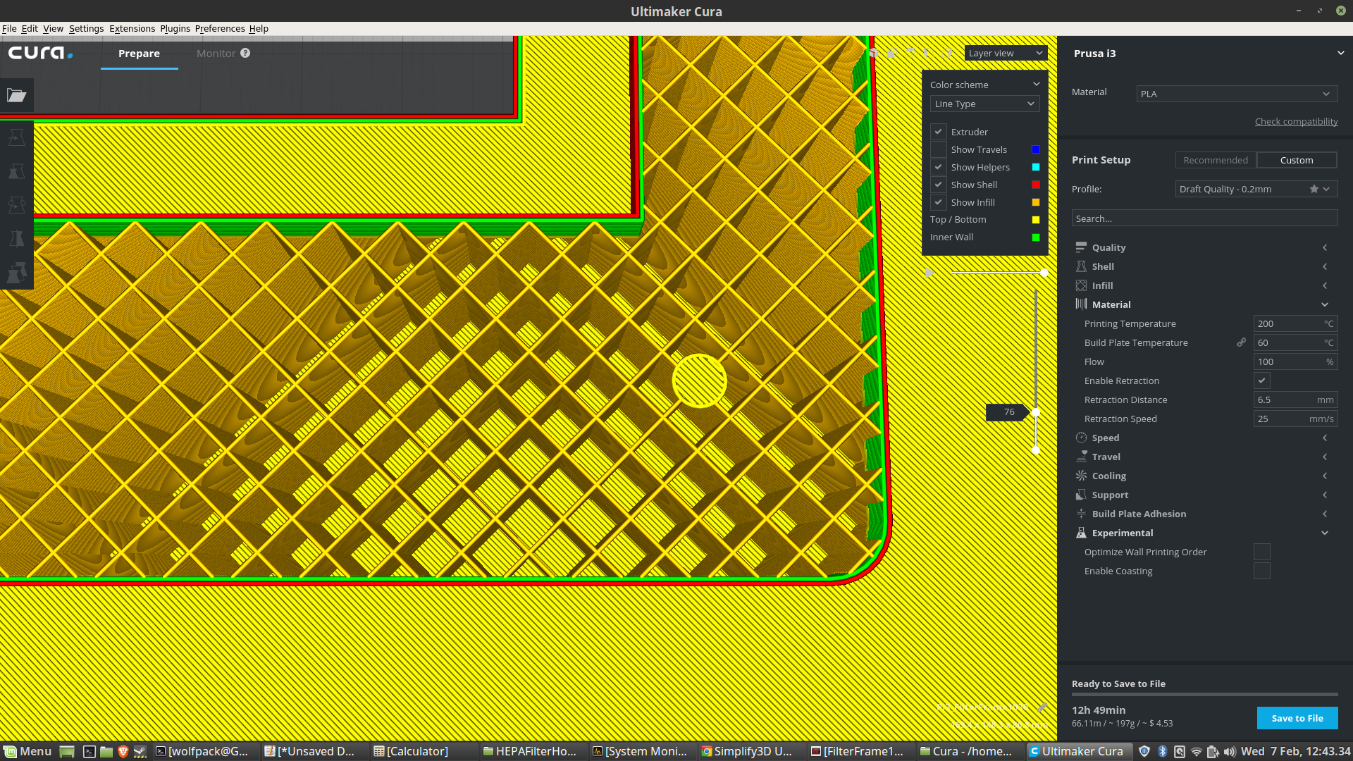

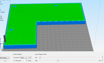

I also included a screenshot from Cura. You can see that Cura includes a solid outline before laying down the surface to give the edges of the surface something to adhere to.
If this can be fixed with settings in the current version of Simplify3D, that would be great. This problem goes beyond just appearance. It can create blobs and bumps if the surface plastic warps upward during print, which can snag on the printhead and cause bad things to happen.
close up of surface boundary
first surface layer
first surface layer
Solid support layer before printing surface

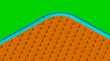

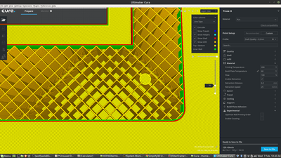

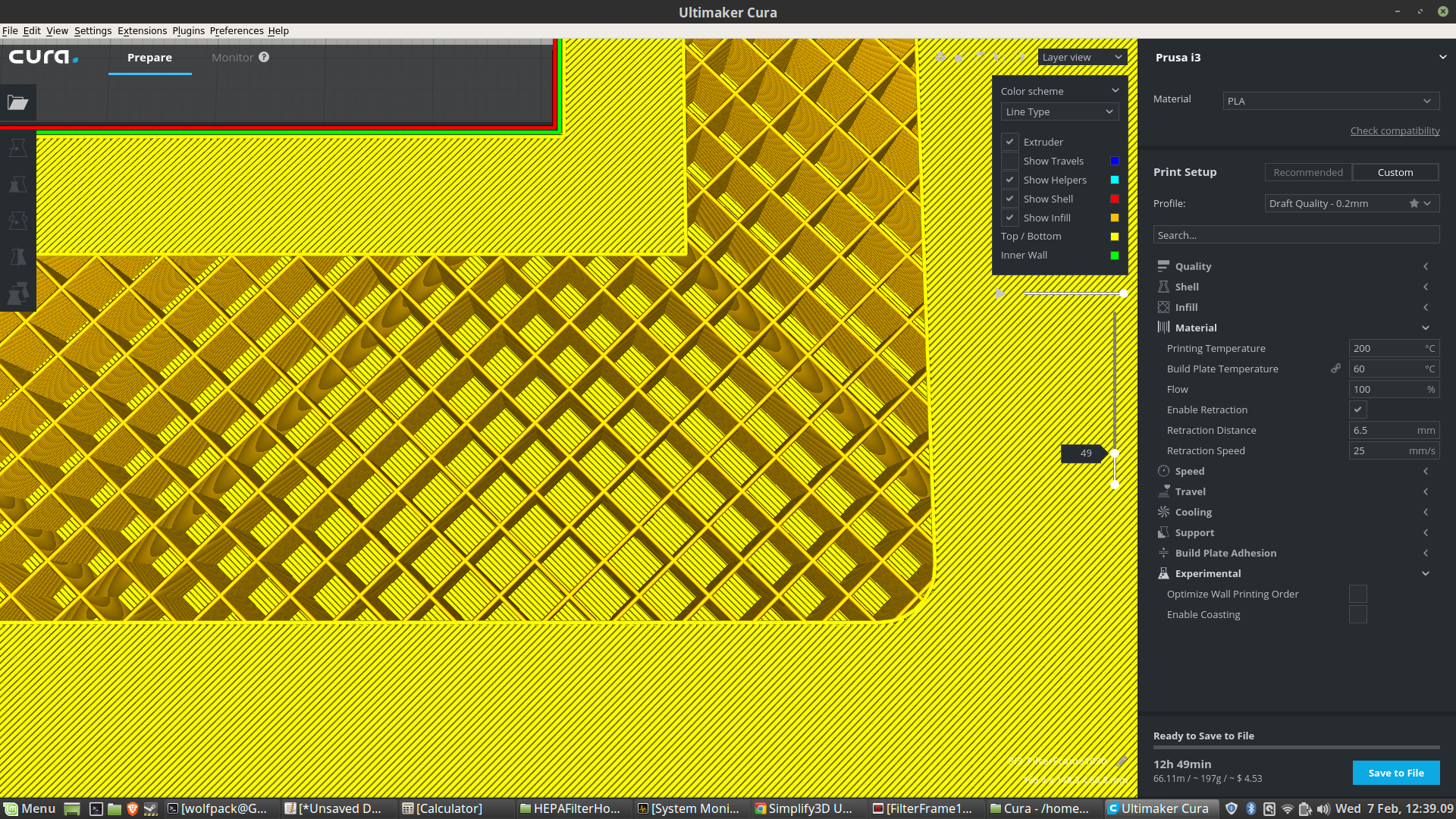

Here are some screenshots from Cura. You can see it prints an outline around the bottom surface layer to give the edges of the surface layer something to adhere to around the perimeter. It's a single extrusion, but it makes a world of difference when printing bottom surfaces. The outline is printed as part of the outline process with the walls, and is laid down before the floor surface.
The sparseness of infill does have an impact on how pronounced the problem is, but the problem is still present unless using a solid infill beneath any bottom surfaces.
cura circular surface outline
cura surface outline

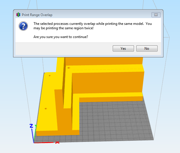

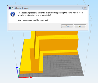

Don't compare Cura with Simplify thats are different things!
You have created a lot of processes I cannot see what the reason is. Prepareing to print produce overlaping how ever and shows the issue.
Only choosing the first process the print is ok.
H.

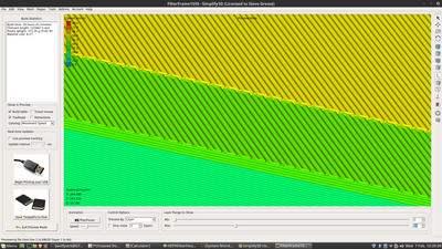

Doug, you are right for all,
but things are existing and with reasonable settings this object is to be print in a very strong way without any deficiency. With only one process, varieties are possible ...
The transition between the first top layer and the infill of the growing up tower is only the INSIDE of the tower, this brink will not be seen - why crying about, don't worry!
No discussion about nearly 20 processes, but all other settings are also more than poor.
After printing the 5 top layers, where the infill of the tower is also growing up without any interruption to the base area and is building a unity together, S3D is printing the towers perimeter on it.
For this case I can't see any deficiency ether strong printing or optical issues. May be, that very special objects have disadvantages with this strategy, but mostly it is more than sufficient.
With 5% infill and other poor settings, we say in Germany, you can'nt win a flower pot. I don't know what Cura is setting automatically, but surely it is not comparable with 5%.

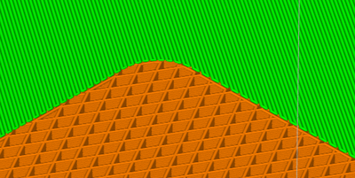

The pictures are showing my normal settings, here the beginning of top layers and 2nd the first layer with perimeters of the tower
