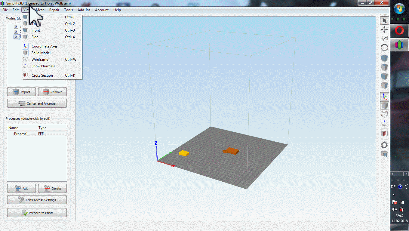

Auto-Rotate View does a continuous animation of a slow rotation about the Z axis.
Not a really important command but it can be a nice way to visualise your models.
Here it is in the v4.0.0 menu bar.

Re: Problems with v4.0.1
ok, I'm sorry,it is here in my 4.0.1 installation. The dropdown-menue reachs to the ohter textes in the main menue and "Auto-Rotate" covers "Import / Remove"
H.
... also never used ;-)
really mysterios !!!
I ended S3D and restarted the program, the menue point was now not visible.

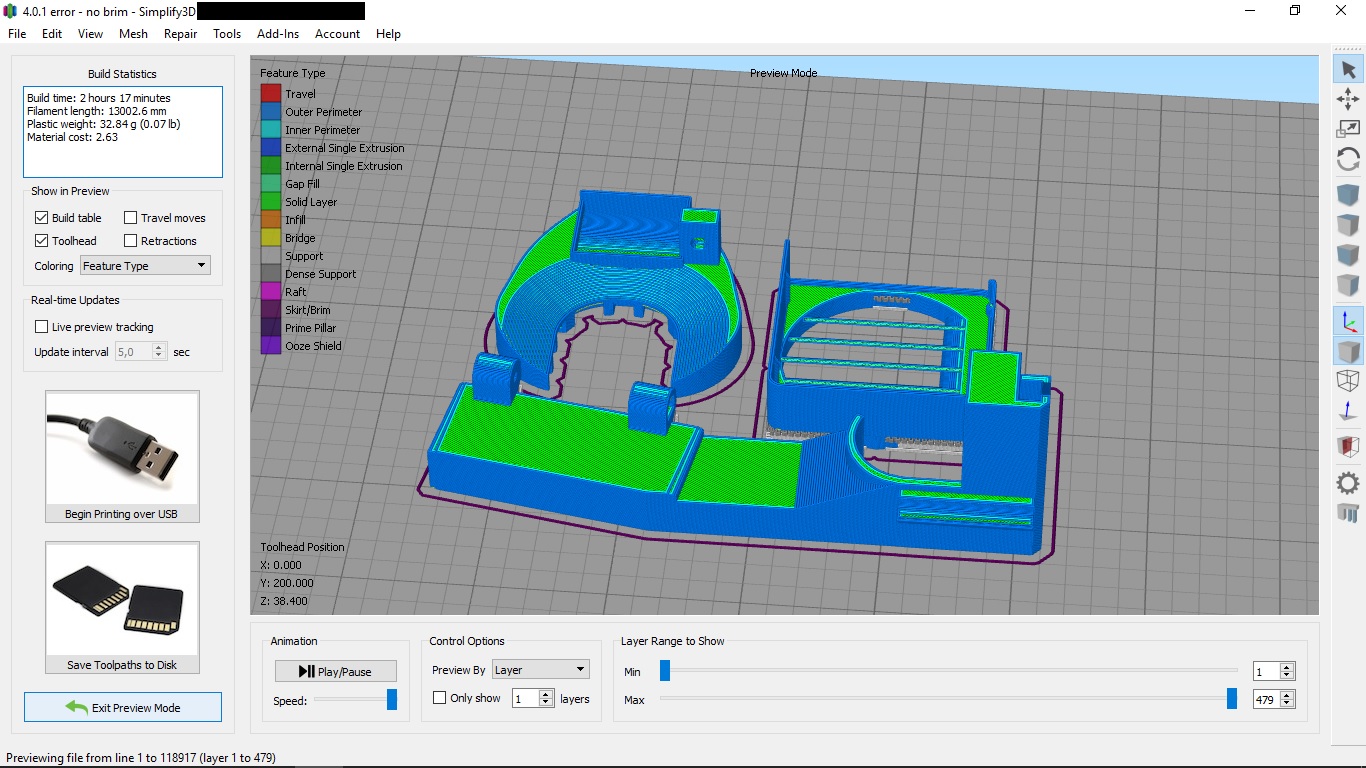

no 3.
Wrong Z height shown - should be 0,2 and shows as 1mm

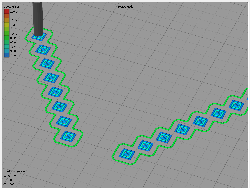

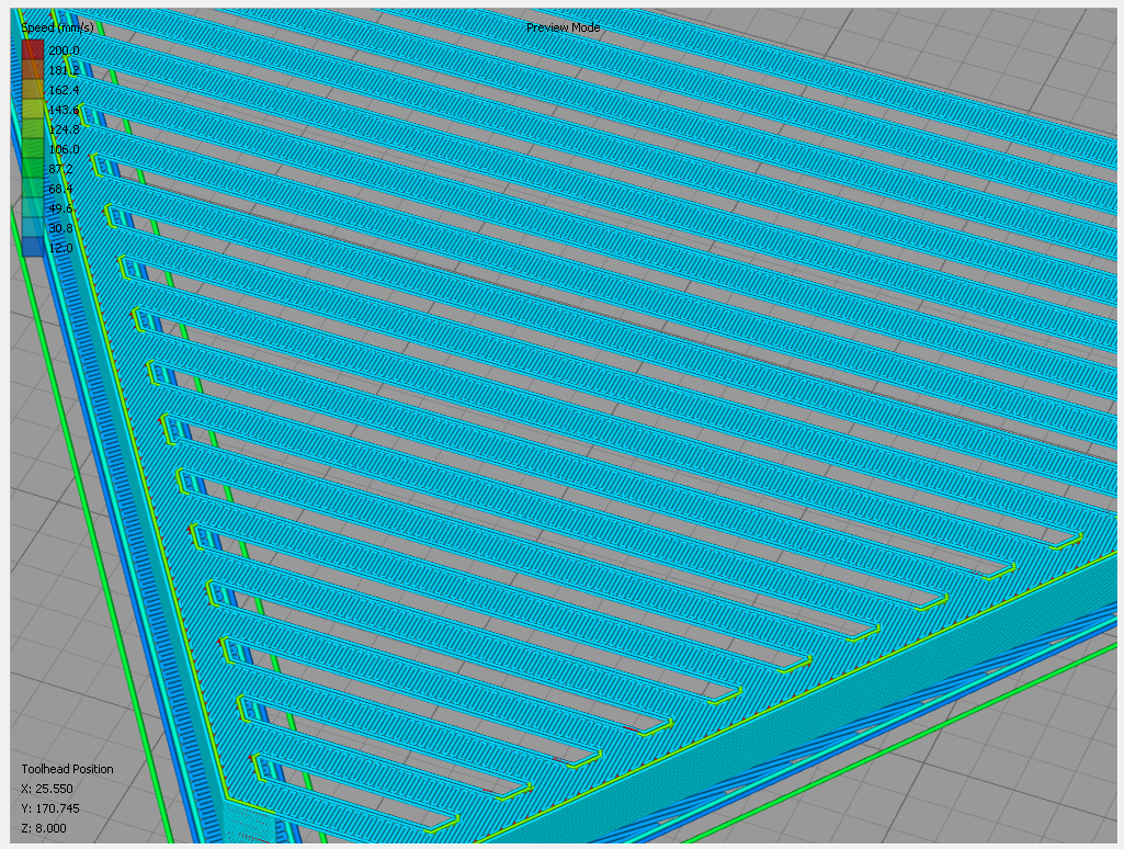

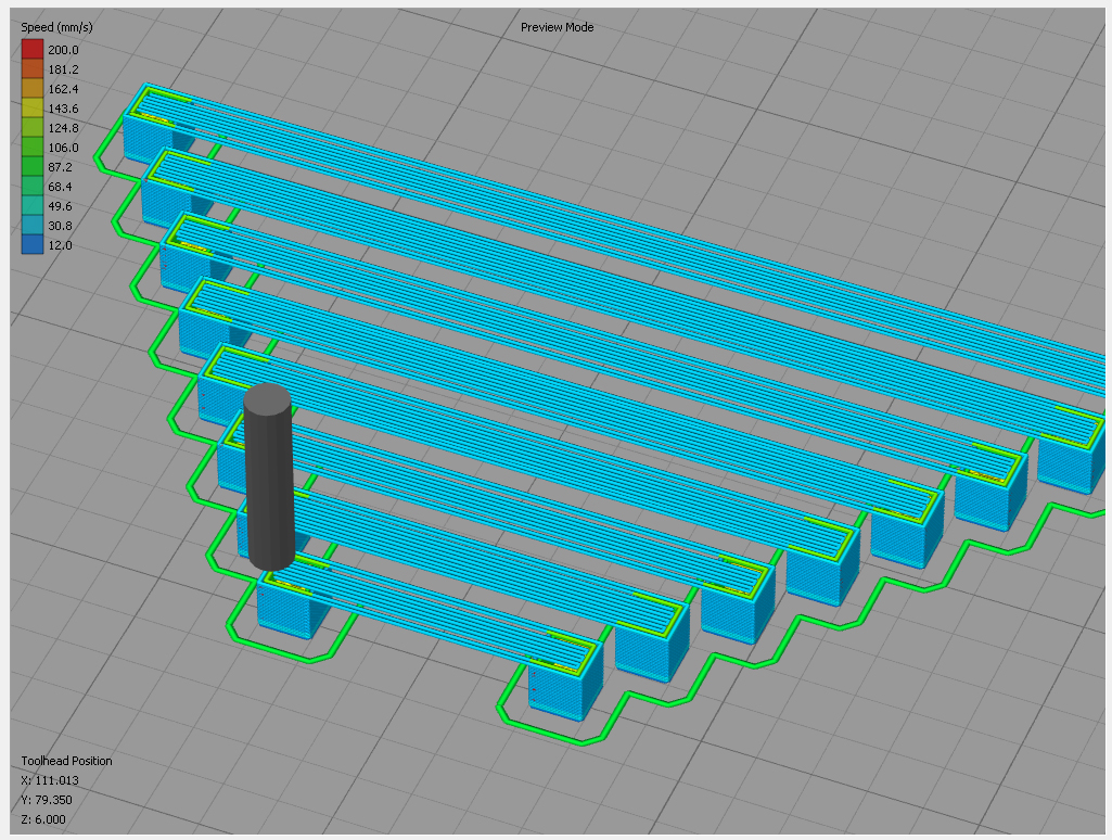

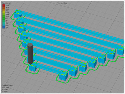

no 4.
Calibration STL downloaded from thingiverse - bridges are ok
I've created this one for better bridging calibration - bridges are all wrong (generated sideways - same settings as the above).

Re: S3D v4.0.1 Bug Reports
szafran's second item......item 4 as per TekMason........is not a bug/issue. The bridging algoritm tries its best to determine the angle for the bridging extrusions. For where it's unable to reliably determine the angle, there's a setting Use fixed bridge infill angle, where the desired angle can be specified by the user.
In my opinion it is a bug (Slic3r cuts this properly). And what that option would do if on the same height there will be bridges in different directions ? (hint: it would be totally useless).
