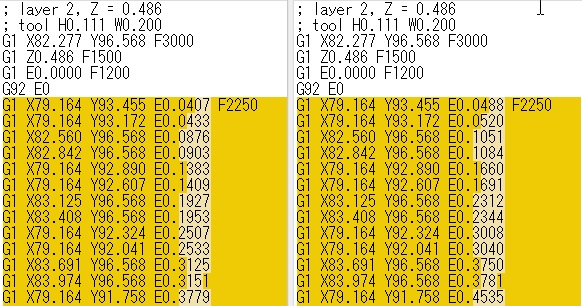

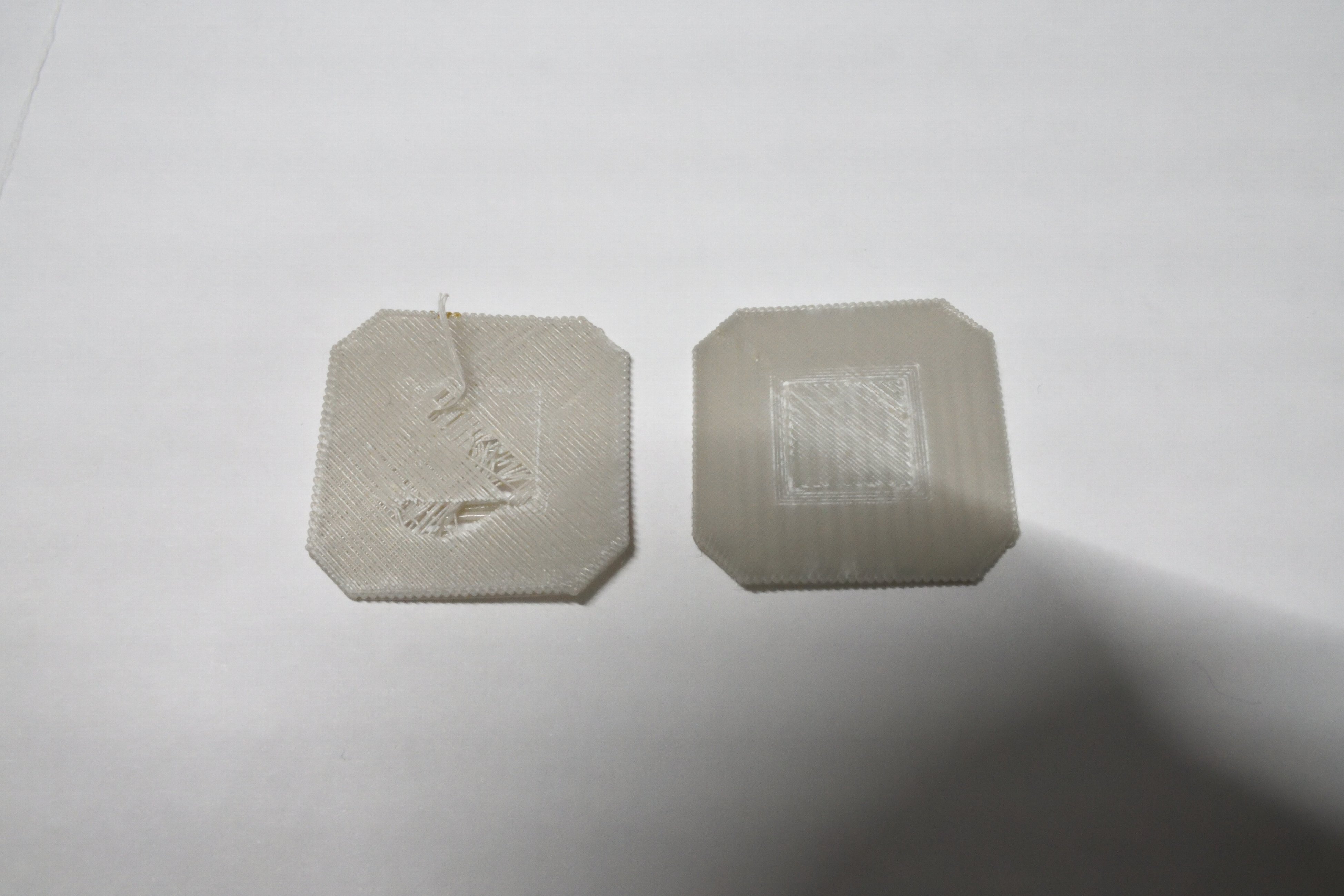

Rafts made with 0.2 mm nozzles are weak in strength.
Therefore, printed matter may be deformed.
By increasing the extruding amount of the filament, the strength of the raft can be increased.
The left side is normal. The right side is the extruding amount of 120%.
I hope add an option for raft.
