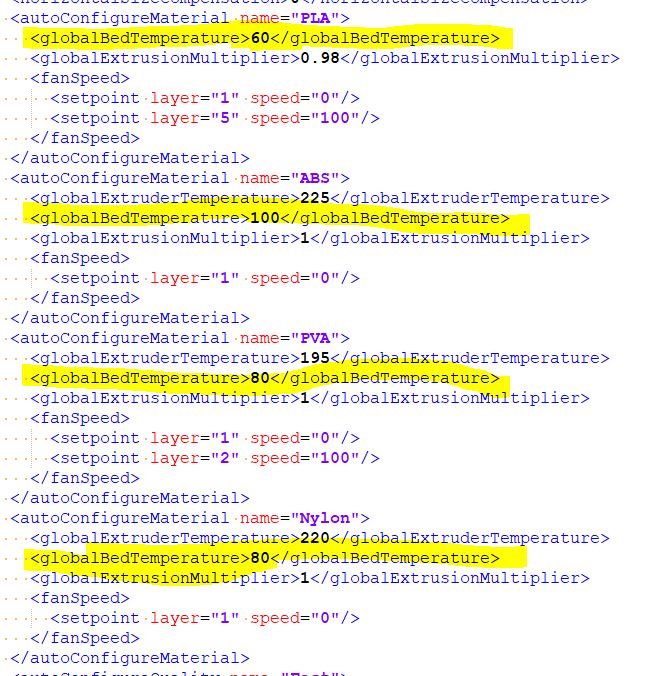

Crunchysann wrote: Also running into this same problem...Not that it matters because you can reproduce this problem an any computer following the steps above with default profiles. But I've attached my FFF profile anyway. This is happening in S3D 4.1.2 on Win10
Sorry, can't reproduce the problem using my current profiles. But looking at the FFF file:
While there's a temperature controller "Bed":
...all the material presets come with a set globalBedTemperature:
I'm always using the temperatureController-tag when adding presets, seems to work so far. Maybe replacing the globalBedTemperature-tags
might work.
Re: bug: FFF settings does not save bed temperature
I believe to update the bed temperature to have multiple setpoints you need the temperature controller to be present in the autoconfigures for materials. So in the case where there is a global temperature setting you would actually want to remove that and add the bed's temperature controller in it's place.
