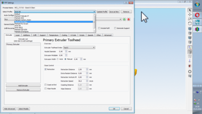

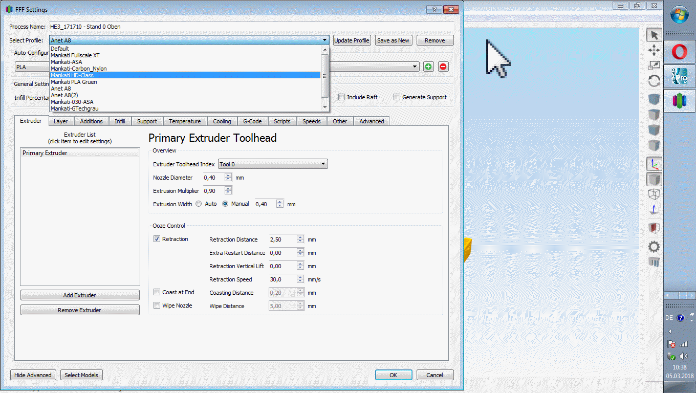

... that is not needed if you work with your own Factory-Files so as I do it.
Impoting a factory-file add this settings to the profile-list. To identify what profil is what printer (or strange import from this and other forums) I "Save it as new" and start the name with the printers name, followed from the material main properties:
i.e.
Mankati-GeeeTec-grey
Anet-PLA-green
S3D opened once I can switch between the profiles and to all special settings, the properties of the printers are also changed.
To keep controle over all I look after profil changing only to the Tab GCode where the dimensions of the print beds are set:
-Mankati 250 x 250 x 290
- Anet 220 x 220 x 200
Export the factory-files step by step when using the different printers to a own folder of clear named files and everytime you want to use a certain printer with its special profile you must use the "Open Factory option" in Tab File, only 1 time for each printer. For the 2nd time it is stored and you only need to switch between the profils.
The option "Save and Restore ..." in Tab Tools must be checked on when work with new factory-files. After closing and reopen the program all profiles will be kept.
The first opening of a strange factory create a new profil named "Default" >>> Save as New ...
Creating a totally new profil for a printer (i.e. new material) it suffers to "save as new" directly, but your factory-file-list is not complete, it needs to export it via the "Save as ... option".
