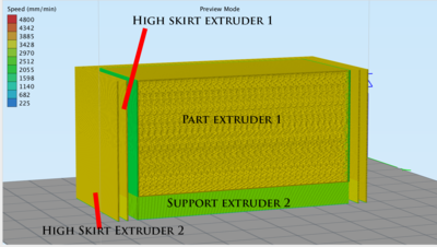

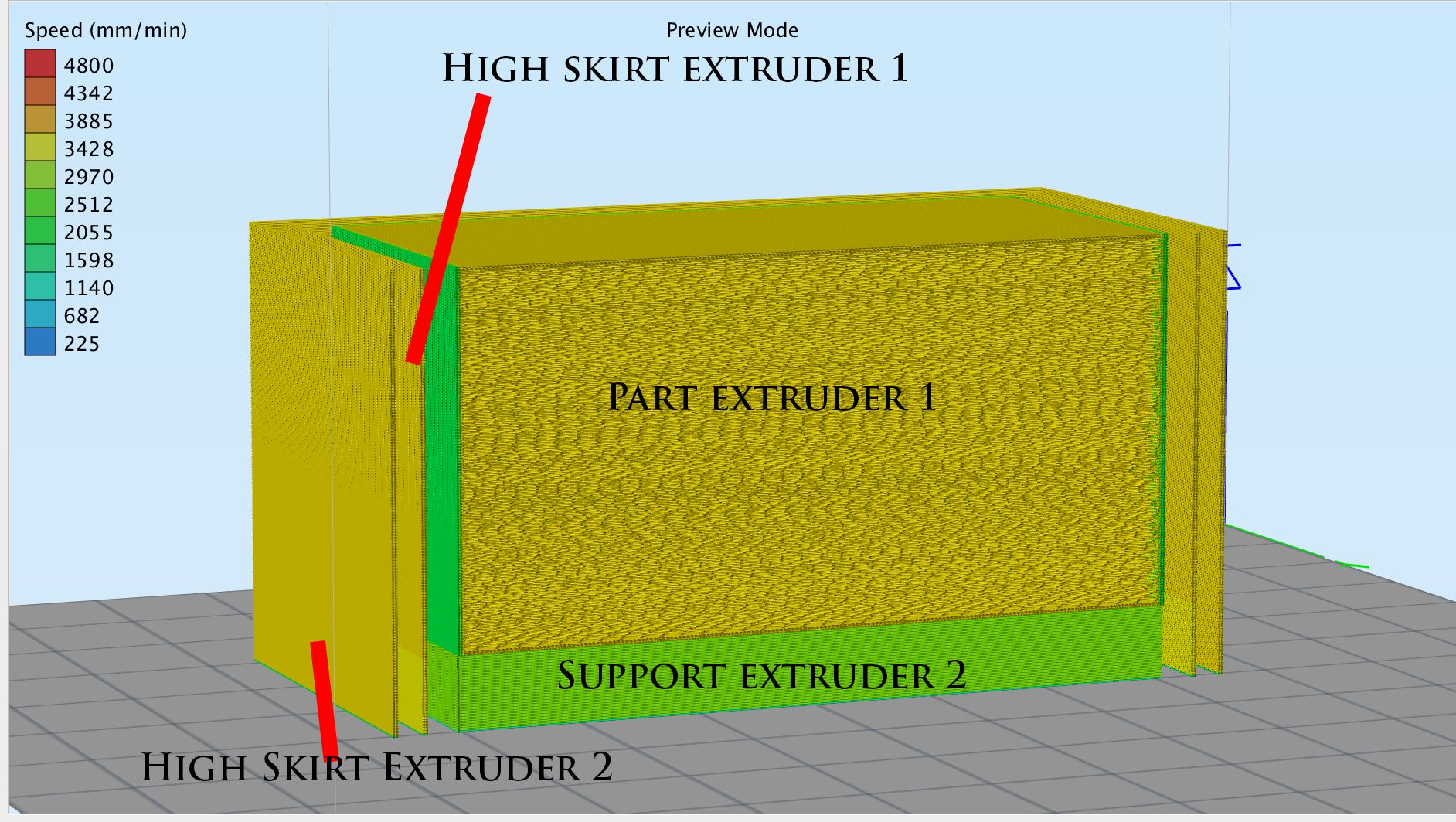

Also, when using dual extruders, how can you get both extruders to lay down a skirt? It would seem that this should work: Edit Process Settings > Layer/Right Extruder > [check] Include Skirt/Brim > Set Distance > Select Left Extruder > [check] Include Skirt/Brim > Set some different distance (maybe S3D should know this from the right extruder settings).
But it doesn't. My point is this: All the pieces there in the S3D GUI. Most people using dual extruders want to do this for every print. It would seemingly be a simple improvement. Better than blasting out a blob just to have it dragged into your part.

your question probably shouldve been posted as a separate topic... instead of posted a couple times in different threads...
anyways:
1. make 2 profiles, make sure both is set instead of just left or right.
2. make one profile not generate supports, this will print the main part of your object. skirt layers >= layers in your object.
3. make the other profile generate support with your support extruder. also do zero top, bottom, shells, and infill. skirt layers >= layers in your object. skirt offset a bit higher than your offset in profile one.
