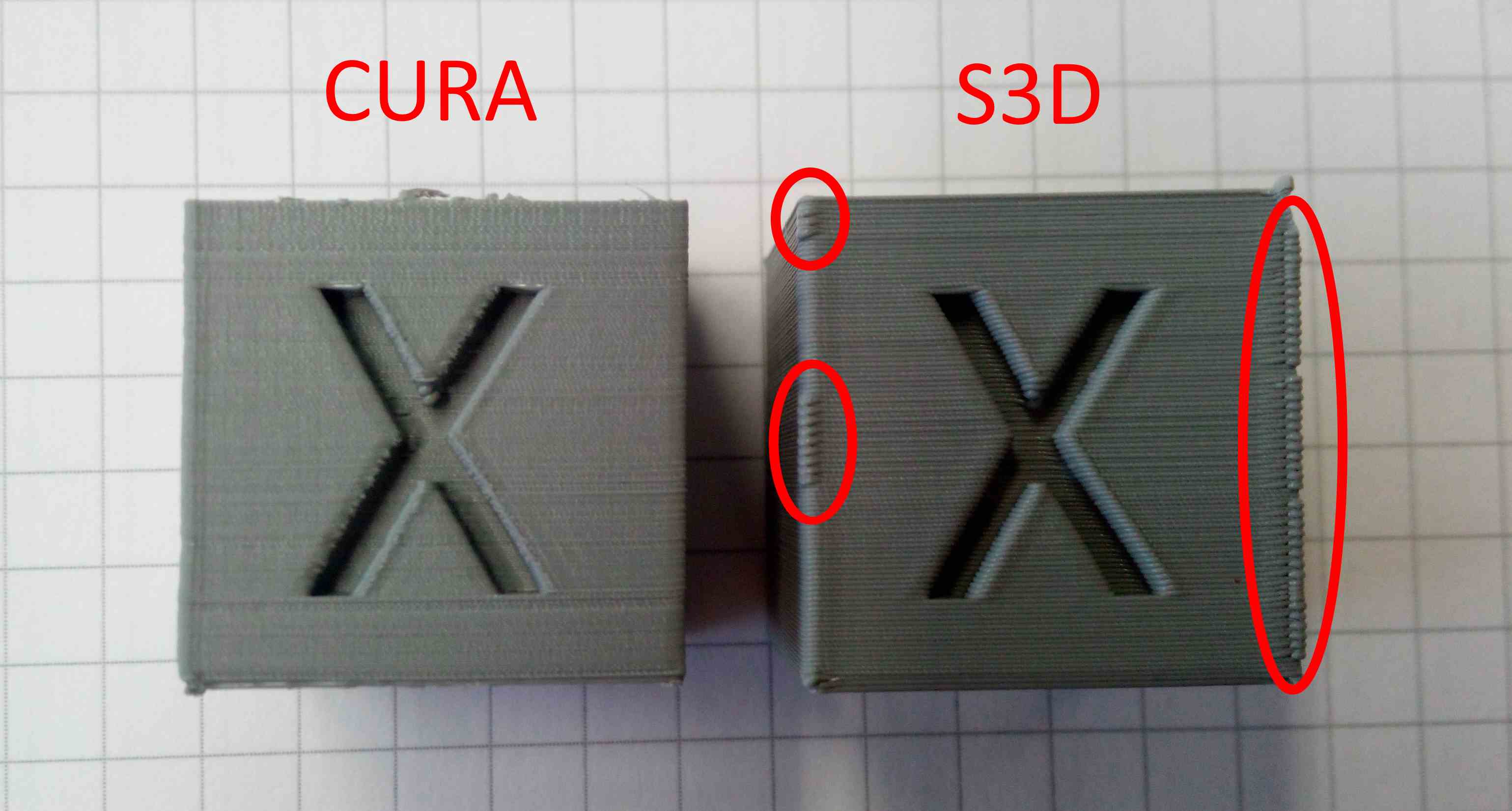

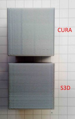

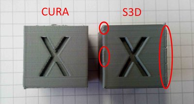

I have a problem with the Slicer settings in S3D and I think I've already changed almost every parameter, but nothing worked.
When I'm printing, for example, the 20x20x20 calibration cube, I get blobs on the surface of the cube. These blobs are caused by the retraction of the extruder. I have changed the retraction distance, speed, acceleration and even the coast distance but the blobs are still there.
Now, I have sliced the calibration cube with Cura (v. 3.2). No special settings, almost the standard settings (even with retractions for every layer). And after the print was done, I had a nearly "perfect" cube with no blobs in my hand. So, it seems that it isn't a hardware problem, but which parameters are different? Has anybody a clue?

I get extrusion blobs on any of my models. And they are not random, they are always there where the retraction ends and the extraction goes further.
Beleave me, my retraction settings are still perfect (e.g. no stringing) and the parameters in both programs are the same. The "Cura Cube" has a perfect surface, the "S3D Cube" has blobs regardless of whether the starting points are on an edge or randomly distributed...

thank you for your help. I have attached a photo and the gcode files of the two cubes and below, there ist a snippet of the retraction gcode. The picture shows the retraction blobs on the right side.
