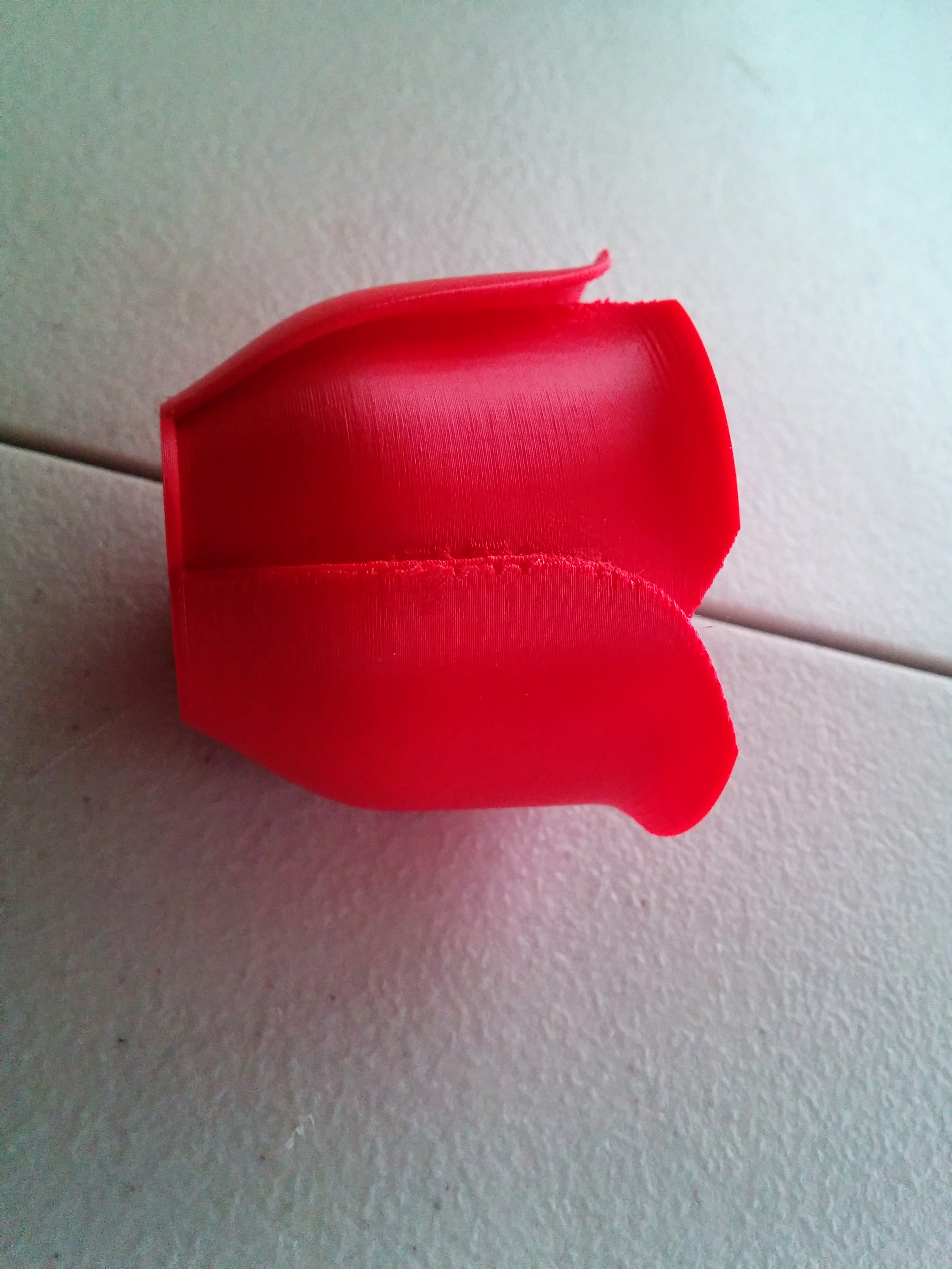

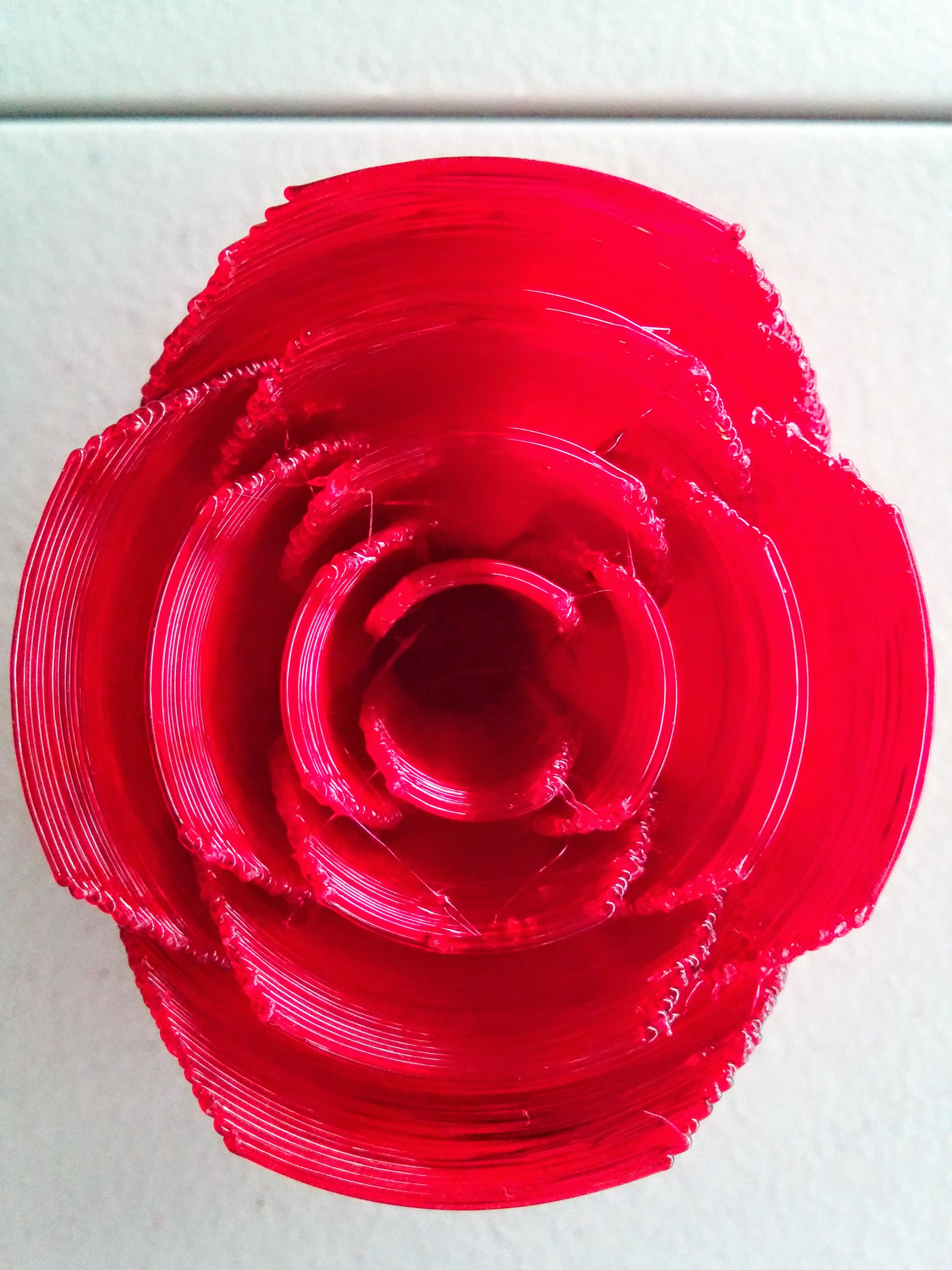

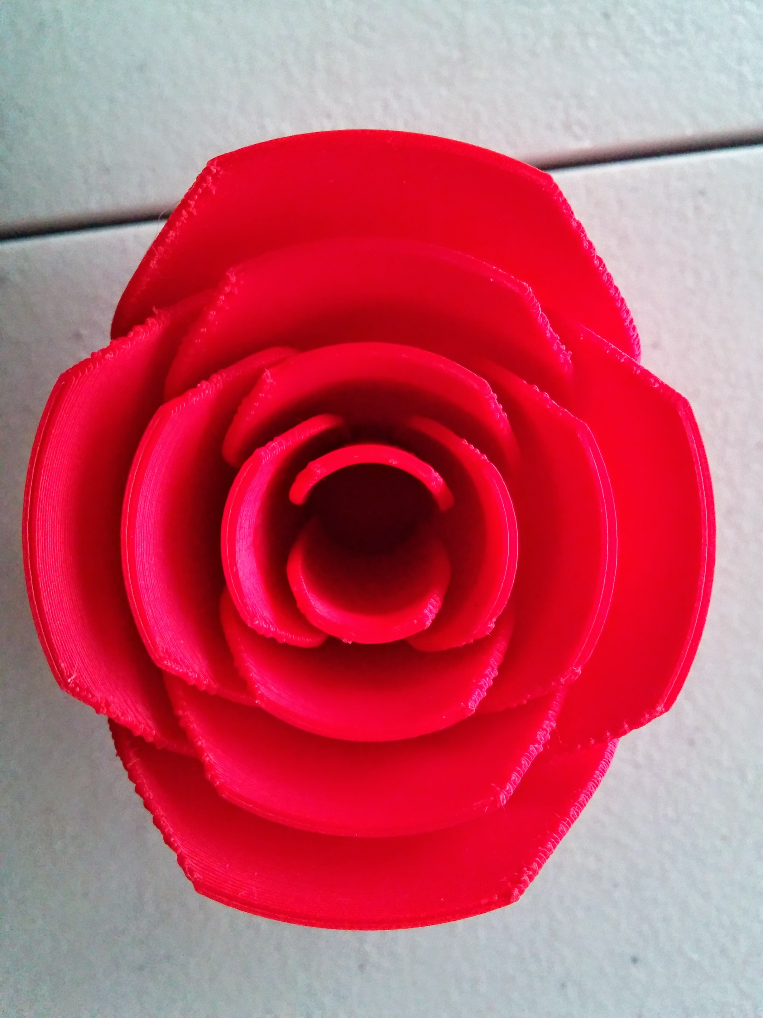

I have included pictures of a rose that I'm printing, one part was printed in ABS and one part was printed in T-Glase. At the start and end of each line there are small amounts of blobs that I am trying to correct. I have tried several different options to fix this but looking or outside advice.
T-glase
T-glase
The line that looks malformed is the optimized start point for each layer.

Your print actually looks pretty good imo. However, if you'd like to prevent any oozing from the idle extruder, one suggestion I'd have is to create a skirt X layers tall. X being how tall your print is. I did this on a dual colored print, and as you can see the white extruder was able to ooze off its excess onto the black extruers skirt. This prevented the amount of blobs I had on my print for the print throughout.
