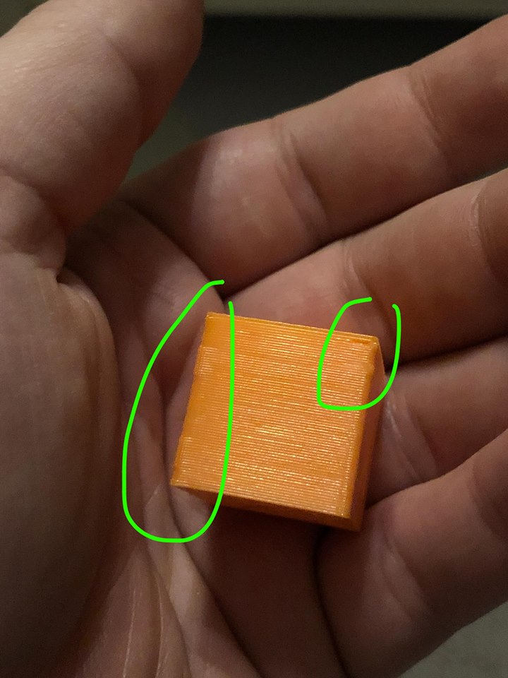

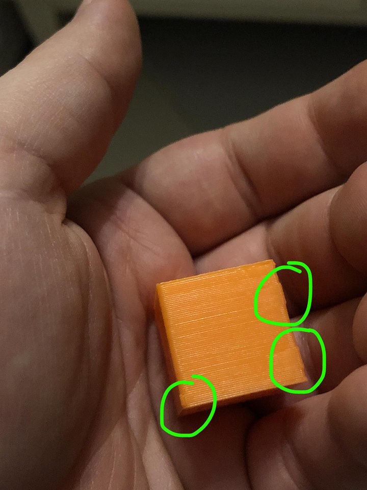

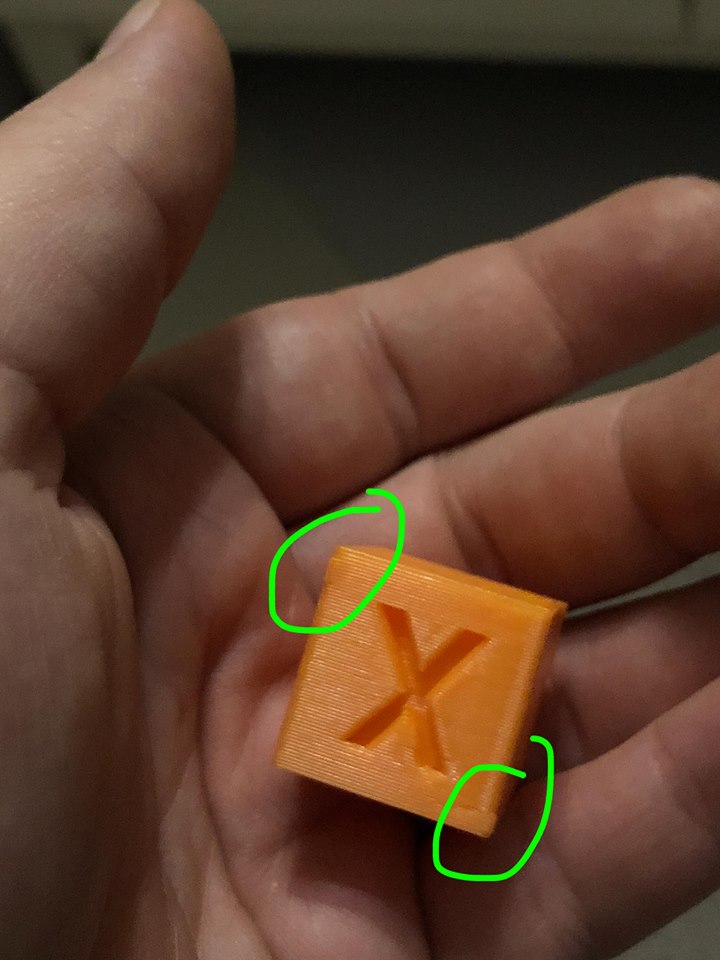

Wow, I am laughing out loud!
I've been trying to fix this exact issue since I bought S3D last week.
It's a great slicer (pre-configured settings are doing fine, supports are amazing), except that I noticed this same issue now.
I'll keep it short and share my Facebook post that I made a few days ago. I actually came to S3D forums because nobody responded to my post on Facebook, thought I should give S3D forum a shot.
Then I log in here, click on "Troubleshooting and Bug Reports", see this post at top, click on it (because the title looks similar), aaand :lol:. I even tried to remember if I posted here previously but forgot, yet the user name is different so it should be someone else having the same issue :mrgreen:.
Anyway, here is my post from Facebook;
Hi there, first post in group! And appreciate the help! Please let me know if there are any specific rules that I should follow before posting (other than being kind to each other).
This problem only occurs with S3D, printing the same STL on Cura (with default settings) is perfectly fine (so I think it shouldn't be hardware related). I use the default (pre-configured) profile for my printer (CR-10) both on Cura and S3D.
Have also read a lot (guides on S3D's site, FAQs etc., and also searched the web for it), tweaked a lot of settings, like;
- Slowing the speed to half (30 mm/s)
- Setting "extra retraction at start" to negative values (as far as -0.5 mm)
- Playing with extrusion rate (1.00 to 0.85)
- Playing with "coasting", "wiping", "z-hop", other retraction settings, etc.
- Actually a lot more, just can't remember all of them but just ask if I tried something and I can tell if I did or not, with which values, etc.
...yet none seems to help.
What I noticed was that those small defects at some corners always happen when the nozzle starts extruding at that point after performing a retraction previously on somewhere else. So, I didn't try vase mode, but it should eliminate them, yet I won't be able to print anyting solid with that.
Will appreciate any kind of help! Thank you!
Here you can see the issue on some corners, but only on corners, the rest of the edge is perfectly aligned with the ones on top and below.
Clearly visible here, the rest of the edge is fine, this only happens in the corners.

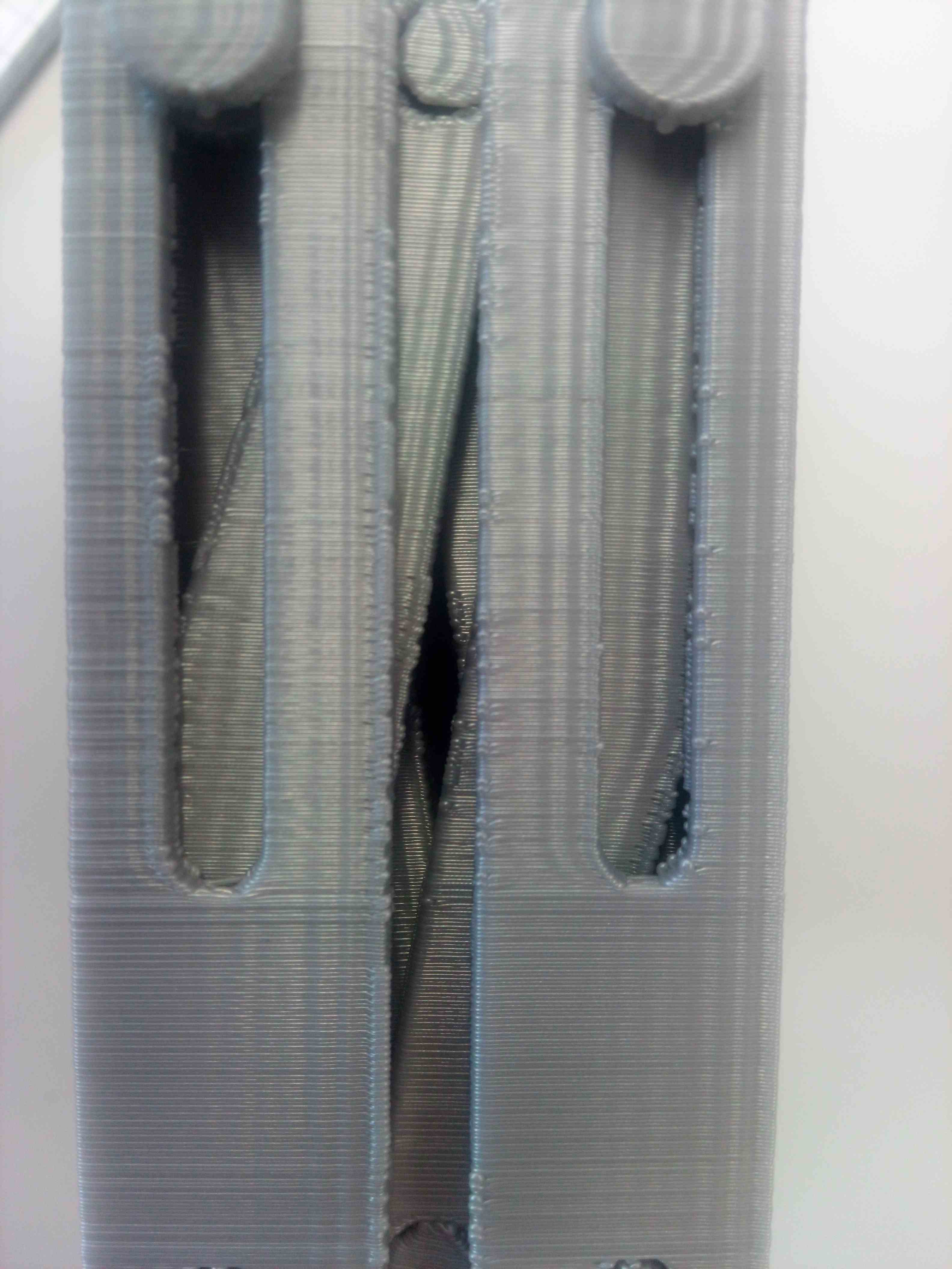

Please excuse my late reply, but my printer had a more serious mistake this week. Since this is fixed now, I can turn back to the "blobb" topic.
I've increased the number of perimerters to 3. The standard cube looks now better (not perfect) so I've dared myself on a bigger model. However, the blobbs reappear. I will print the object again in the next few days with Cura, but I think I already know the result ...
So the problem is not solved for me.
Best regards
deZeus
