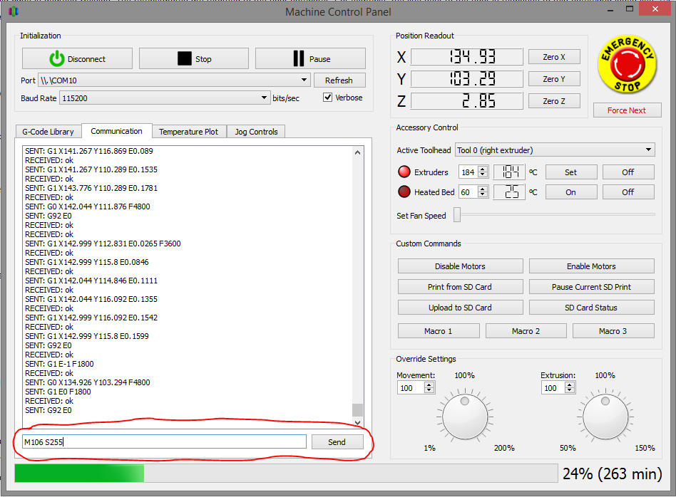

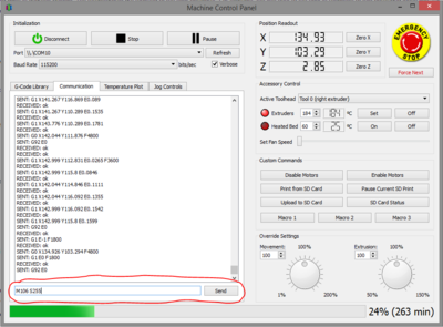

directly sending commands
I would like to send my own commands, like test fan 0 or 1.
I'm guessing this is the SEND line. However, I don't know what the commands are for the fan or anything else. Is there a tutorial that explains the commands?

Re: directly sending commands
Hi, open up the Machine Control Panel, and with your printer connected, under the "Communication" tab you can send in G-Code to your printer.
Here is a list of G-Codes and their functions:
http://reprap.org/wiki/G-code
