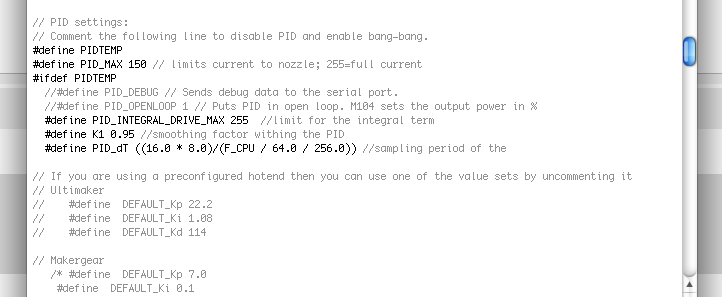

I can't find any max pid temp in the marlin config.. there is just the stuff about bangbang mode etc..
Re: Need a little help with PID tuning.
max pid should be in the config h file

Ahaa, it got confusing for me as you said it would be att 400 original. But i realise all numbers are 8bit.
And my code does not look the same.
But i found it.. I will test diffrent max's to se how it does.
i found that in the communication window in s3d that the feedback for the extruder power you see there is half the # in the firmware. for instance on initial warm up of the hotend it would give me an @200 for the current level. when i changed it to 150 now it gives me an @75.
