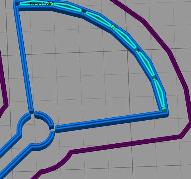

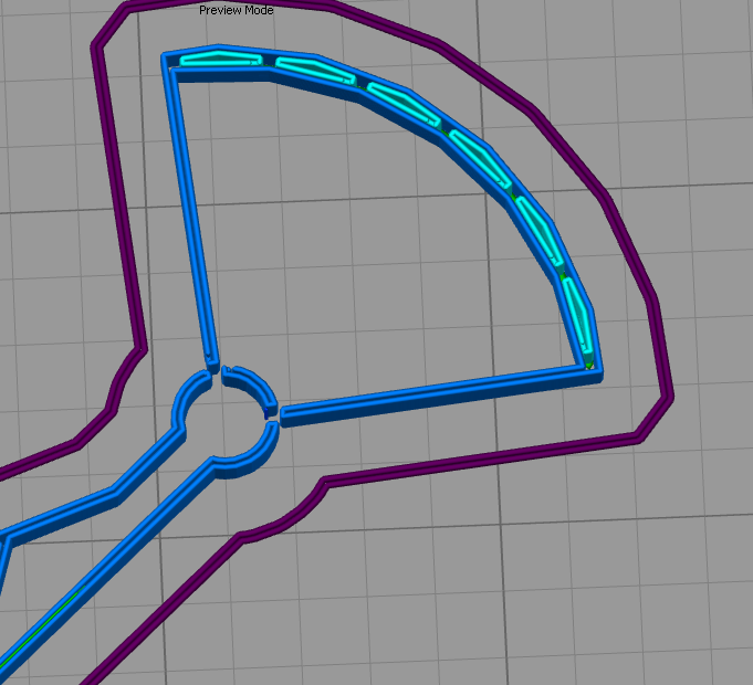

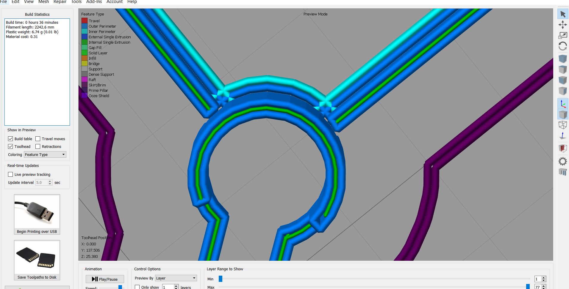

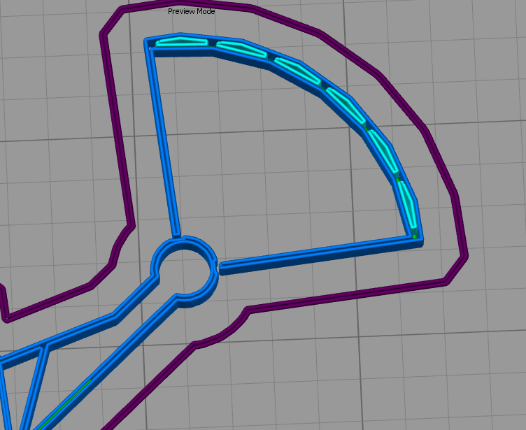

As you can see in the pictures, S3D will not continue the outside layers and/or not fill in the space between them.
I have tried every setting combination I could think of
Shell: Single Extrusion Walls or Perimeters don't matter.
Infill: Perimeters Only, Single Extrusion Walls or Allow Gap Fill, it will still not connect the outline correctly.
Same STL-file prints fine with Cura, even the old version that I have.
Perimeters Only-Perimeters Only
Allow SIngle Extrusion Walls- Allow Single Extrusion Infill
Perimiters Only - Allow Single Extrusion Infill

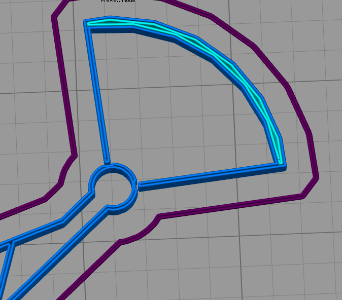

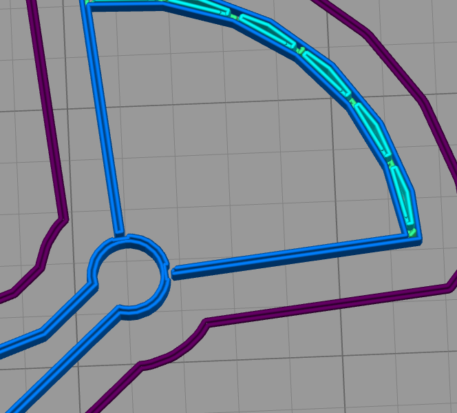

Here are a few more examples.
None of the options I tried would let the parts be connected.
Why won't S3D at least print ONE single complete outline so all parts are connected??

Allow Single ExtrusionWalls-Allow Gap FIll
Perimeters Only-Allow Gap Fill

Can you attach the STL file? From the photos, it looks like there may be some issues with how the 3D model was created. Should be pretty easy to confirm with a copy of the STL file (or you can use the Repair checks in S3D to check yourself)
Re: S3D 4.01 skipping/omitting parts in prints
What would be even more helpful would be to create a factory file......File menu==.Save Factory file......and attach that to a post.
We can then not only see the stl file....but your settings, which will need some tweaking to get a good infill.
I'm guessing that a combination of using the Separate Connected Surfaces option and tweaks to the infill settings will be needed.

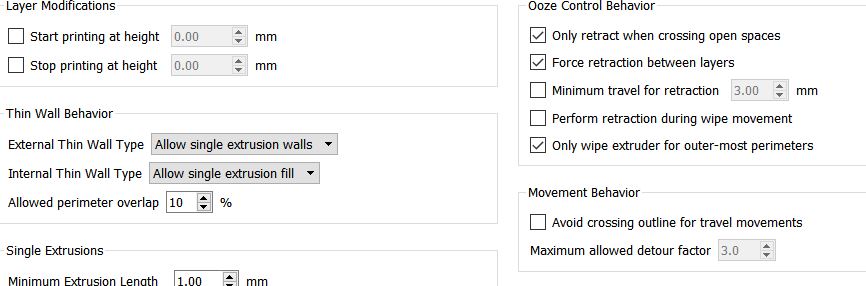

You would need allow single extrude wall and allow single extrude fill.. can also play with the perimeter overlap percentage
Not sure how strong that would be, maybe some issue on how the model was made? Can you post an image of how this looks when sliced but whaterver other slicer you say has no issues?
This is with the above settings using v4.0.1

If looking at the stl in Meshmixer or running some Repair_detect in S3D you see error in the stl. Maybe that is the real problem.
