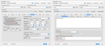

The G-Code tab has commands that make this much easier. Forego the replacing of Retraction commands that can sometimes use different speed values and throw off the replace command. Simply use the G10 and G11 in the start script in replacement of the retractions and primes. Then use M101,M103, M102 commands as triggers for replacing them with G11, and G10. See example below that I use for my Rostock Max v3.
Firmware Retract / Prime M101,M103,M102
