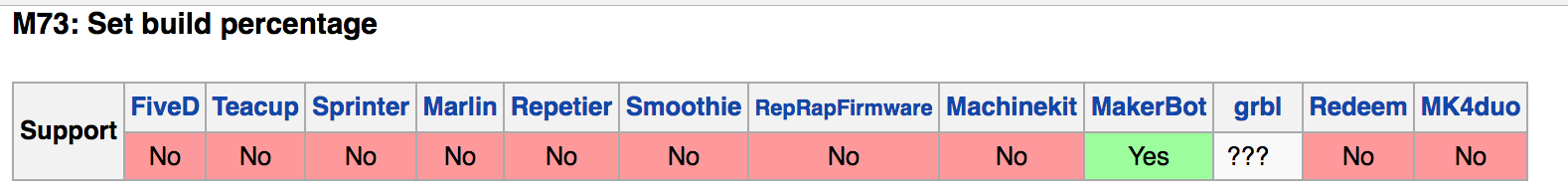

What printer do you have? It clearly lists on that page that this command is exclusively for use in Makerbot firmwares.

it can be actually supported by number of firmwares, for e.g. to enable M73 in marlin in Configuration_adv.h enable LCD_SET_PROGRESS_MANUALLY:
Code: Select all
// Add an 'M73' G-code to set the current percentage
#define LCD_SET_PROGRESS_MANUALLY
