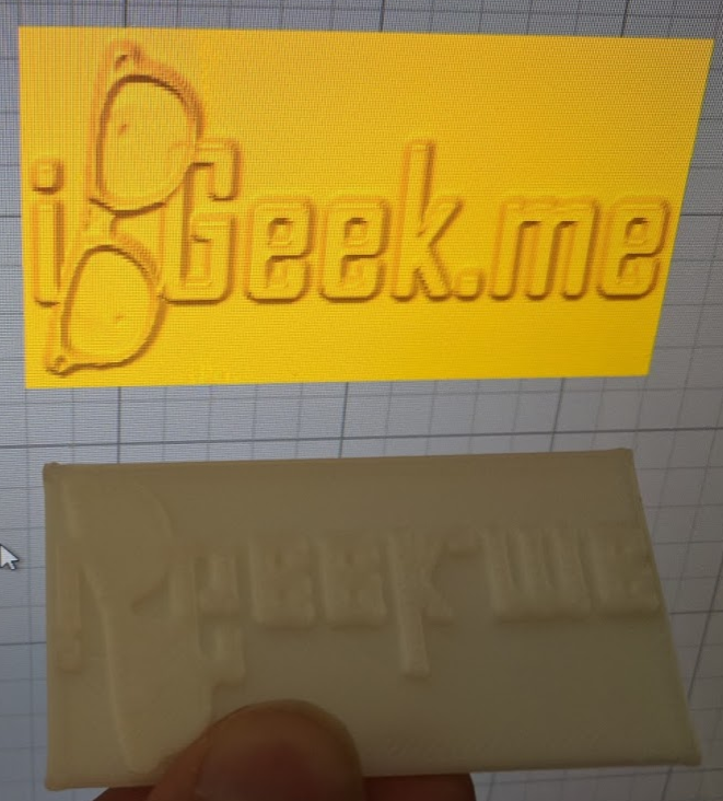

I have an image that I used the plug-in to convert in to a print.
The issue is that it prints the text upside down and backwards.
The preview looks perfect and it prints correctly on my anet A8.
I'm using the stock CR-10 configuration.
Inverted and reversed text

Go to Help > Configuration Assistant and re-download the stock CR-10 profile. I use that same profile with my CR-10, so the directions it configures by default are definitely correct.
If your printer is still going the wrong way, then you post likely have one of the motors wired backwards or a problem with the firmware setup on your printer.

Turned out to be the latter. Being the newbie that I am, I thought I was helping myself by labeling the axis. So when it was suggested that I had X and Y reversed I looked at my labels and they were right. Unfortunately I labeled them wrong. :/
Long Embarrassing story short, it's resolved. Thank you for your response.
