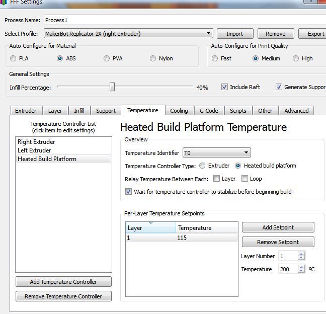

I've set as follows, but my build platform will not get to temperature. It's not a faulty heater, it just never thinks it has to heat. Using Makerware generated code works just fine. I know I'm probably missing something very simple...

can u post a picture of the scripts tab please?

since this was my first post i couldn't edit it right away. I found the problem shortly after posting. When I ran setup I used Replicator 2 as my default device, so when printing on my rep2x, the x3g tool didn't have the heated bed box checked. Problem solved!
