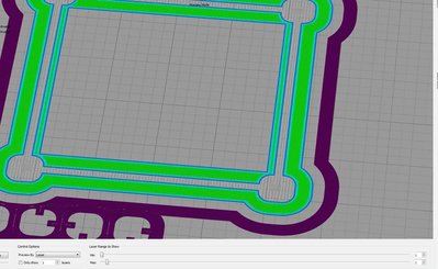

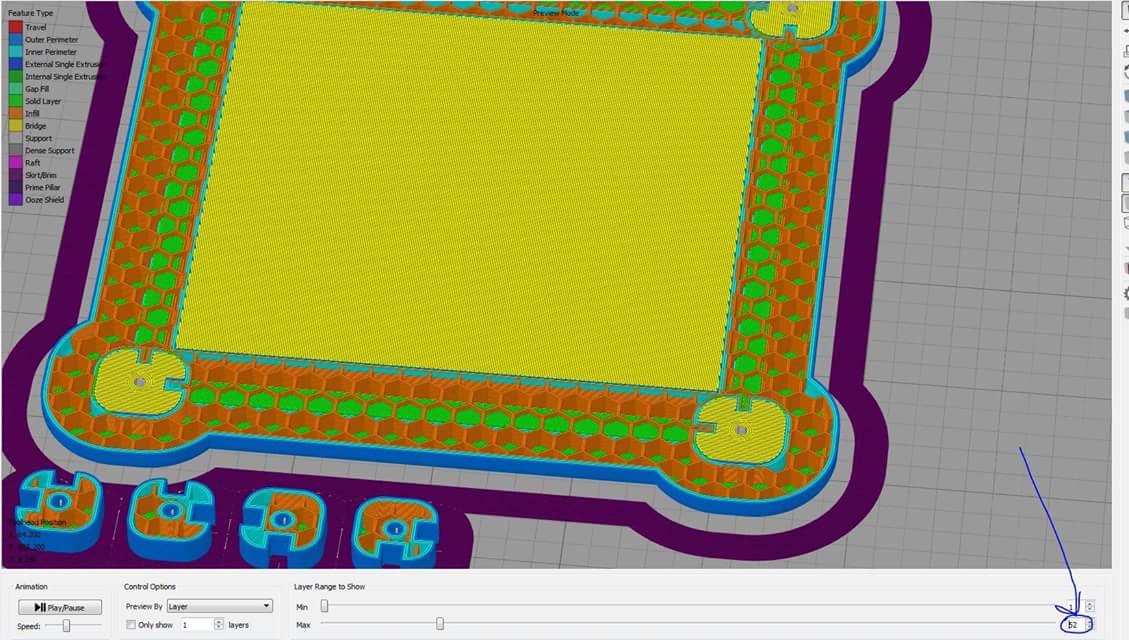

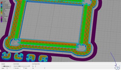

Good evening, I have to print this model made by me in Fusion 360. As you can see the inner pillars supports don't start to be printed from layer 1.... the outer pillars, instead, starts from layer 1...it is not just a preview issue, I've checked the gcode with a viewer... what's wrong?

Any chance you can attach your factory file. Its difficult to be able to diagnose from just three screenshots...….
