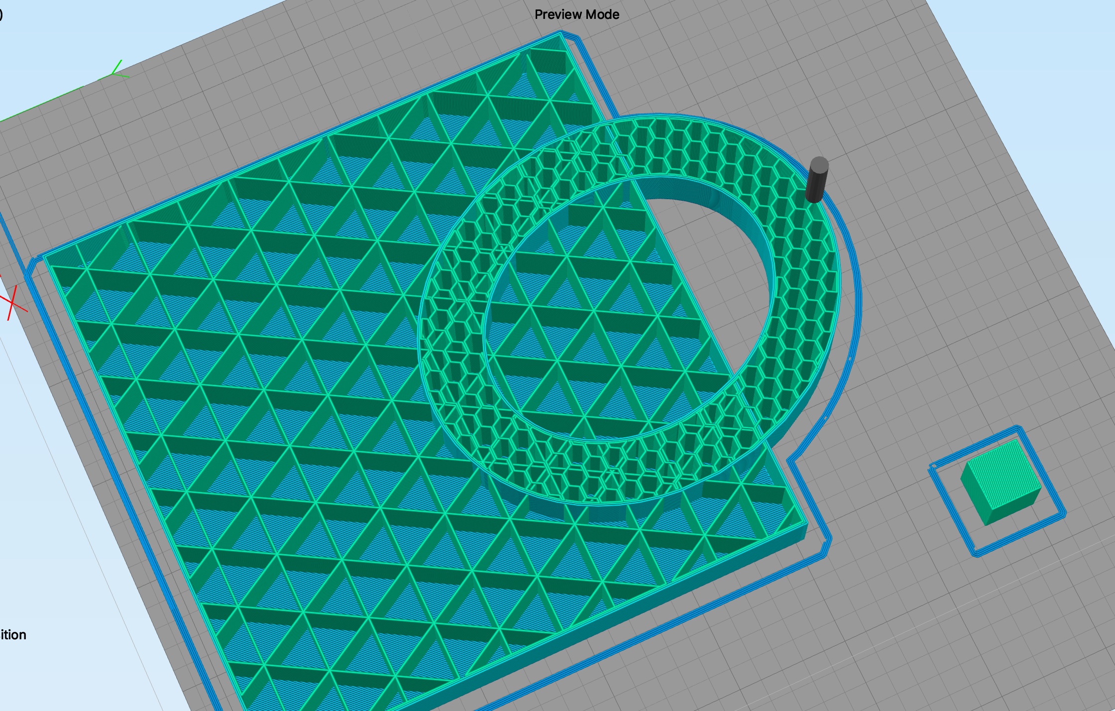

In Cura I can use Infill Mesh to print to separate mesh files with completely different settings and they will print autonomously. In S3D I have tried both the dual extrusion wizard and using separate processes for each model but neither accomplishes what infill mesh can do. Am I missing a setting or is this feature missing in S3D completely? Using dual extrusion wizard the color group forces the same infill and shell settings (I do not want) and using 2 separate processes for each mesh just prints them completely overlapped such as this....
