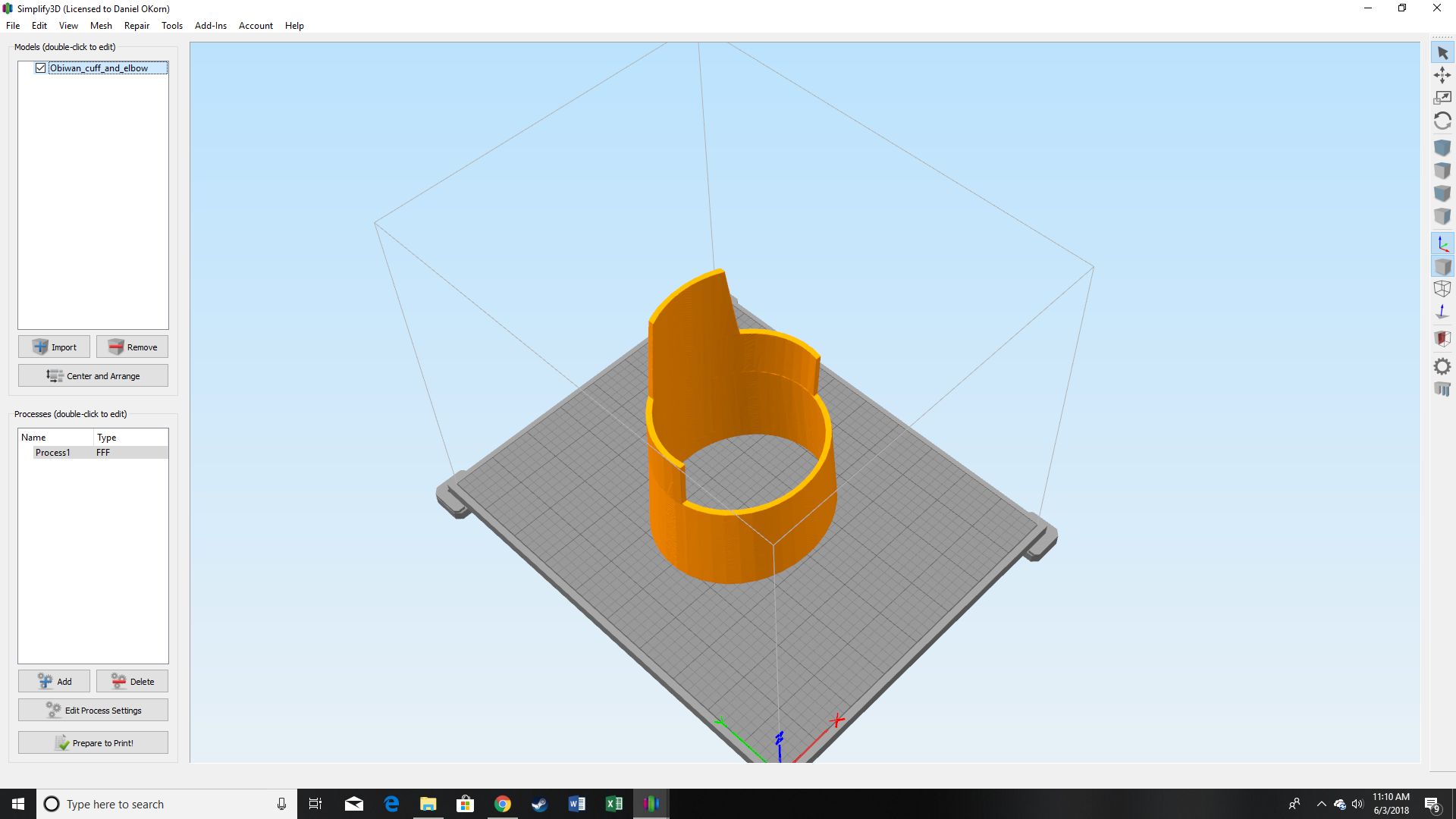

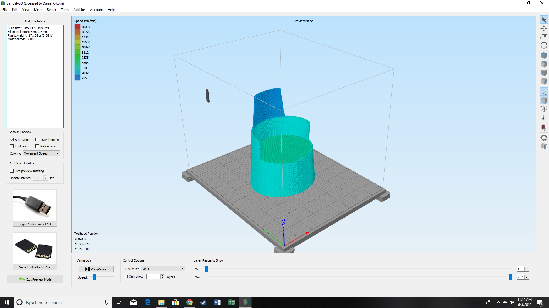

I am encountering an issue I've no clue how to remedy. My model is an arm cuff and for some reason the middle keeps getting automatically filled. Does anyone know what I can do?

Did you already run the repair checks in S3D to look for non-manifold or self-intersecting surfaces? If it finds issues, there may be a problem with the model.
You should also check the Advanced tab to make sure you have the "merge all outlines into a single solid model" option disabled.

I've checked the model with 3D builder and Makeprintable.com and its come up that the model itself it fine. This isn't the only model this has happened to both downloaded and custom created files have been doing this. I think its a problem when the model is being sliced.

Why don't you attach the STL file?

Have you verified the setting on the advanced tab that RR suggested? It is very common to have this setting enable by mistake.

i was having that problem when i had merge all outlines into a single solid model selected, FFF Settings > >Advanced / Slicing Behavior

It was slicing behavior that seemed to be the issue! I toggled with those settings under the "advanced" tab. Thank you all! I really appreciate anyone who took the time to provide any assistance!
