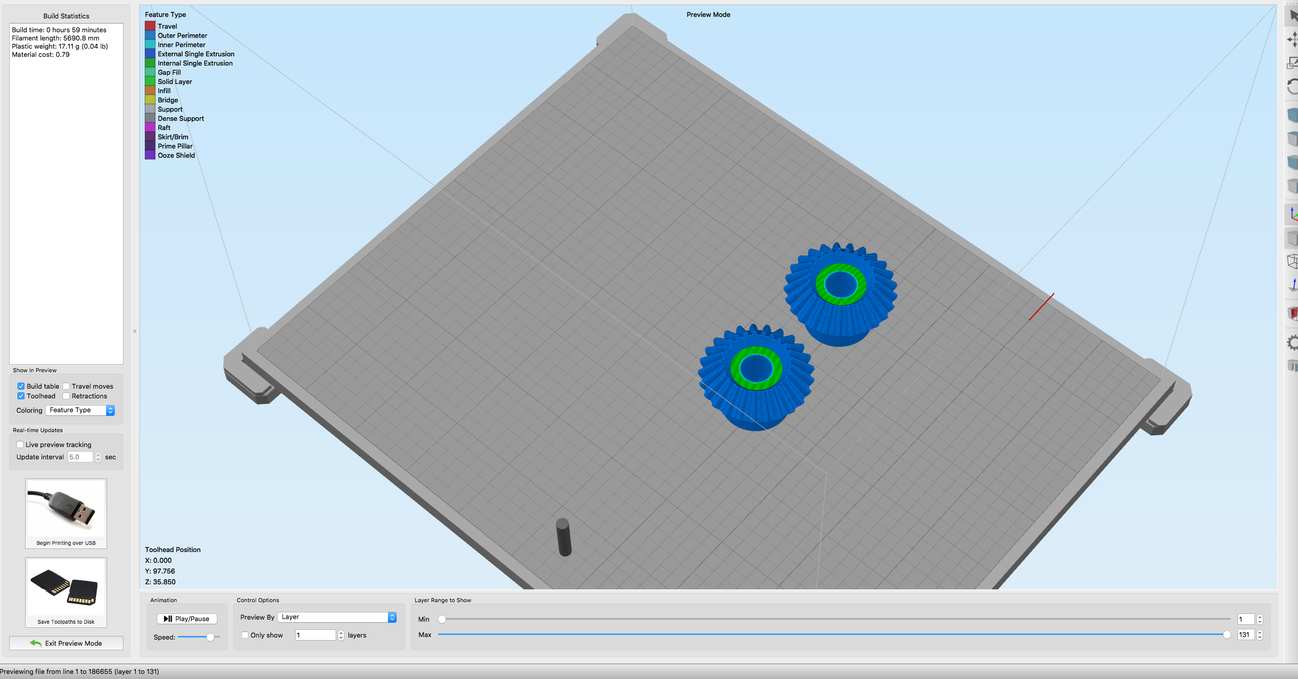

Here's what I get when I slice a single copy of the part.

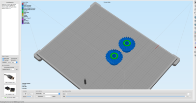

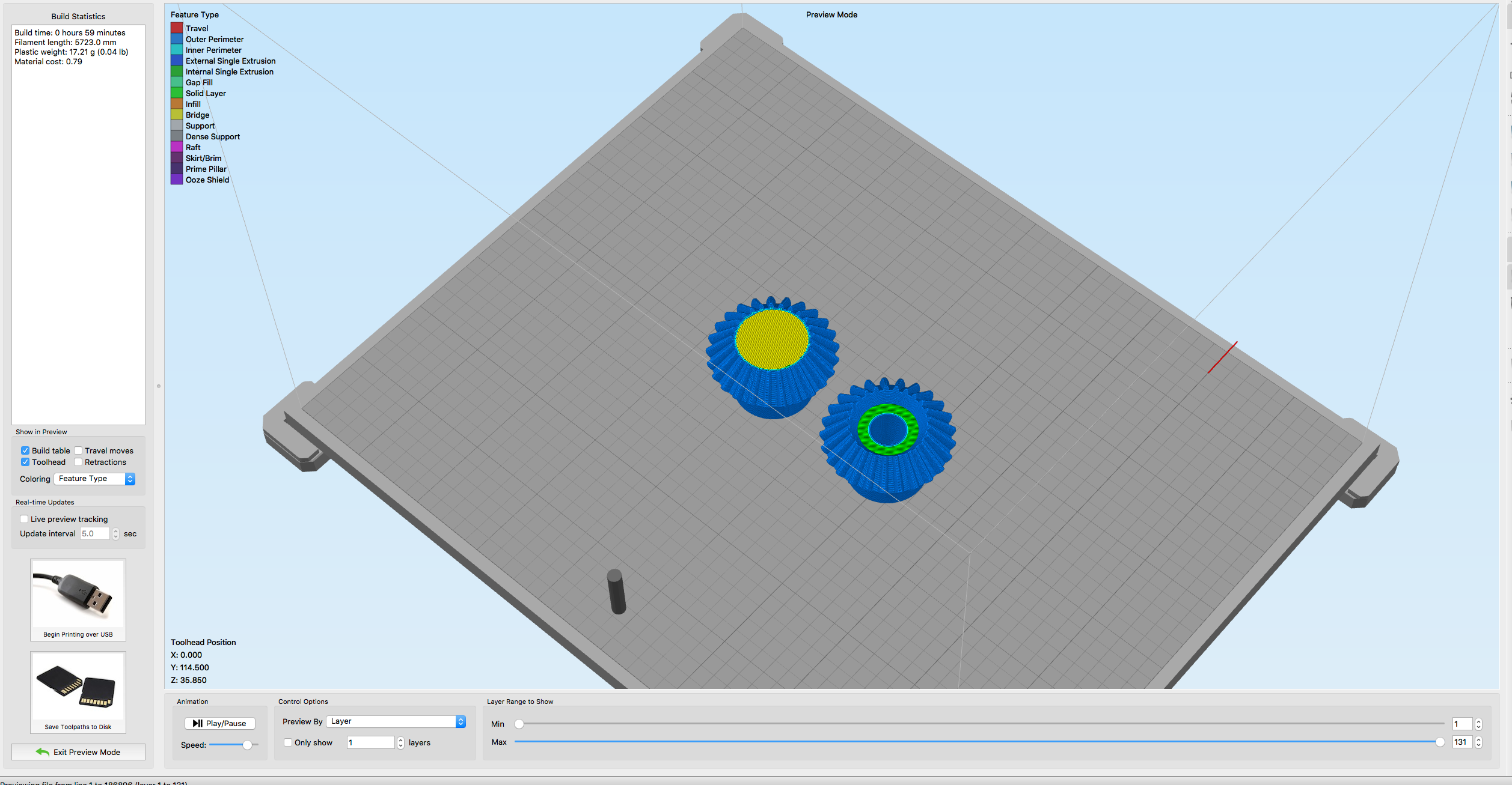

Here's what I get when I drop a 2nd part onto the build plate OR do a copy and paste of the part and do a centre and arrange

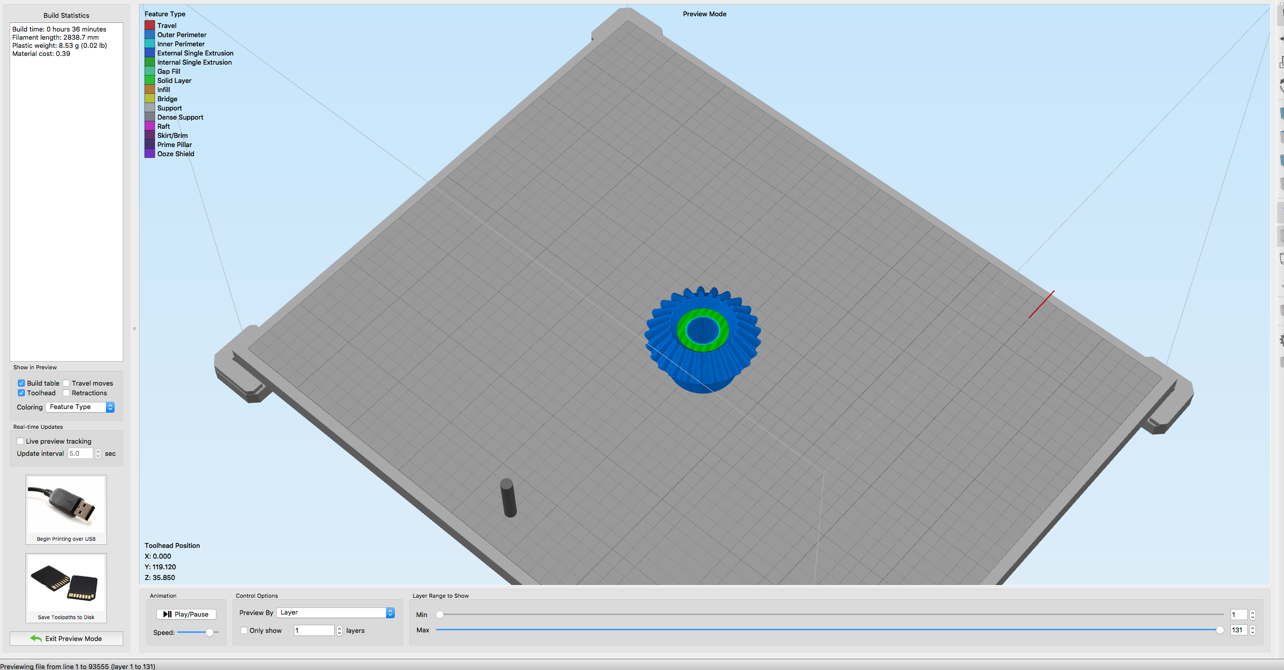

Here's the only thing that works... copying the part and pasting it while in simplify 3D and NOT doing a centre and arrange.

Try adding or subtracting a value of something like 0.000001 from the layer height and see if it helps.
Also make sure both parts actually are setting on the bed.
What does the first layer look like in the preview mode? Look normal?

In reply to wirlybird... minute adjustments to layer height have no effect... and yes, the first layer height looks fine.
To dkightley... thanks for the repaired shape file... what did you do to repair it?
I did a bit more looking around and see that at least historically S3D has had problems with unwanted bridging which is what this appears to be... and although dkightley has provided a repaired file, to my way of thinking this is clearly a bug in simplify3d... in that if it can slice a single copy of an object correctly it should be able to slice multiple copies of the same object on the same bed correctly. Maybe they'll get around to doing something about it in the next release.
