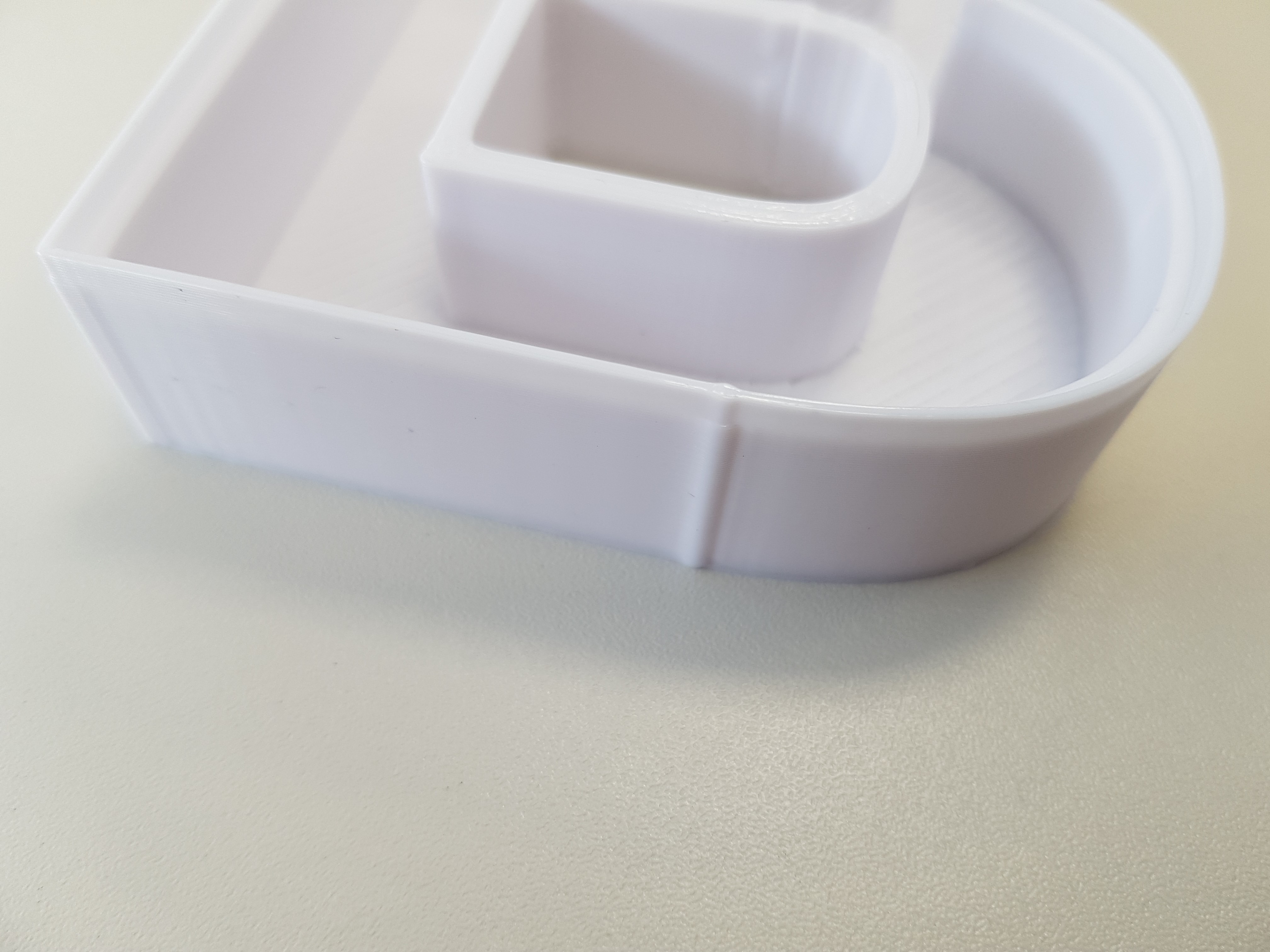

on this particular object I have the problem that the printer stops at some point for no reason and creates a blob meanwhile. After printing the skirt flawlessly the printer starts printing the outline of the "B". 95 % of the way around the outline just before getting from the straight bottom line to the lower curve the printhead stops and stays in place for a fraction of a second. However, this is enough that a blob forms underneath. the printer only does this for the 3 outer lines of the B, with the inner ones there is no problem. Any ideas on what might cause this issue and how to resolve it? I tried running the same process on a different model and theres no such problem, so I figure it must be related to the model, but I can´t see how. Please help!

I made a picture of the printed letter. It looks familiar with the Z-scar, but it´s not. I can´t see anything in the print-preview that hints at any abnormalities...
Yeah, I will try reslicing, maybe that helps.

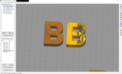

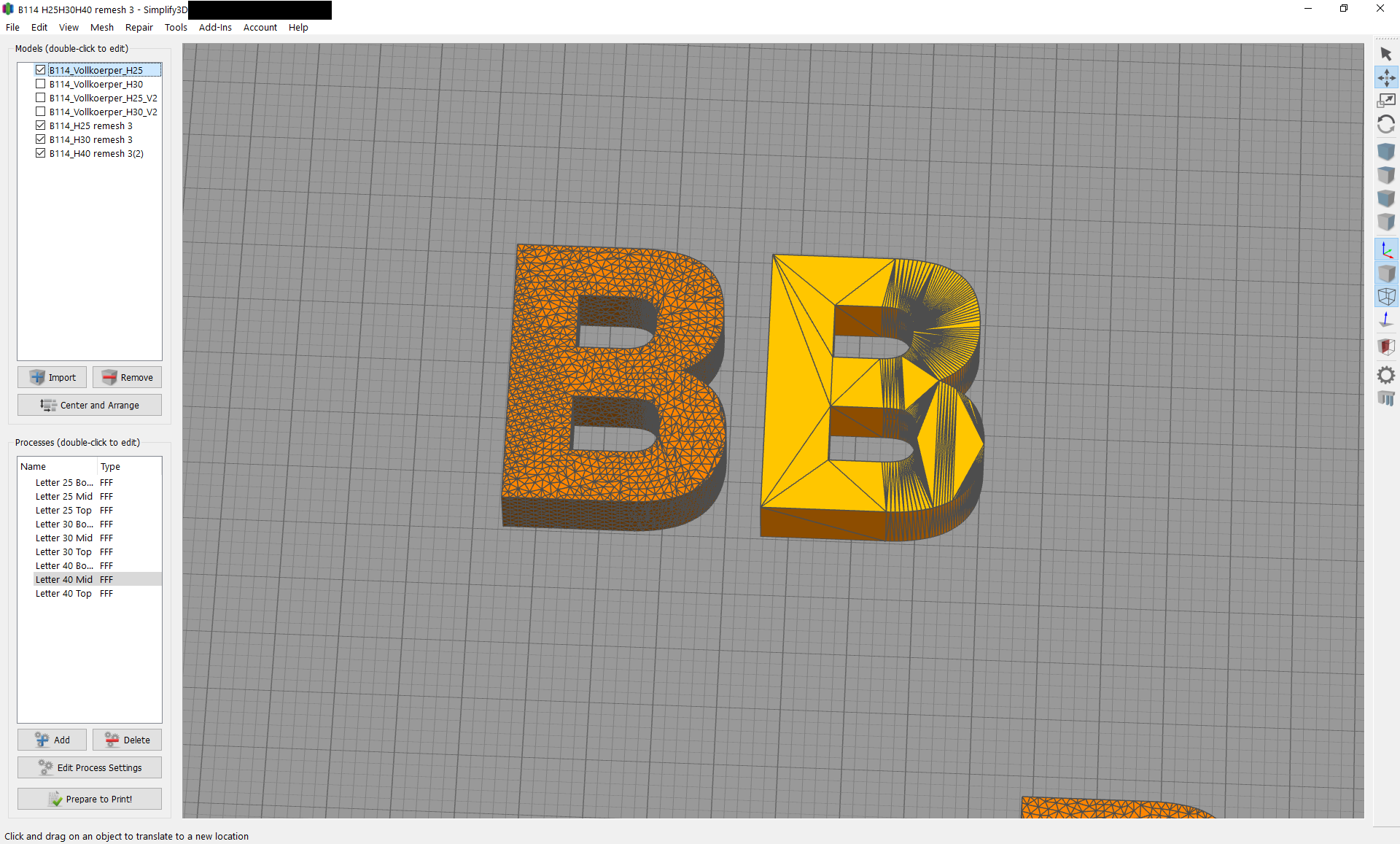

Turns out there is a problem with slicing/meshing. I tried reducing the number of triangles and I was successful in removing the blob-scar. However, the form of the letter suffered from this procedure even at very moderate triangle reductions. So I loaded the stl into meshmixer and remeshed it to a much larger amount of triangles. The bad sections which were probably the root cause of my problem still remained so I reduced the triangle count while retaining the outer boundaries (=shape of the letter). That way I received a mesh that was full of small triangles (see picture) which works very well for me now.
