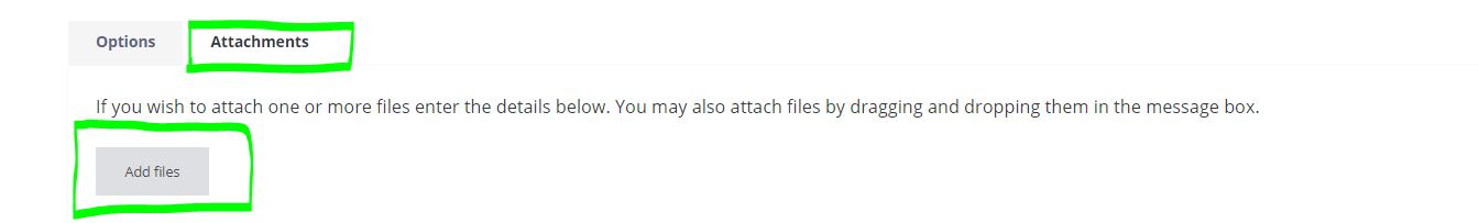

To save your Factory File go to File > Save Factory File As... then you can upload it to the forum by going to the Attachments tab > Add files. This should be located under the text box.

1hander
Posts: 11
Joined: Sat Feb 24, 2018 1:10 pm
Re: not sure what is causing this ..
thank you so much for that help, i just dont know how to use the forum because i never need it, because the product just works so well.
