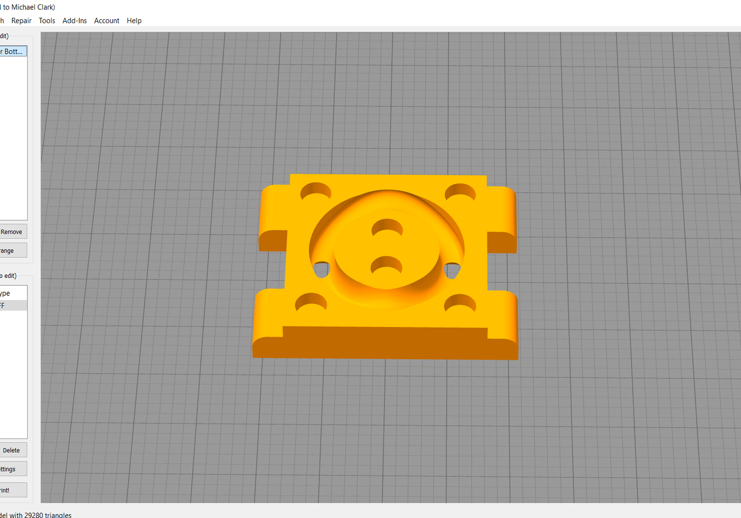

Hello all,
I have a print that's quite large and I only require detail at the inner parts of the model. Problem is that the area I need greater detail is from bottom to top which requires I have to have a lower layer height for the whole model. The image will give an idea.
I was thinking about making a separate piece and have the higher detail piece be able to snap into the outer piece but if I can solve this in an easier way that would be awesome.
Thanks for the help!

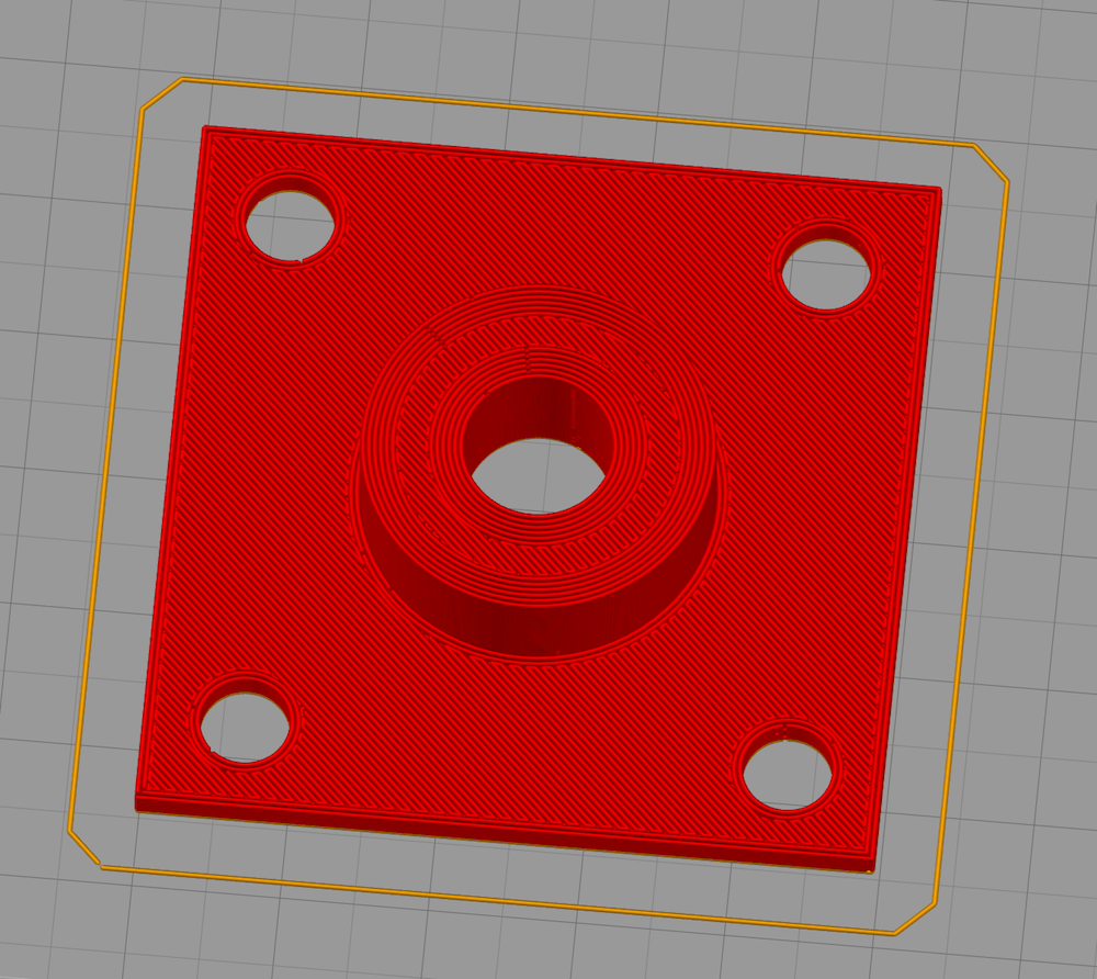

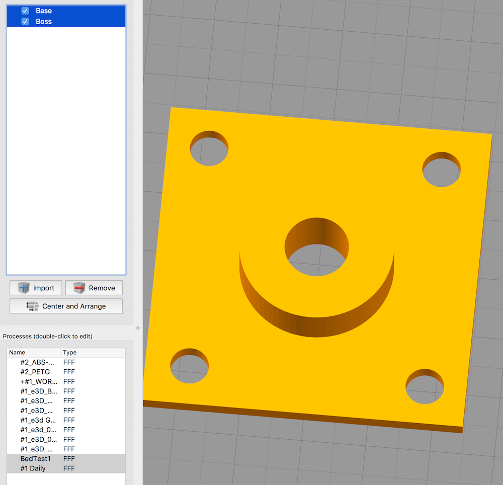

Another approach - the one I use...
But, it requires making your part into two separate parts: One for the inner section and one for the outer section.
One way to do that (if you're not CAD skilled) is to cut a hole inside (leaving only the outer section).
Then, cut the outer section, leaving only the inner section.
Load them into s3d but, don't Auto Center/Arrange (turn Auto center off in Pref's)
Then use two processes.
Example shows a Boss on a mounting Plate.
The Boss has 5 shells (for threading with a Tap) and 3 layers.
The Plate has 1 shell and 2 layers.
I do this quite often

greybeard wrote: Fri Oct 05, 2018 3:12 pm Another approach - the one I use...
Oh very nice - I can certainly do what you're describing using Fusion360. I'm guessing the two parts will merge so long I have the printing mode set to continuous printing (layer by layer) for the separate processes? Thank you for your time - I appreciate your help!
