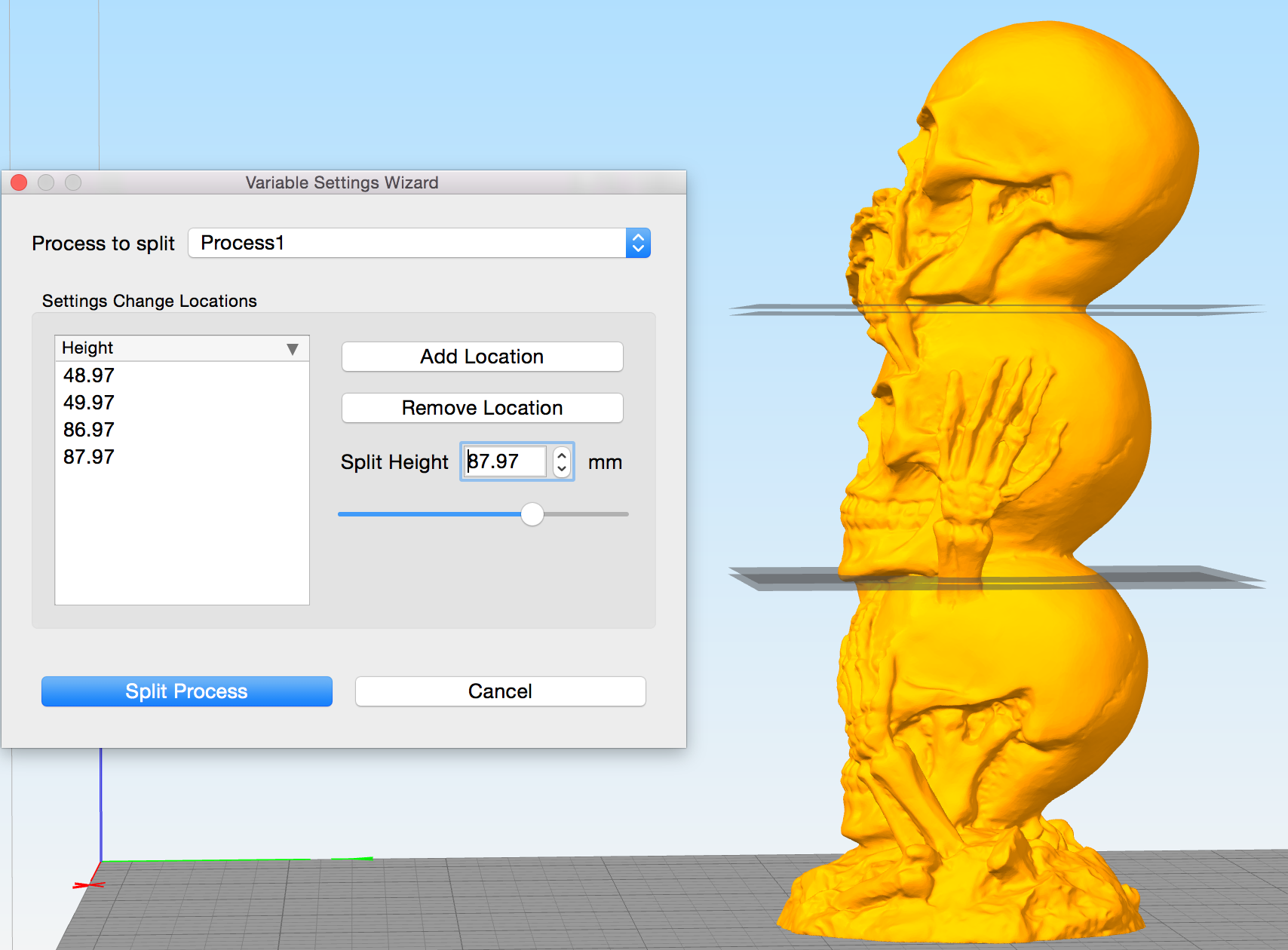

As of version 4.0.0 this no longer functions as DarthRevan had implied. Between processes you will not see top and bottom solid layers inserted between the processes. You can still create a situation where this happens though.
Variable settings wizard can be used to setup the processes (You'll need a process for the area where you want solid layers). Then use solid diaphragm every X layers to insert solid layer(s) every layer of that transition process.
Take the popular model from thingiverse "three wise skulls" and say we wanted to insert solid layers between each skull for more stability where it gets thinner. We'd need to identify the top and bottom of the transitional area where these solid processes would be placed. I've chosen 48.97 : 49.97 and 86.97 : 87.97.
The results of these setpoints will render a setup with 5 processes 1-1 : 1-5 processes 1-2 and 1-4 should then be set with the infill setting Solid infill every X layers enabled and set to every 1 layers. These processes will then be entirely filled solid for those layers creating a filled transition rather than a "seamless" one.
Thanks very much for the reply. I ended up doing it this way. It would be nice to have the ability to insert solid diaphragm at specific layers in addition to being able to insert them every so many layers or have the option to print top and bottom layers on a process with a simple check box to do so.
