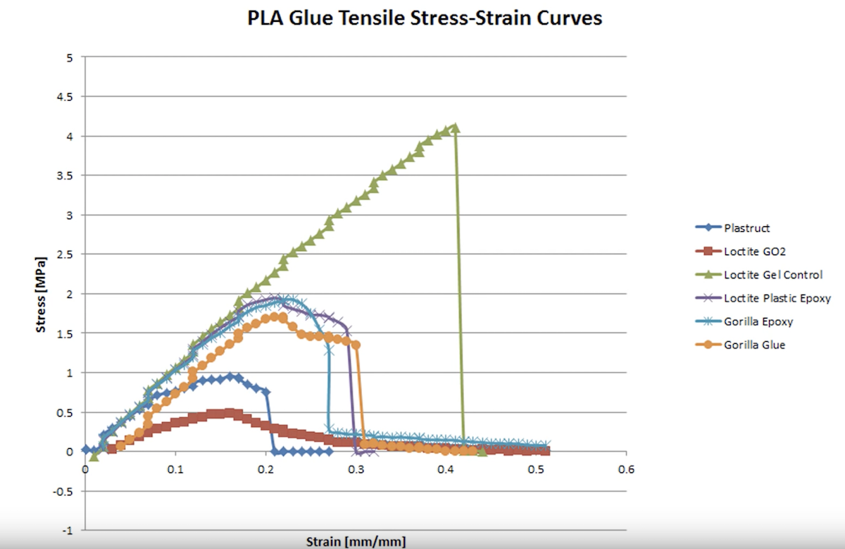

I did some stress/strain testing some time ago and compared the results with a Youtube on glues for PLA/etc. I'm sure the video is still posted...
My results were similar to the those in the video. Screenshot (of video results) shows Loctite Gel Control to be stronger than others... I used it on my motorcycle fender and it's still holding :D
