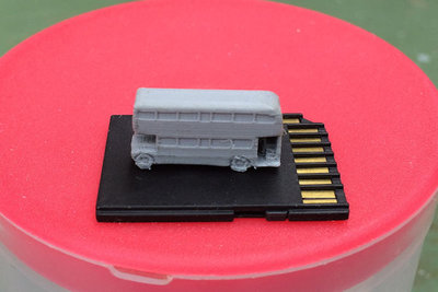

And I wouldn't call what your printing here small. Small is my speciality.....here's an example photo'd straight off the print bed..in need of minor cleaning up!
The SD card is real!
