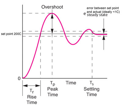

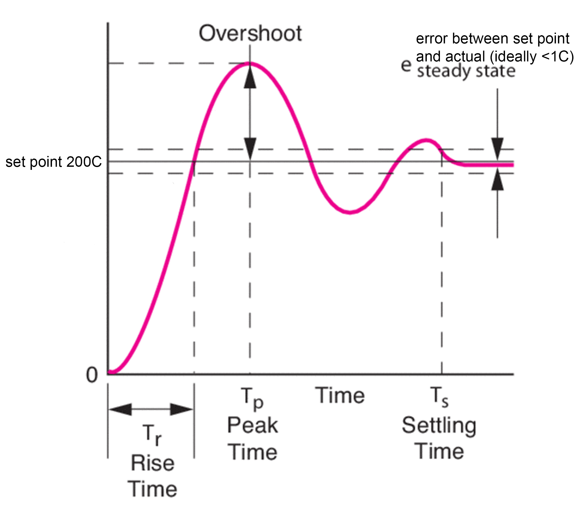

Regarding your question about what PID actually is--necessary if you are doing manually tuning or you will just spend hours randomly changing values until you get lucky. Proportional-Integral-Differentiate is a very popular control algorithm used for closed-loop systems. Closed-loop means that the system (i.e. motor, current driver, etc) wants to do something (move, heat up, etc) and needs some way to monitor that progress so the system knows when it can stop/start a process. In this case, you have a MOSFET that will supply current to the heater cartridge in your nozzle and the themistor will provide feedback on the progress of the heating. When you first heat up the hotend, the MOSFET should provided about 3.3 amps of current (assuming 12V printer with standard 40W heater cartridge), and the temperature will rise. Now, how does the MOSFET know when to stop supplying current to halt the heating process? Should it go from sending 100% current to 0%? Or does it need to gradually lower the current, and if so, how gradually? These questions are answered through the PID tuning curve. The curve is dictated by 3 values (also see plot attached)
Proportional Control (Kp)
Proportional control multiplies the error signal (the difference between actual and desired position) by a user-specified gain factor Kp and uses it as a corrective signal to the system. The effective result is to exaggerate the error and react immediately to correct it.
If Kp becomes too large, the thermal system will begin to overshoot, and at some point, it may begin to oscillate, becoming unstable if it has insufficient damping. Kp cannot completely eliminate errors; however, as the following error, e, approaches zero, the proportional correction element, Kpe, disappears. This results in some amount of steady-state error.
Integral Control (Ki)
Integral control accumulates the error signal over time, multiplies the sum by a user-specified gain factor Ki and uses the result as a corrective signal to the thermal system. Since this technique also acts upon past errors, the correction factor does not go to zero as the following error, e, approaches zero allowing steady-state errors to be eliminated.
The integral gain has an important negative side effect. It can be a destabilizing factor for the control loop. Large integral gains or integral gains used without proper damping could cause severe system oscillations.
Derivative Control (Kd)
Derivative control multiples the rate of change of the following error signal by a user-specified gain Kd and uses the result as a corrective signal to the thermal system. Since this type of control acts to stabilize the transient response of a system, it may be thought of as electronic damping.
Increasing the value of Kd increases the stability of the system. The steady-state error, however, is unaffected since the derivative of the steady-state error is zero.
So to address your issue, I would first try to use the values in the link above and see if you get lucky. If not, I would first increase Kp and see if that helps decrease the amount of time it takes to reach the set point, take note of how much it overshoots, like I mentioned earlier 5 or so degrees is ok. But you don't want it going 20C higher than set point. Then watch how it settles to the set point, does it go lower than the set point? If so how much? And does it quickly return to the set point if it goes too low? If it goes above the set point by less than 5C, but drops below by more than 5C, then I would increase Ki, so the high/low swing of your temperature is about equal around your set point. Then if it's oscillating around the set point, the Kd adjustment can help stabilize the reading. Wiki has some practical technical info on PDI tuning here
