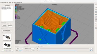

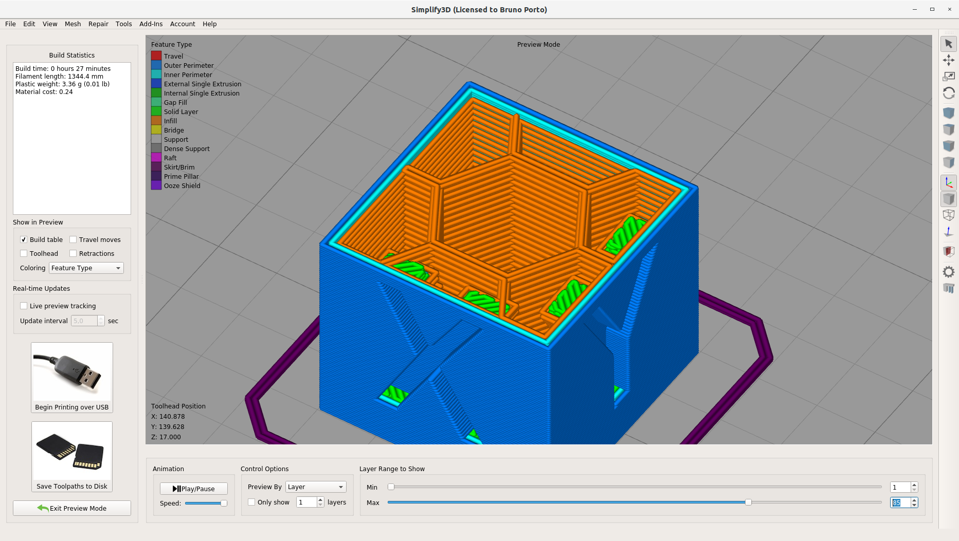

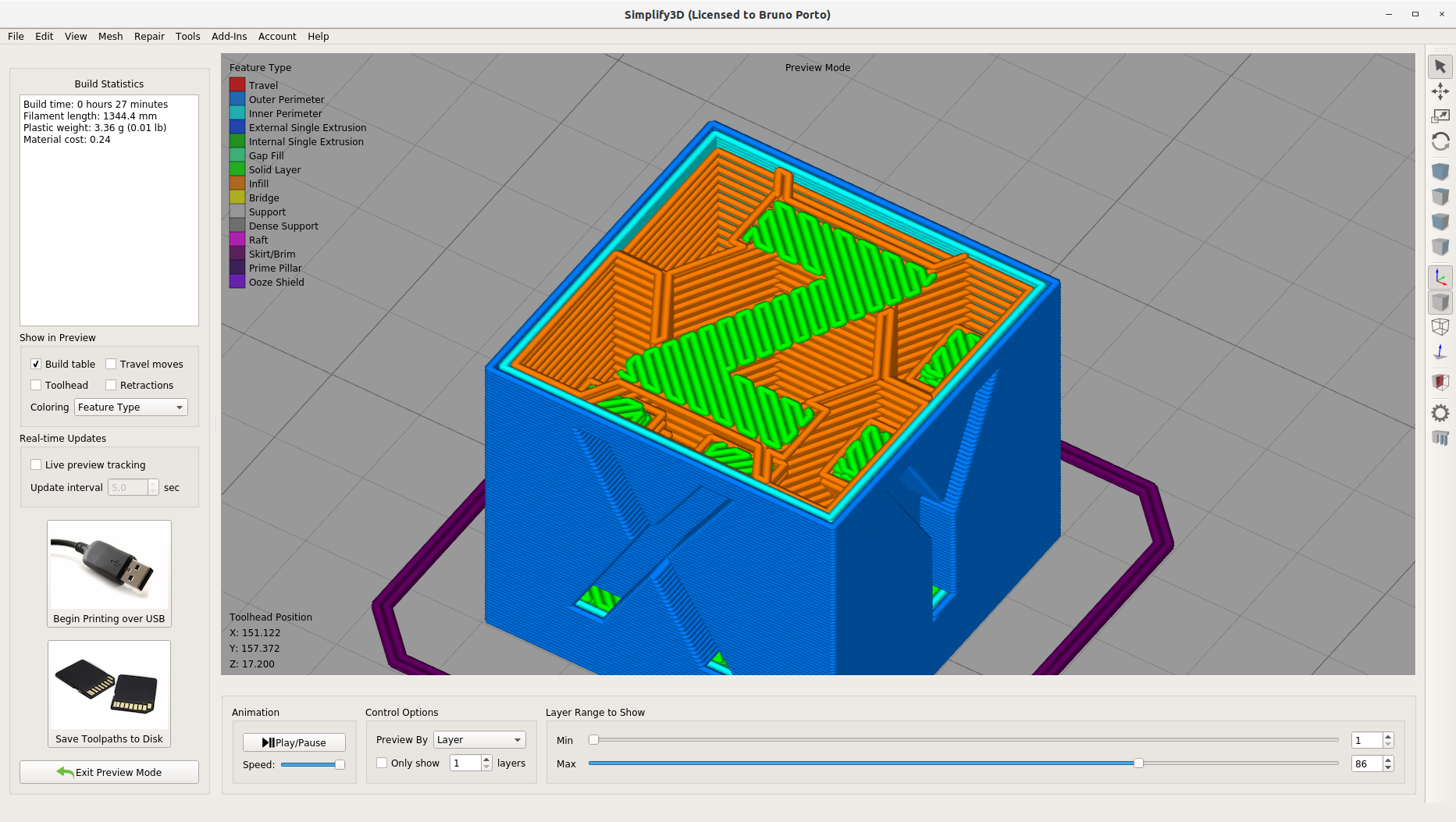

S3D 4.1 - Still putting solid layers over air....
This is an old issue for me :D
screenshot
screenshot
And then the first solid layer.....
Screenshot
Screenshot
The first solid layer must go up to the infill borders at least.

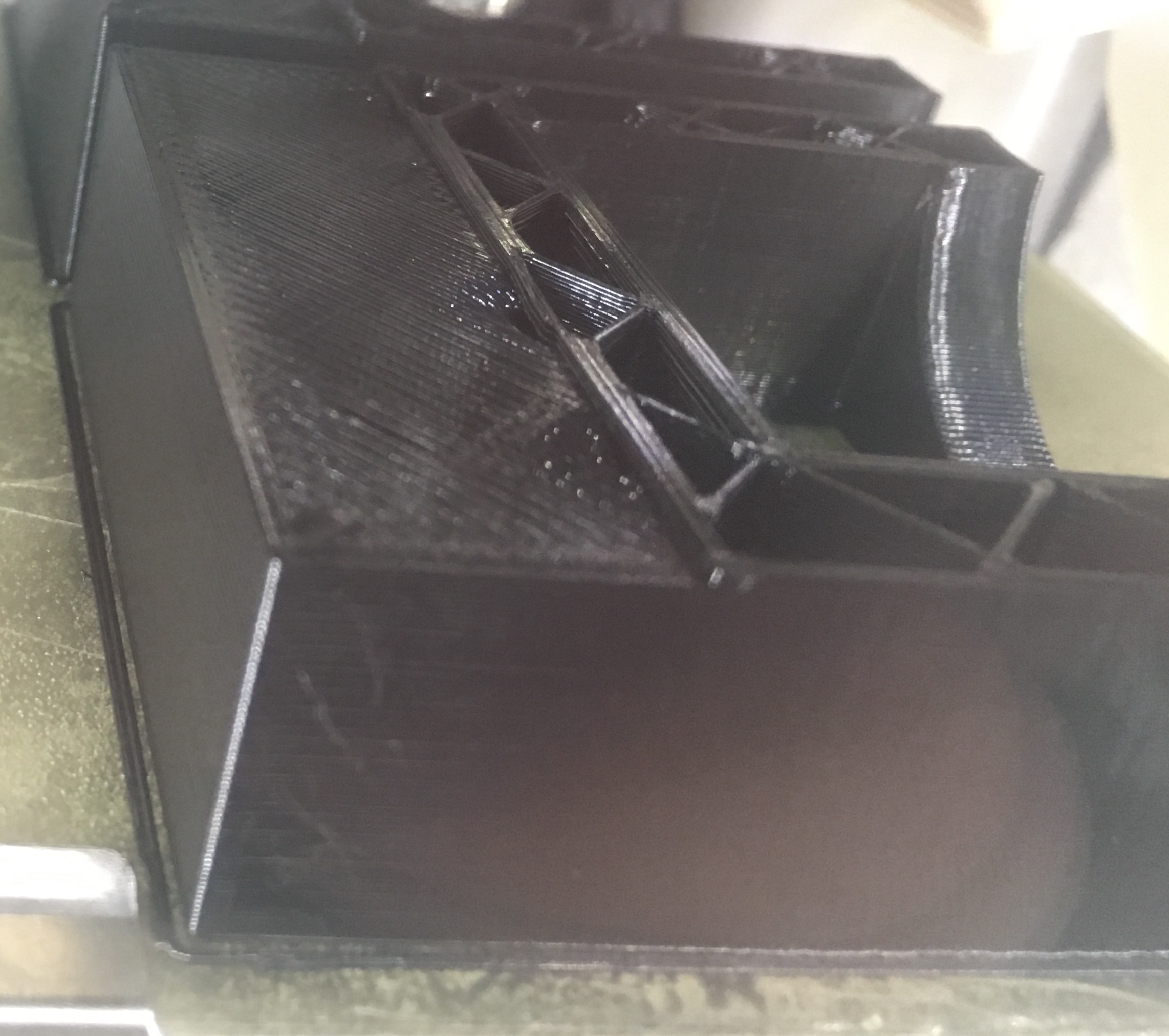

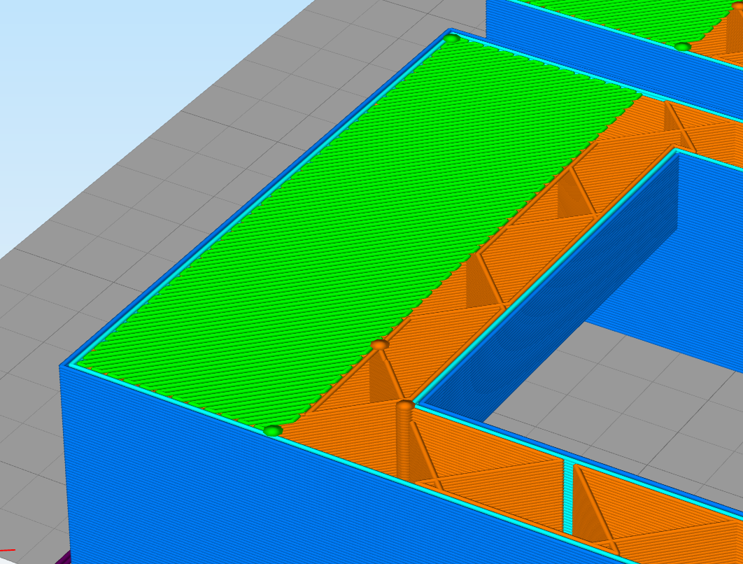

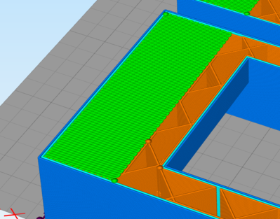

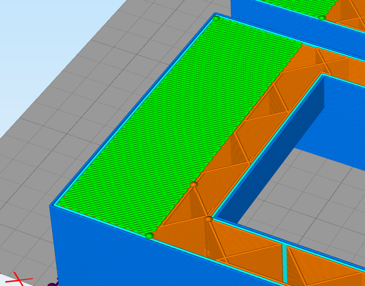

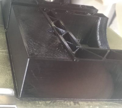

I complained about similar problems three years ago. It was improved in 3.x in some cases but the core problem remains.
I *know* there's ways the user can make that work, but I call those workarounds, it's asking the user to do tweak settings that I think could be a checkbox if not fixed automatically.
Honestly top layers should stitch over to the next support line from the layer below, if it's overhanging the layer below by a bead width or more. I know even a three year old version of Slic3r expands top layers for better results. Also, innermost perimeter bridges between infill lines when top layers should at least extend to the innermost perimeter and even to the infill line for the layer above.

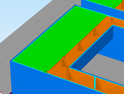

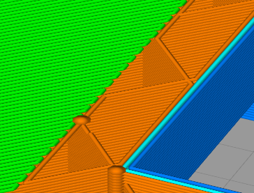

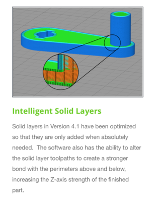

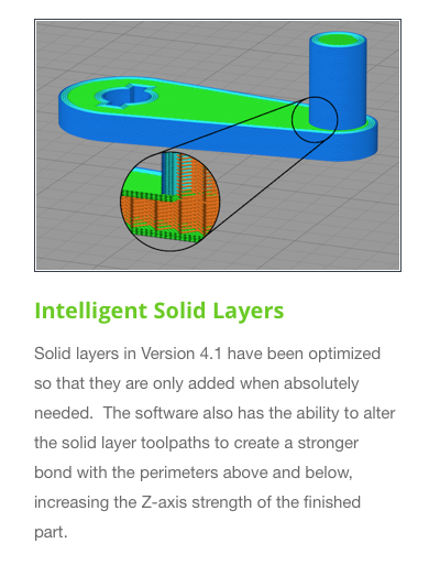

I can't tell what 4.1 improves in this regard when the feature update page says this has been improved. 4.1 seems to treat the top layer overhangs of this part the same way 4.0.1 does.

Thank you for all the great suggestions! The Intelligent Solid Layers update is a reference to the way perimeters and solid layers are joined in the Z-axis going forward. The Solid Layers will now extend to the width of ALL the perimeters to ensure a strong bond between these features making it a stronger part overall. The infill changes you suggested are definitely something we will consider for future releases!
