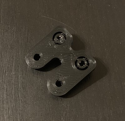

since 4.1 i got weird really big blobs on layer start after the retraction.
no problems here with 4.01.
S3D-Alex
Posts: 456
Re: retraction broken?
Can you please post a Factory File that exhibits this issue?
iZz0s
Joined: Sun Jul 30, 2017 12:00 pm
Im since today On vacation Till sunday but i can attach a picture where you See this Problem on the bottom layer.
Problem isnt present with the 4.01 Version and i havent changed Any settings, too.
