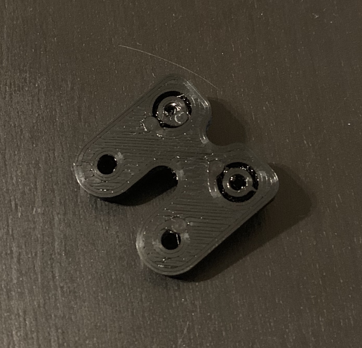

since 4.1 i got weird really big blobs on layer start after the retraction.
no problems here with 4.01.

Im since today On vacation Till sunday but i can attach a picture where you See this Problem on the bottom layer.
Problem isnt present with the 4.01 Version and i havent changed Any settings, too.
