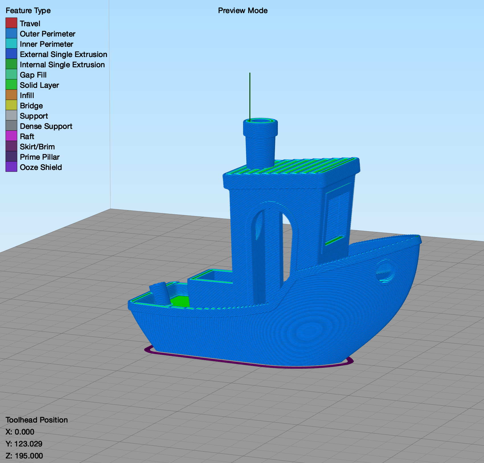

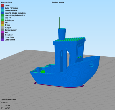

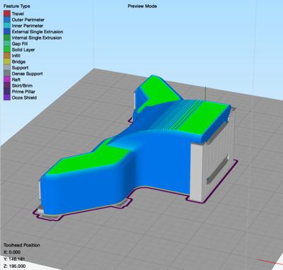

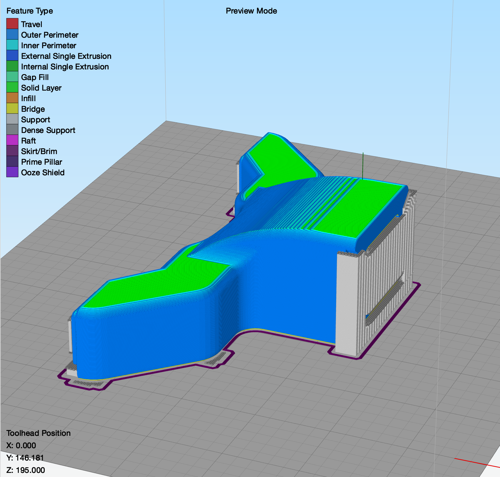

y3 sliced in 4.1.1
y3 sliced in 4.1.1
benchy sliced in 4.1.1
